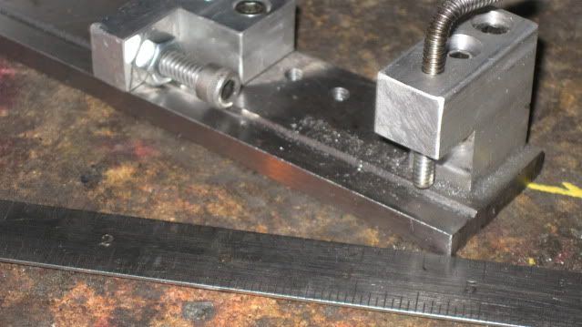

    • Hey all, I often need to drill a hole in some thin stock that doesn't require a lot of precision so I don't like to spend much time on the set up.
      *disclaimer* I use a small screwless vise almost exclusively so this may not be too useful to those with vises without vee grooves.
      Threaded rod, scrap strap and a couple of set screws that fit in the vee groove to prevent the clamp from pulling upward.
      Not a complex thing but for me it speeds up some operations and I hadn't seen anything similar in all the web surfing I've done.
      Thanks for looking,
      John

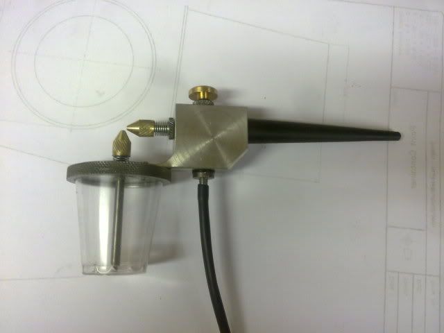

            Just wanted to show you all my latest project. It's an Air Brush tool, that I believe will come in handy in future projects in my home shop
            Here's the CAD:
            And the final result :
            Mogens Kilde
            http://m_kilde.skysite.dk/
            • Looks good. It will probably work as well as any manufactured unit. Now all you need to do is add a carousel to it, each color with its own siphon nozzle. You may not get as much paint in each cup, but it might open up an 'artistic avenue' for you. You'd have a virtually instant color change capability, and no nozzle cleaning between changes.

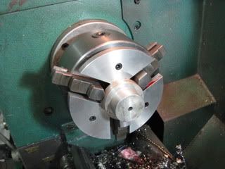

                  Because I suffer from dyslexia when it comes to numbers, I have to write everything down. I ordered a D1-6 backplate for my 5C collett set thru chuck. I should have oredred a D1-5. Returned the plate, looked up the dimensions and made this to punish myself for being dumb and it even works.

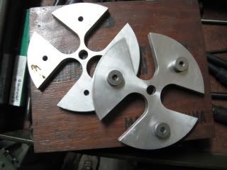

                      My version of the Royal chuck stops. Cut out of 6061 1/2" x 6" plate. Spaced out from the chuck face with SPACE BLOCKS.
                      Edit: I've faced them. Hopefully they won't warp as thin as I got them in some spots. I'll just have to keep an eye on them.

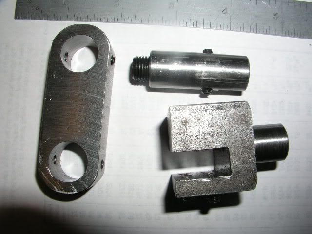

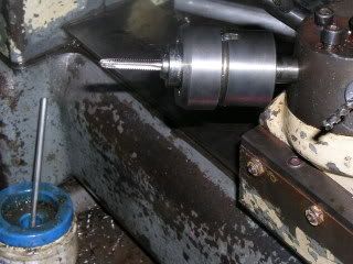

                      • A fixture for holding small rods, bolts, etc. for cut-off on a vertical saw.
                        A modular knee tool for my second op lathes. Sorry for the poor second pic. It shows it set up for spotting, facing & OD Chamfering in pull of the handle.

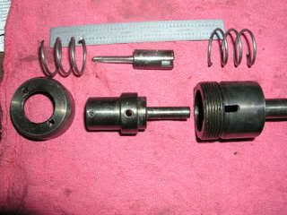

                        • A tapping tool for the second op lathes. I wasn't aware of the release & spin style of tools at the time so I made a compression style holder. Works fine as long as you are quick to plug the motor.

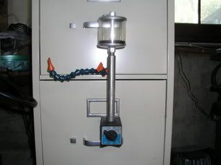

                          • Good ol' tapping guide
                            Drip-oiler for parting-off, knurling, etc.
