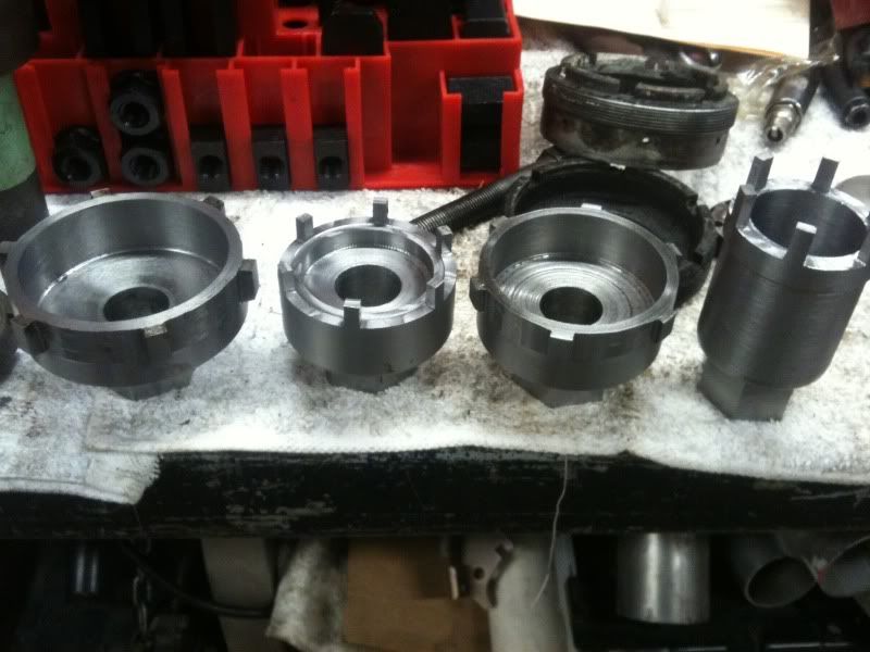

      • First project on my big boy mill. I've never used a rotary table before, nor had I ever done any real milling on steel.
        This is a hub service tool set for an old racecar a buddy of mine bought. These are made from 4140 and will be heat treated. Not perfect, but hey....you get what you pay for....which in this case, isn't much.

            Hey, that looks like a nice project and a lot of work. How long did it take you?
            Vitَria, Brazil
            • Took about 3 hours per piece. The millwork was quick, but my lathe is a piece of junk and I don't think I had the right inserts to deal with this stuff, so the turning and boring took forever.
              • hub tools
                lbhsbz you got no reason to feel bad about that job!nice work!

                • Those four pieces are a lot of work, a *real shop* (as in not home or hobby shop) quote on those four items would be north of a grand no doubt.
                  James Kilroy

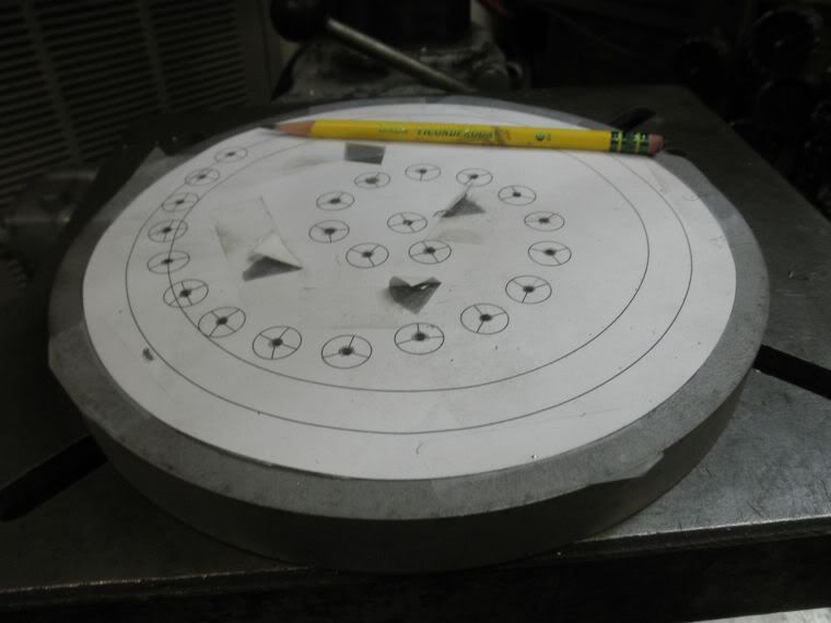

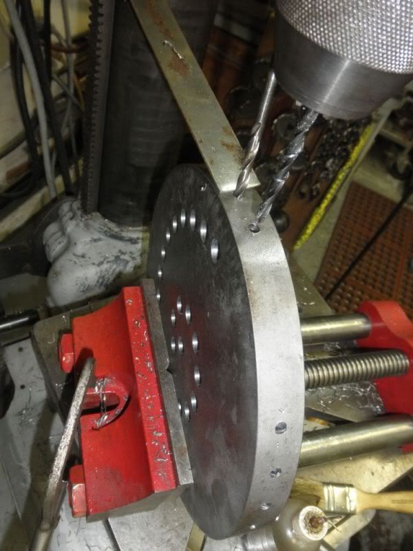

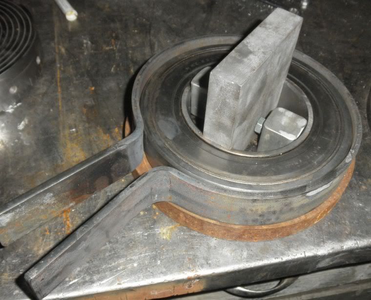

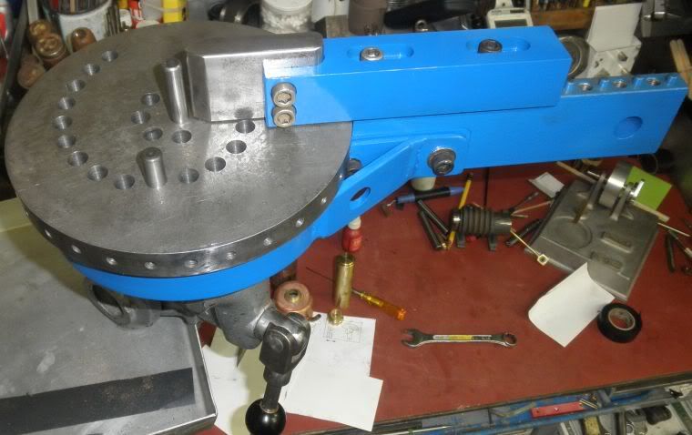

                      From the supply depot (junk pile) found a large 7 & half inch OD ball bearing and a 7/8” thick steel disk. Bent some ¼” by 1 and half flat bar to wrap around bearing using shop built Hosfield bender. Outer race will be the moveable part and the inner race will be bolted to top disk and clamped in vise.
                      Using CAD program drew out layout for ½” holes for ½” dowel pins, printed out and taped to plate for drilling out and reaming holes on drill press. Holes layed out so each one is .25" larger radius then previous row and .25" clearance space between holes.
                      Drilled and tapped rim with 3/8-16 holes for stops. Used incremental method of dividing. Drill hole, insert spare drill bit in hole and rotate work until it comes to stop. Determined distance between holes by "thal looks about right" method.
                      Bender mounted in vise. I know messy bench
                      • That's cool!

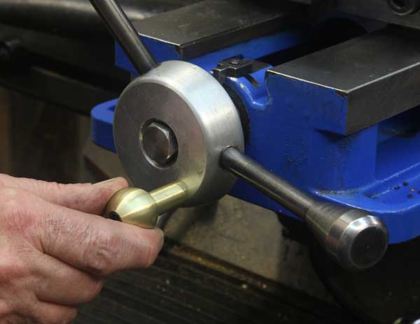

                          • Pretty much from the day I got my Kurt vise, I've used only the little three-pronged speed handle I got from Enco. It's faster by far than the regular handle, it stays on the vise, and I can crank it just as hard if I use two hands.
                            When I needed to crank the vise quickly and move the jaw a fair distance, I'd simply twirl the handle by sticking a finger against one of the rods up close to the center. But, my arthritis is bad enough these days that it's starting to hurt too much when I do that, so this morning I decided to fix the problem. I made up a little speed knob, reminiscent of the speed knob on Dad's 1954 Buick Roadmaster:
                            Works better and faster than the ol' forefinger, too.

                            • Originally posted by Frank Ford
                              Frank,
                              Pretty cool idea there. I have a speed handle like that but that is the first time I have seen one with a knob.
