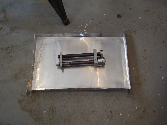

      I couldn't believe the claims of a sheet metal brake with no length limit. http://www.wuko.at/english/pdf/wukobenderfamily.pdf
      Turns out it's a crimper style bender that uses ball bearings. An afternoon in the shop and a waltz through the "inventory" and presto!
      Seems to work.

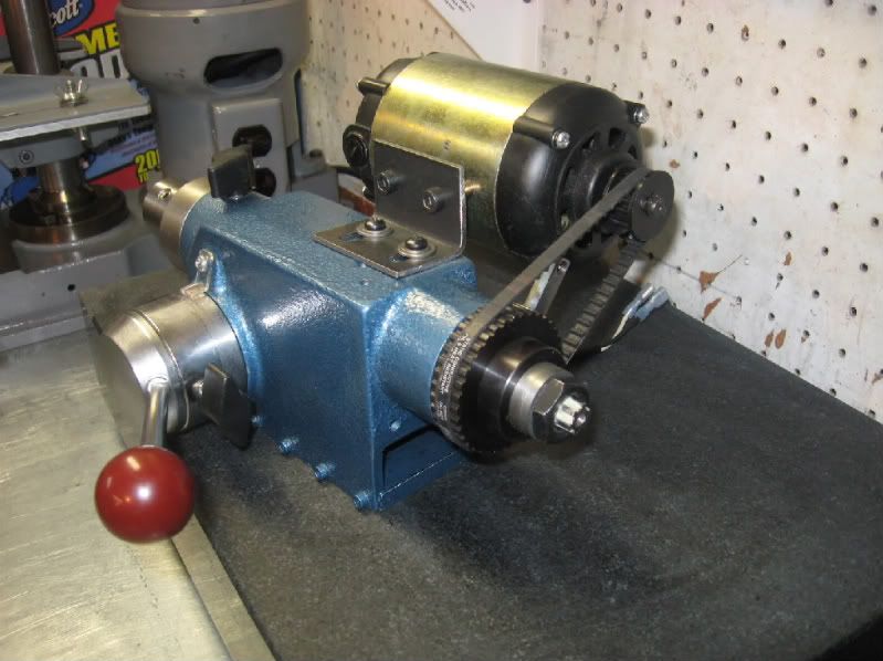

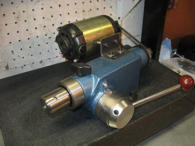

        I built this portable mill/drill head from a old drill press and mini lathe DC motor. Similar to Evans.
        I tossed the original mt2 spindle and machined a new spindle which accepts 3/8" shank tooling.
        It uses a variable speed DC drive, has 2.5" of quill travel and better bearings and works real well.
        Steve

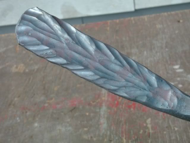

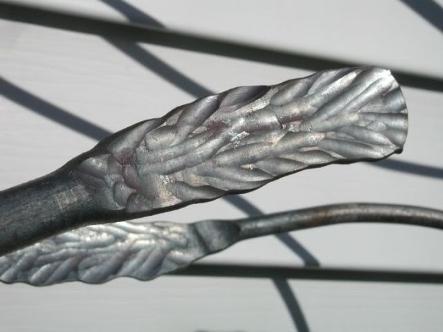

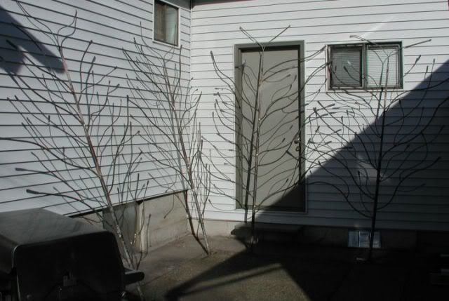

                Bob, I'm not sure what a sheetmetal notching machine is. The throat don't necessarily need to be deep. The hammer dies can be on an angle and usually are, so long work can miss the frame. Guessing your talking about the bigger hammer. This was build using the Kinyon plans as a starter and changed as found metal at the local scrap yard. Frame is 7/8" thick steel and base for the hammer die is 6" round shaft. Plans for the Coleman controls was figured out from looking at You Tube video's
                http://www.youtube.com/watch?v=vfnqb48fSiQ
                Small hammer is a Stuart Model and about the most it can do is crack walnuts.
                Only have used hammer for one project and that was making some trestles for a nephew. Half-inch hot roll was flattened on ends for some fake leaves and textured a little. Sections of pipe were drawn down for taper and welded together.

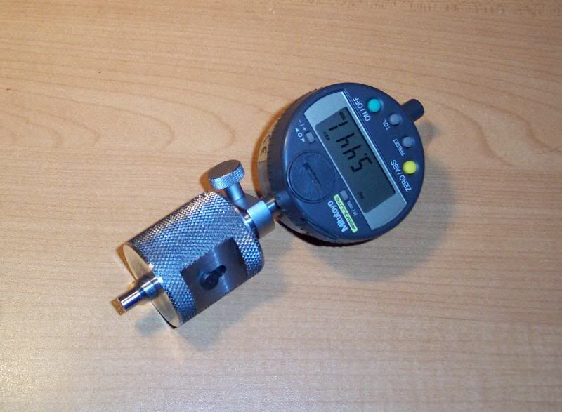

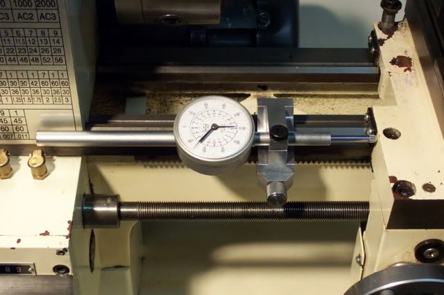

                        I liked the idea of the "Zero-Set" style indicator holder and thought it would be a fun project:

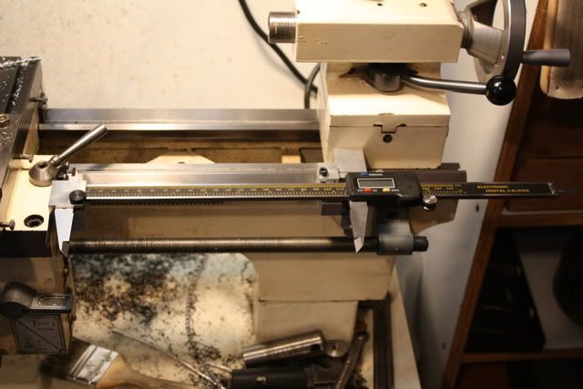

                        For my small lathe, I initially bought a set of Chinese 12" calipers to use as a 'poor man's' DRO. I wanted to make them fast and easy to install and remove so I came up with a cam-lock style mount for the way and a simple block mounted to the carriage and a thumbscrew to retain caliper.
                        I wasn't really happy with the calipers. The primary drawback is the slow rate that the display updates at. It forces me to slow the feed way down at the end of a pass so I don't accidentally pass the stop point before the display updates which is undesirable for a number of reasons. It's worth noting that both of my Mitutoyo's displays update faster than I can detect. Because of that, plus the ability to interpolate between divisions and judge the distance remaining until the end of the cut, I prefer using an analog dial indicator anytime the work is within it's range (2"). This is my take on a dial indicator holder for the lathe. It's based on the same cam-lock design I used for the caliper mount. Just snap it over the way and turn the knob to lock it in place. It only takes a couple of seconds to install and remove, yet it's rock solid:
                        Back when I was a machine operator, one of the parts I ran had a bunch of chamfers that had to be measured regularly. The majority were spec'd for depth rather than diameter. The quality department procedure described the use of the depth rod on a pair of calipers. This was not only clumsy and time consuming, it was not very accurate. I searched the internet for weeks looking for a gauge designed to measure depth, but only found gauges designed for diameter. So I designed this:
                        Measurements were far more accurate, repeatable and took a fraction of the time.

                            There are some hidden modes in those Chinese scales that can be selected via the data port. One of them is a fast update.
                            http://www.shumatech.com/support/chinese_scales.htm
