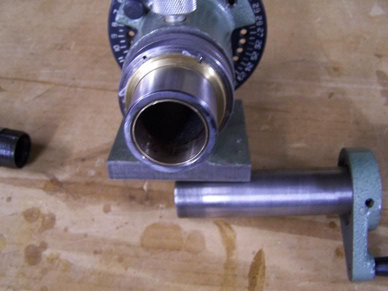

                        • This idea I picked up on another web site it was posted by Mr Glass, he was reluctant to post here so I picked up on the idea and thought I would share it. The idea is to take out the endplay that is common with these spin Jigs, as it is maintained by a ring with set screws that come loose. I also put a set screw in the outer ring to help lock it in place It makes these jigs much nicer to use.
                          A bushing was installed in the end to give it a better alinement.
                          A bushing with two lock rings installed over the barrel and held in place with roll pins. I used 20 tpi as the brass was a little stringy. I believe the original used a 32 tpi. I don't think that the size really matters as long as you can index on the face of the body.

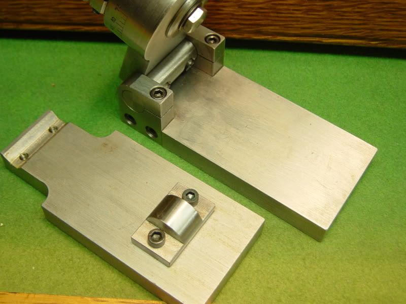

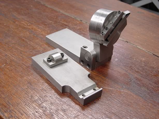

                            Here's a grinding fixture I made to grind precise angles on cutting tools, using a surface grinder.
                            Next to it is a 3" sine table that can be installed in place of the tool grinding head in a few seconds.

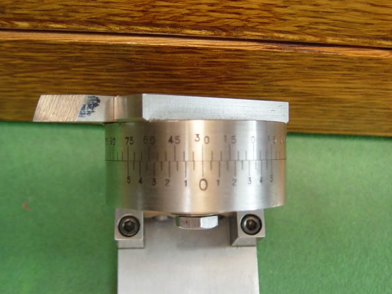

                            As shown in the photo below, I used vernier graduations for angles. The vernier reads to 1/2 degree, and it's pretty easy to estimate to 1/4 degree (such as 23-3/4 degrees for a British Association thread tool). I think the vernier is much easier to read than too-close-together marks at each degree would have been on a circle this small.
                            There are no graduations to set the table angle, but that's just the clearance angle and high precision usually isn't too important. I just use a protractor to set this angle.
                            Here's one more photo ...
                            Dave
                            Please pardon me if this is a dumb question, I'm brand new to machining and trying to learn all I can.
                            How did you create the numbers and hash marks on the vernier? It doesn't look like a label. Did you buy that or did you make it?
