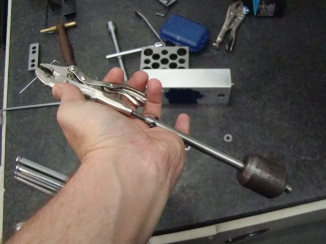

              • "I love that Vice-grip slide hammer. Simple but brilliant, thanks for sharing, I will unceremoniously now steal the idea"
                I first saw one twenty years ago, when a crew came in from Duncan Aviation, Lincoln NE to help me on an engine change.
                Like you, I shamelessly copied the tool, find it useful to this day. I'm surprised no one has marketed one. (to my knowledge, anyway)
                • Originally posted by noah katz
                  I'm not seeing it; what post#?
                  But let me guess - just weld the head of the vise grips adjuster screw on the back to the front of the slide hammer?
                  pretty much. I did away with the screw, but cut thread on the slide hammer itself. The guy I stole the idea from had welded the screw to the slide rod.
                  The next version on my list of things to make will have a welded bung on the back of larger grips, that's in line with the jaws. those small ones the jaws are pretty straight, but on the larger one I have now using cheap china, and not actual vise grips the jaws are at an angle to the screw, making them pretty much useless. Plus the fact that the pliers suck large. Note to self, when making a tool utilizing another tool, always start with a good tool. **** in, = **** out plus time wasted.
                  I'd love to make a set, of three different sizes of grips, and a large and smaller hammer that all interchange. but will probably never get around to it.
