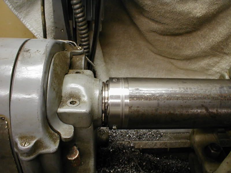

            • Large Bore Lathe
              Several years ago I had a project where I had to modify about 15, 2" OD conveyor rolls. Neither the lathe at work or the one I have at home has a headstock bore large enough to handle it. I set up the steady rest on the one at work and modified one roll as a prototype. What a pain in the rear. The thought of having to do 14 more had me thinking that there must be a better way. The project got canceled before I could think of something but the idea was still stuck in my head and would make a reappearence now and then. I had all sorts of hairbrained ideas but I got hit with the solution last December. Attach a self centering large bore chuck to a piece of pipe, drive it off the spindle and use a steady rest near the chuck. Plus, it would be a perfect winter project to keep me busy.
              The chuck is an 8" import, couldn't justify spending the $$$ on a Bison, with a 2 1/2" bore. The pipe is 3" SCH 40 about 12" long. The whole thing probably cost a bit over $200.
              It's not completely finished and I'll need to make a beefier steady rest, that will be next winters project, but I'm confident the idea will work when it's all done.

                Great Idea, You might also consider putting some brass tipped screws between the steady rest and the lathe for internal support of a shaft.

                  • This gets the award of the Day! For all you folks that do gunsmithing and the spindle bore isn't large enough, this would work on a tapered barrel.....Brilliant!
                    Now, put a cover on that switch plate before a nice long curly chip finds its way into it and lights you up like a Christmas tree.......and then we wouldn't get anymore cool ideas!.....

                    • This is also an old way of making accurate work on a lathe that has worn ways near the spindle.

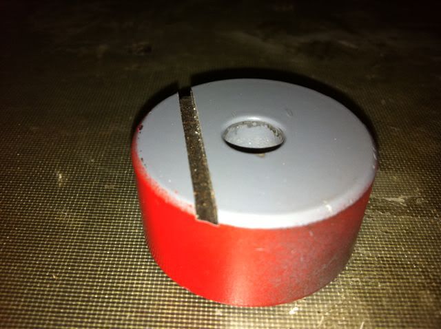

                        Cast iron boring bar, made out of scrap from a table leg I shortened. I was thinking on how to put a square slot in the end and mount a couple of set screws; then I looked in my box of tool bits and there was a broken tap that I saved after reading someone's tip here!
                        I cross drilled it to hold the tap and drilled and tapped the center for a set screw. (Ground the tap single point internal threads, can't forget that step.) I don't have any comparable boring bars, so I can't comment on the vibrations damping properties of cast iron. It's also the first time I got to use my boring bar holder.

                        • TS,
                          Very nice; first time I've seen that setup.
                          One question; why the use of a 4 jaw self centring chuck, rather than a 3 jaw? Just wondering.

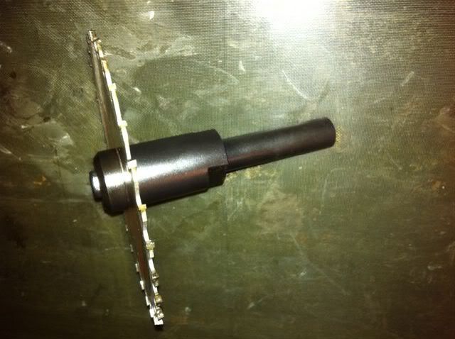

                          • The scariest tool I have ever made.
                            After seeing (can't remember where ) Someone surgesting to cutting pieces out of a old Circular saw blade to make cheap part off blades, I thought hey why not use the entire blade.
                            I have no fondness of circular saw but this worked out better than I thought.
                            I would love to have a slit saw and I can make my own arbour but the blades in South Africa are like $130 (I converted since nobody want to lookup the ZAR)
                            Circular saw blade on the other hand is about $5 hence.
                            I ran it at 125 RPM on Leaded steel and it came out pretty well.
                            I did not want to push the brassed tungstan bits to much at it will jump off but on the size off the blade I should be able to run at 400rpm max.
                            It makes bit of a noise but cuts a nice smooth 2.5mm wide slit.
                            The only downside is it makes a V shaped bottom since it is a framing and ripping blade.
                            I have to say during time first run I looked like this and I did not unpucker for a few hours.

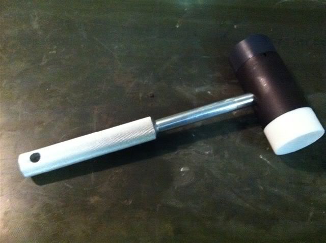

                            • Thor's Rattle
                              After seeying the Paulding hammer (It's a piece of Art) http://toolguyd.com/2010/01/preview-...ulding-hammer/
                              My hart started going all warm and fuzzy ,so I decide to make my own.
                              Not a piece of Art
                              How does it go ...whatever is worth doing is worth over doing.
                              The shaft is salvaged Alu that I knurnled and shrink fit to the head (I real hope it holds) If my post just stop in the near future it means the head came loose and killed me.
                              The head is 2kg of hardened 4140 with 3 holes inside for deadblow weights.
                              I hot blackend the head. The only snag was I wanted to use a Alu and Nylon face but only had Nylatron GSM.
                              I really wanted to finish this and had some scrap virgin teflon lying around so now I have a gsm and ptfe head.
                              Soft head , no recoil and loosens everything it touch.... I'm one happy camper.

                                So I can turn square stock as well as round if needed. I thought about a 3 jaw but figured why limit myself.
