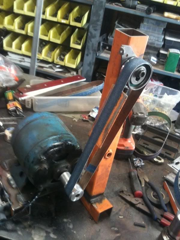

                • Home made belt grinder/deburr...er....made out of a harbor freight engine stand that I didn't trust to hold up a big block. Btw...the Chinese put the weld seam in a corner on their square tubing....so don't use it for anything that matters.
                  Uses 1x30" belts, top pulley is a timing belt tensioner bearing from a Toyota camry, motor is. 1750rpm 1/4 HP drill press motor....I'd like itfaster but it gets the job done.
                  • what did you do to keep it tracking right ? did you crown the pulleys?

                      • Originally posted by jack3140
                        Yes, the bottom pulley is barrel shaped
                        • Originally posted by lbhsbz
                          thanks i plan to build one very handy tool to have
