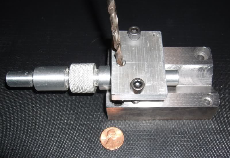

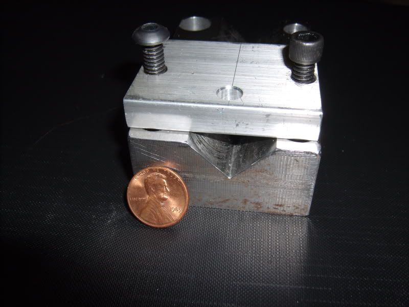

                        • Originally posted by Frank Ford
                          Cross drilling fixture with replaceable drill bushings to handle rods feom 1/4" to 2-1/2" diameter:
                          I had been contemplating a way to drill a hole in the center of a pipe and had a similar idea, but this inspired me to put it into action. There is hardly a need for the word "precision" in here, but for what it is, it works. If I'd have had more time and stock, I'd have made some bushings for various sized drills.
                          In case you're wondering why it's off center, I haven't decided how deep I wanted the vee, so there is room to expand on the other side. As it is, it holds nothing smaller than 1/2". The vee is 90 degrees and I only ground the top and bottom because the sides are likely to be dinged up by vise jaws or something. The counterbored holes are for screwing directly into my worktable. They are clearance for 1/4-20 sockethead capscrews. One is a bit larger than the rest because I found a smaller endmill after the first was sunk. Oops haha.
