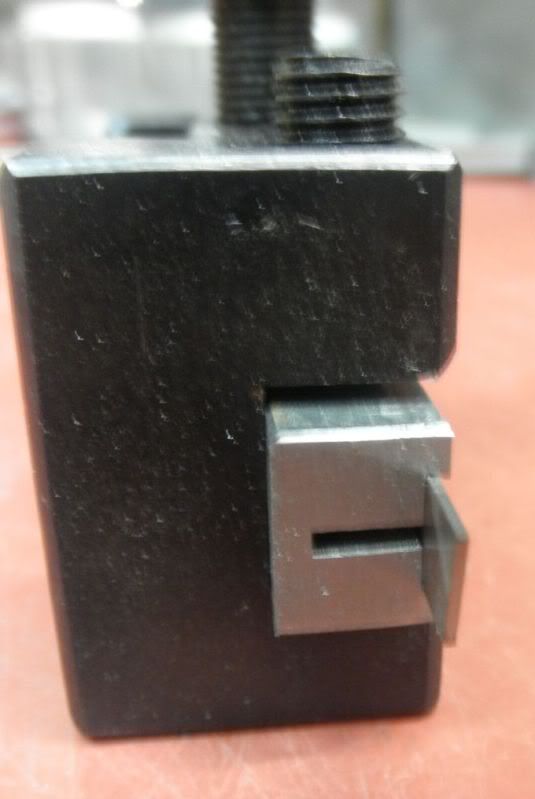

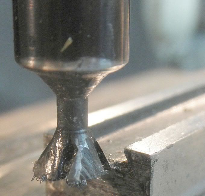

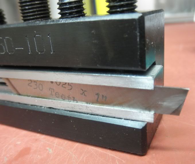

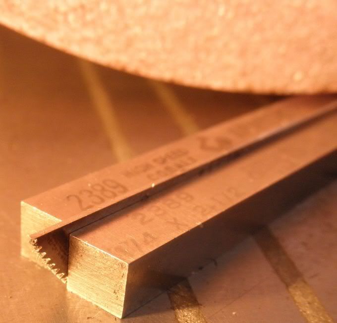

            • Making a parting blade and holder.
              Had hunk of broken high speed steel slitting saw blade, which was .025” thick. Rough ground on belt grinder so sides were kind of parallel. Placed on edge between 2 quarter inch square lathe bits and at about 45 degrees on magnetic chuck and surface ground the top and bottom of blade parallel. There was no problem with the blade moving between the lathe bits. Maybe this isn't a safe method but it worked with no problem for me.
              Milled a slot down length of some square stock. Using a dovetail cutter, made earlier this year for making couple cannon models, and made a few passes to get good sliding fit of parting blade in dovetail slot.
              Using a slitting saw made a cut down middle of groove for some give when clamping.
              • That clamping method is fantastic Gary.
