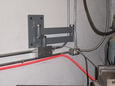

                  • Vise Caddy
                    I had thought of making a vise caddy ever since the first time I saw one in an SPI catalog many years ago. But how to mount it? To the column dovetail like the commercial unit? How about the overarm dovetail? Maybe the turret bolts? They all had downsides in complexity or loss of table travel. I could never make a decision before losing interest for another year. Eventually it dawned on me, just mount it on the wall! So I gave my forehead a V8 slap and made this. I wish I'd thought of it years ago.
                    Of course, most of the time it's parked against the wall, empty. I should make an accessory tool tray to fit it, or at least a cup holder.
                    • That is one slick idea Randy. I've never seen one like that before. I also like the idea of an accessory tool tray. The arm closest to the vise would make a great support for a rack of R8s, chucks ect. One could just pull it over when needed and tuck it away when done. Very, very cool !!!
                      • I would like a shelf about 1/4 to 3/4 below so as if it starts to slip it will not fall or move very far. The holding the entire weight of the vice by the jaws bothers me especially if they start to slip.
                        Graeme H.
                        • Originally posted by GRH
                          Graeme H.
                          The trick to cure that problem is to have small protrusions on the face of the bar that you clamp onto. The studs match the holes for the screws that hold the fixed jaw on. It does not need to be much to totally negate any slippage.
                          Dan
                          Location: SF East Bay.
                          • If the vise hasn't let a workpiece go during a heavy cut it ain't gonna fall of the arm!! Sometimes things get a bit over-thunk! lol
                            jmho
                            al
                            Edit: and vice versa (pun intended) If it drops off the arm you should put a garbage can under it instead of a shelf! lol
                            The Fixer
                            I spent most of my money on women and booze, the rest I just wasted.
