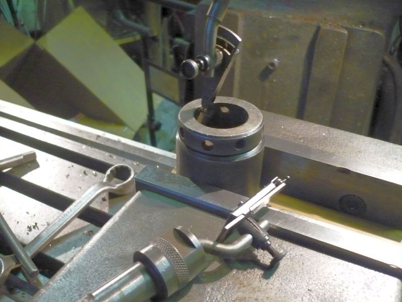

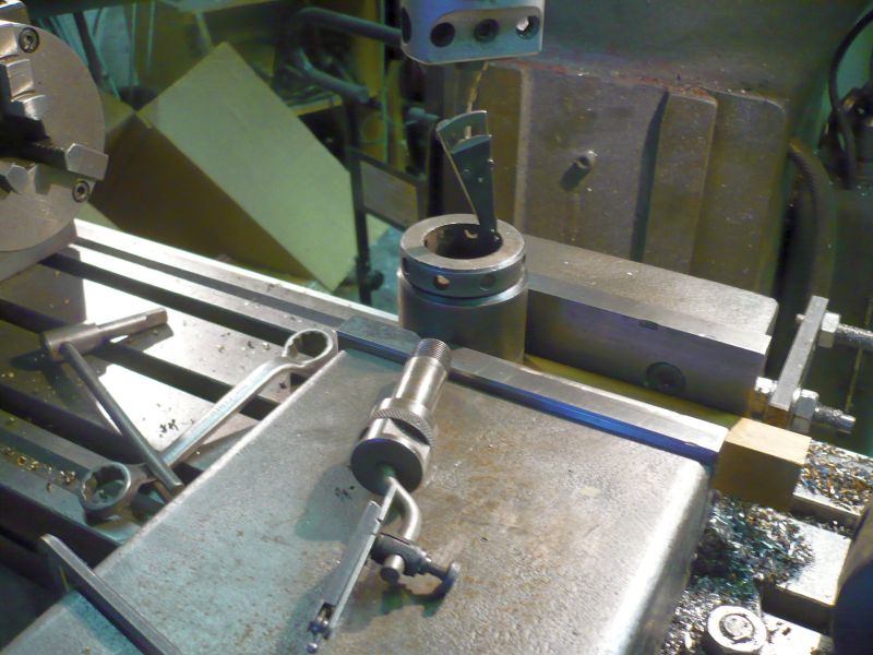

                              • Setting a boring head up on centre
                                Simple jig to set a boring head up on centre and then swap over to the boring tool. Saves loads of time as it relies on the same setup as the tool needs so no need to use co-axial indicators DRO's etc Next two pics are staged shot centring up on a screw jack as it was handy
                                Two more or less identical pieces in the picture, one is fitted to the boring head and the one on the vise is made to fit a screw in Clarkson collet.
                                The idea is that the bar is dog-legged so the stylus is on the centreline of the boring head.
                                The indicator is one made my Verdict but they seem to have disappeared these days. All apprentices had to buy these and they were stopped out of your wages, they cost something like 30 shillings at the time. They have a read span of 20 thou and being skeletal you can read these from any angle.
                                Shot from 'tother side showing the pointer still at mid scale, in the first pic it's hard to see the pointer.
                                Couple of wipes round whilst adjusting the handles then replace the bent link with the boring bar and jobs a good un.
