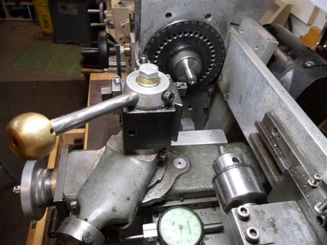

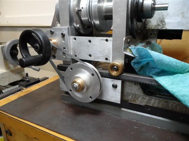

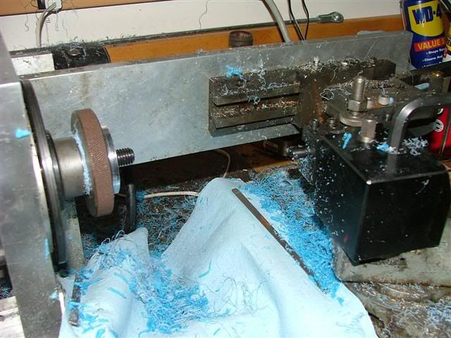

                  • I don't know if this qualifies as being scratch built but this small lathe was cobbled together from a number of parts 20 some years ago.
                    The rotating part of the head stock is from an import 5c collet spin fixture. The OD of this part happens to match a metric ball bearing (210 I believe). The DC motor and controller are from a defunct bearing tester from work as is the main machine slide. The cross compound is from an unknown lathe and I machined dovetails into a piece of cast iron for it to slide on. A piece of rack gearing is attached to the main machine slide and the black hand wheel on the left lower side turns a pinion gear engaged in the rack. I have since substituted a cog belt speed reduction for the black hand wheel to give better control. The tail stock is unorthodox, utilizing another smaller machine slide that was also cast off at work. The Aloris quick change tool holder is overkill for this little machine but it was also a cast off from work.
                    There are a heap of things that fly in the face of making a good lathe, the excess use of aluminum for one. It is surprisingly rigid and for small parts it does a good job for me. The variable speed is quite nice and it was a real luxury 20 plus years ago.
                    Sorry for the messy look, I was facing off 3 inch diameter pieces of UHMW plastic as part of a little machining job I had. I think I took the picture to document my setup.

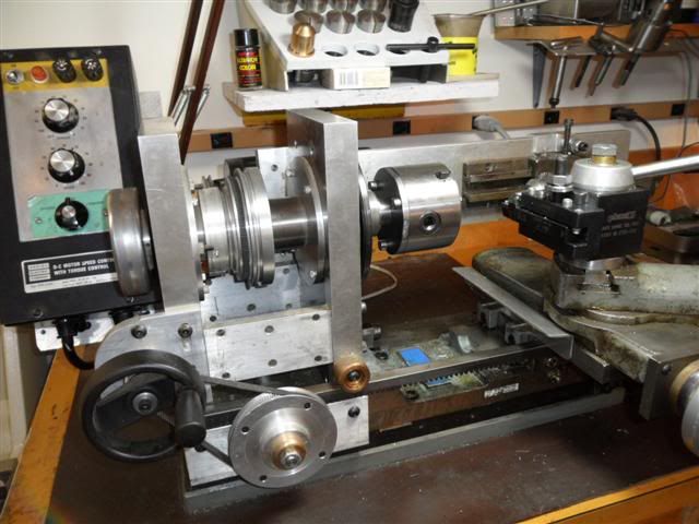

                          I removed some of the swarf and took a few more pictures last night. You can see the upgrade (speed reduction) for the carriage traverse. The lathe is a bit less than 30 inches in length. I am guessing it weighs around 150 lbs. The motor is 1/4 hp and depending on which set of sheaves you pick, the spindle will rotate 2-3 thousand RPMs. Just the ticket if you are working on a small scale steam engine. If I tried to run my old 10" Atlas at that rate I think it would have thrown a rod, which was my motivation to make this lathe.
