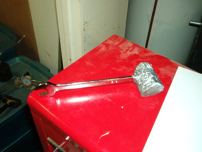

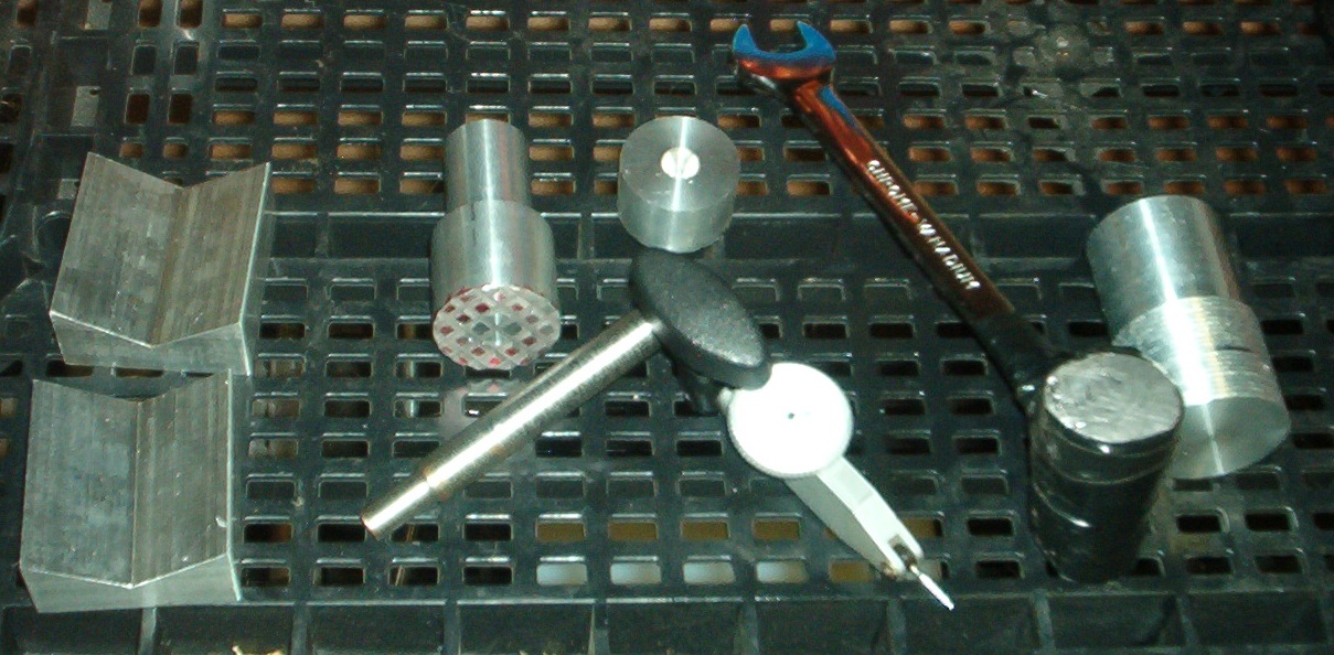

                    • just to prove im not all talk lol
                      My own super quick and dirty lead drawbar hammer, cast over a 5/8" wrench.. using tinfoil as the mold.. used two lead fishing weights (big mistake) to pour it.. the second one took a long time to heat up to melting point so theres sorta a crack down the center of it.. its staying togethor though. Most of the tinfoil peeled off but some stuck to the lead lol. The hammer head makes a GREAT handle for the drawbar wrench part since I can sorta 'swing' on the hammer head part. And the open wrench prevents me ever forgetting the drawbar wrench, since it simpley will not stay on.
                      If anyone repeats this, id say its great, just make sure to use one large weight (heating it up with a torch and letting it freely drip into the mold works however! But preheating into a small pot and pouring it in likey works better)

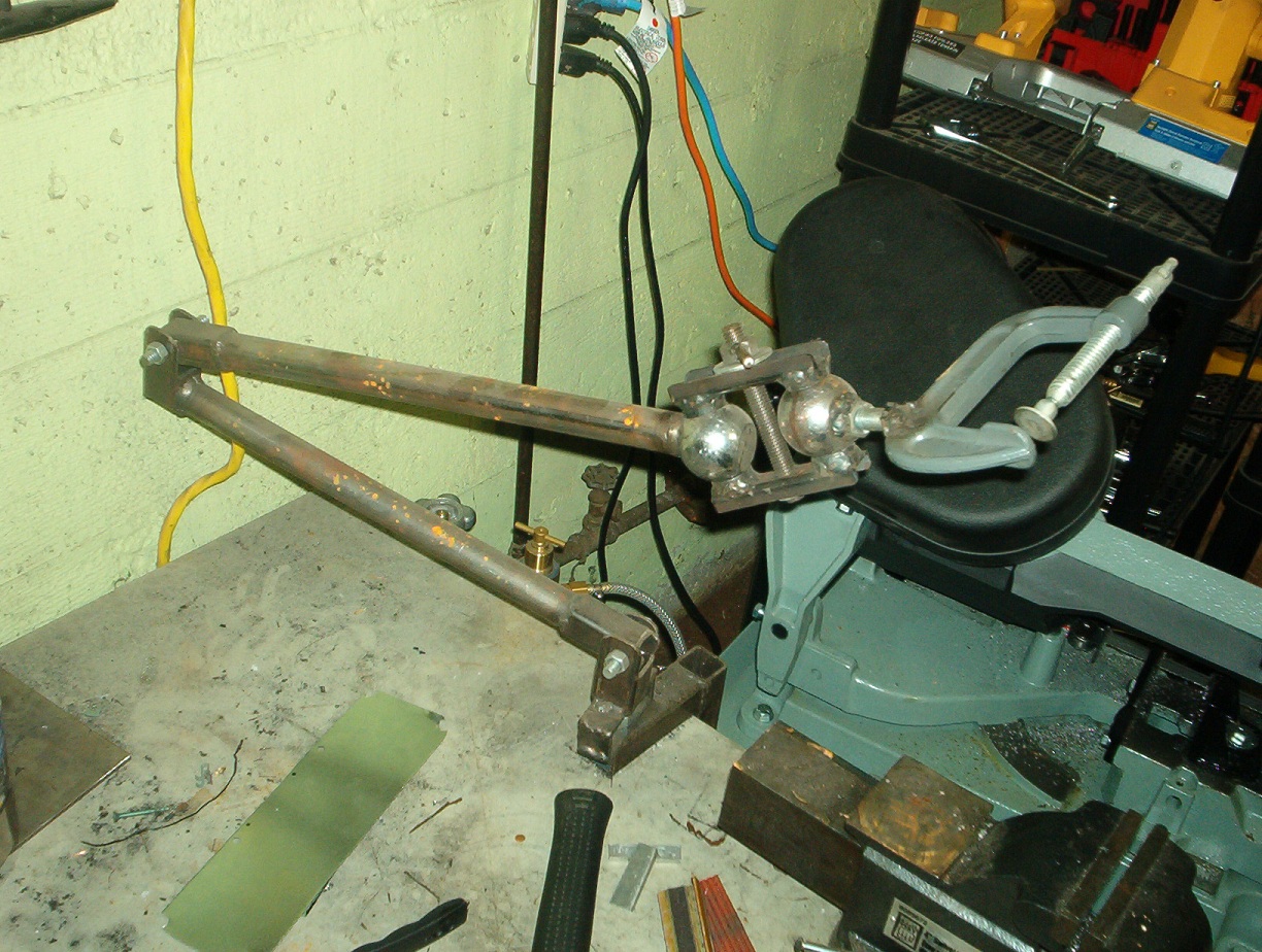

                      ROBOARM! well not quite, but good for welding setup, can hold 10~lbs easily when not extended to far. Built long before I had a mill or lathe, just using a drill/drill press and welder! the balls for the joint are trailer hitch balls, and the 'cups' for the balls are just tubing that I cut 3/8" lengths off of and welded onto a peice of square tubing I cut into 2 lengths of C channel (Could'nt find C channel of the size I wanted so I made my own)
                      Little things! from left to right:
                      aluminum V blocks, one of my first mill projects, done entirely with side milling!
                      Shaft that goes 3/8" then 1/2" for the majority of the length, then to whatever diamiter was needed to fit my test dial indicator clamp. slap it in the mill in a 3/8" collet or 1/2" collet or drill chuck and I can tram the mill or locate holes/bores, etc.
                      Above that is a cool aluminum 'jaw' device I made, I grab it in my 4 jaw chuck (the ledge prevents it from receeding into the chuck without having to clamp down super hard)
                      the other one next to it has a similar face, and on the backside (showing) with a center hole drilled in it for sliping over my live center
                      Usage is to clamp a plate (In this jobs case, UHMW) beween the headstock and tailstock without marring the plate (ok it KINDA mars the plate if you take too deep of a cut and the plate stalls but the headstock keeps spining)
                      so that you can turn the OD of a plate. I used it to make some 1/2" thick UHMW drink coasters. :P

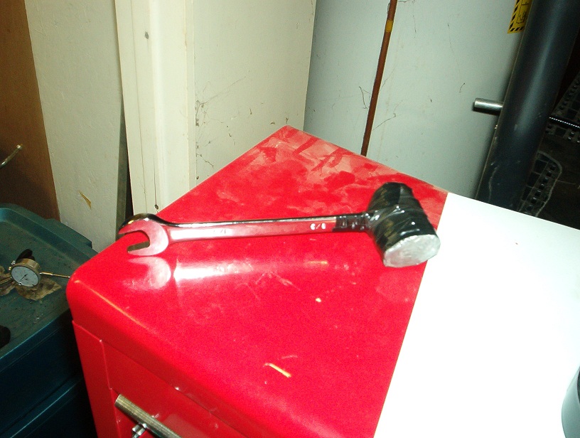

                      Next is yet another photo of my drawbar hammer. And then an aluminum test plug for the thread I needed to turn for my headstock, since I did'nt wanna ruin my workpeice trying to learn the exact dimentions of the thread I needed to turn.

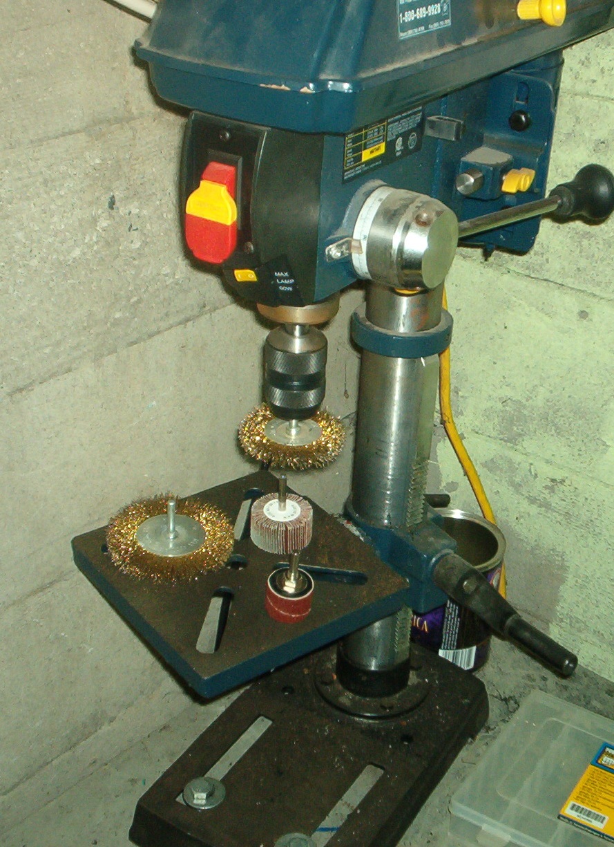

                      • New uses for my old drill press. Great for cleaning small items with the wire wheel, like sissors/shears of debrie etc. the wire brush at a few hundred rpms is very forgiving if you slip and rub your finger against it. and very good at removing paint when cranked to a few 1000rpm. (just using it freehand, but holding the work insted of holding the drill)

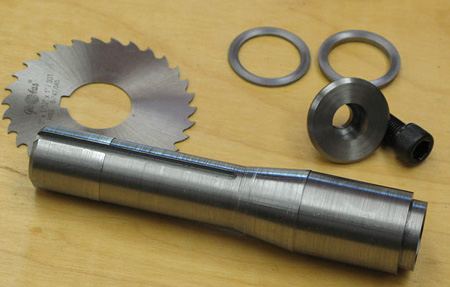

                        • A hex collet for my little Rambold turret lathe:

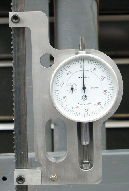

                          Band saw tension gauge:

                          A nearly-flush-cut R8 slitting saw arbor:

                          • What method did you use for the hex hole in the collet?
