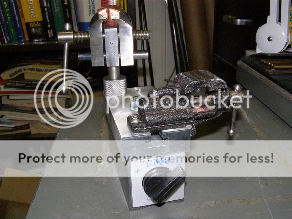

            • I won a large Noga magnetic base on Ebay. I made a bolt-on accessory base for the top and now I have a small magnetic vise farm.

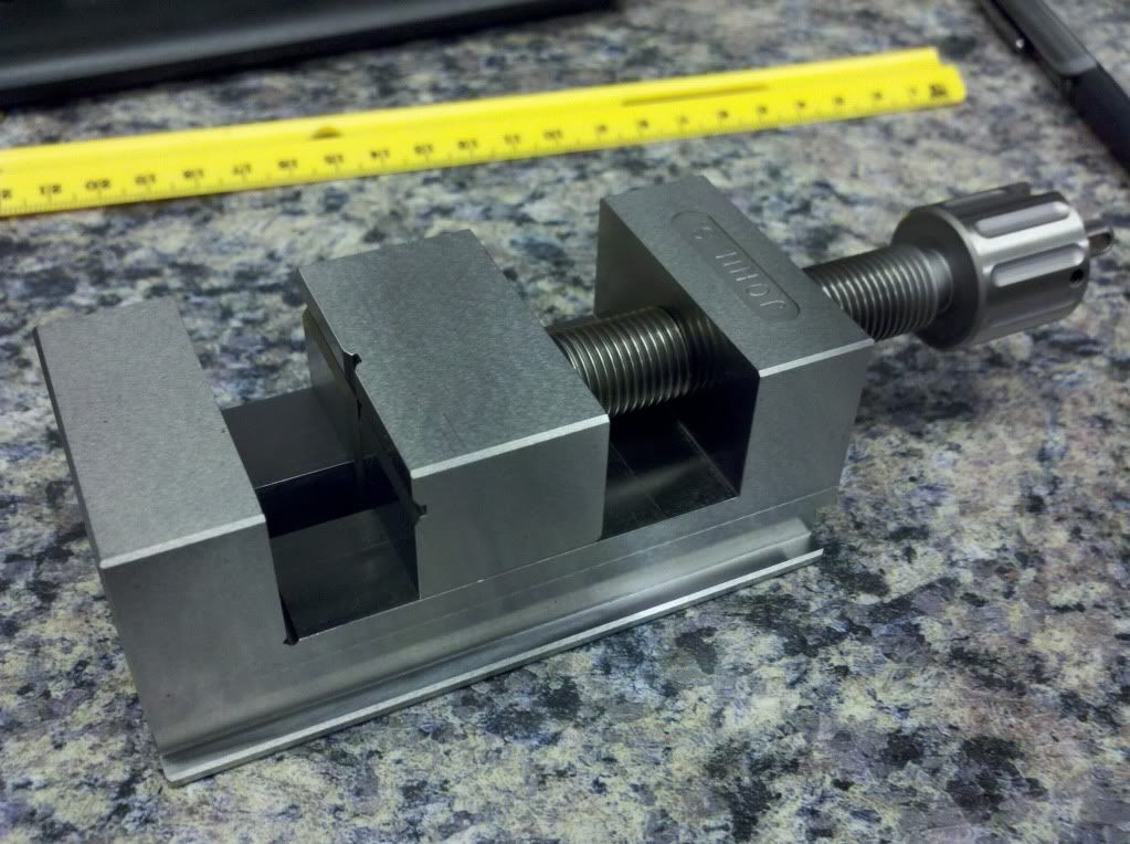

              • Here's a small tool vise I made. I think it is S7 if I remember correctly. It has a throat depth of about 1.75".

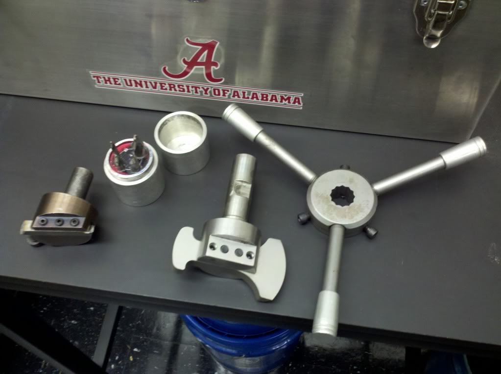

                  • Here are some other tools I found digging around this morning. Some of these are just handy for things, others were just little projects.
                    To the left is a fly cutter. It has about a 2" body. The body is tool steel of some sort, but untreated. I stuck in the oven at around 700 degrees I think to get the cool purple patina.
                    The next is a center drill holder. It is basically an aluminum body with an alluminum cap. it is supposed to house 5 center drills, 1-5. I didn't have a #1 at the time, so the #1 hole is still marked but has never been drilled, ha.
                    next over is a cutter I made for our CNC mill, to cut a large radius. That didn't work, by the way..it didn't do anything but a whole lot of chattering..
                    and last is a speed handle for a kurt vise. Works good when you have a lot of parts to take in and out of the vise. It has a 12 point socket on the inside which was turned to fit in the hole bored in the hub, and it is held by set screws. The three bolts on the outside tighten to the vise screw to hold the handle in place.
