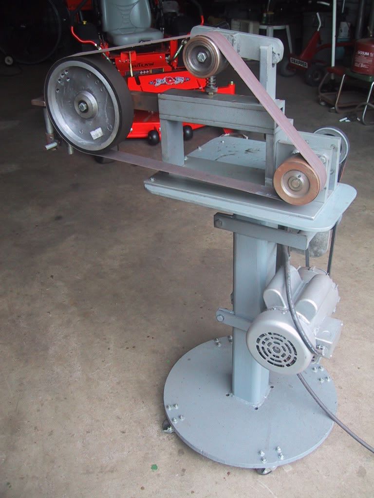

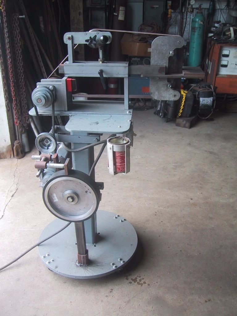

              • 2x72 belt grinder

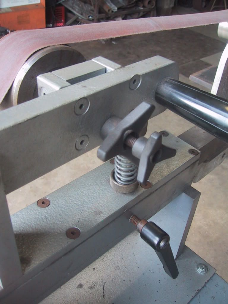

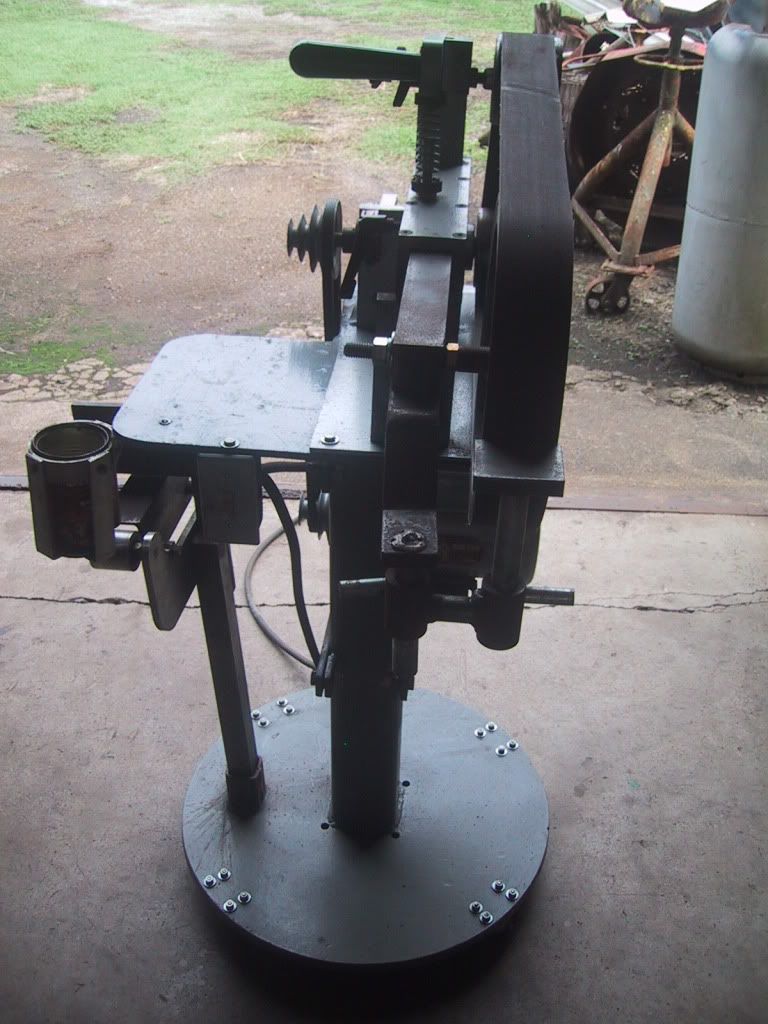

                Here is a belt grinder I built from blueprints on a knife making board. My grinder differs in it has a 3 cone pulley step system with 2 belts. Everyone wants a variable speed motor and it eats up a K when you get through with it. This was less than 50 bucks and you can change from very very slow for polishing to super fast for stock removal in 12 to 15 seconds. Almost infinite speed control. Never had a problem getting the proper speed for the task at hand. I bought the 12 inch rubber wheel and the bearings everything else I built. I built it for knifes but now use it for everything. Don't know how I lived without. I can get links to blueprints if the mods allow it.[IMG]
                • Nice Job
                  Nice job on the belt grinder. It looks similar, yet not exactly, to the "Moby-Dick" belt grinder that a fellow built on a 4x4 forum, he put some you-tube videos up.
                  Yours looks good and if you can put up a link to the plans or ??, I sure lots here will appreciate it.
                  Dennis
                  • Real nice job swordfish, thanks for posting the great pics!!
                    Got pics of any other projects?? We just all love pics!!
                    • Below are links to to org kmg grinders as well as plans to build your own. North coast knives has a 10 inch wheel that can be modified to fit this grinder and is easier to deal with than Grizzle. Beaumont metal works is the original and surprisingly will help you any way he can to build your own grinder. He will sell you any part that is beyond your capability to produce. A really nice guy. I have pics I cannot find, mabe at work. I will try to post later.
                      http://i106.photobucket.com/albums/m...d/IMG_0447.jpg
                      http://www.beaumontmetalworks.com/
                      http://www.dfoggknives.com/PDF/GrinderPlans.pdf
                      http://www.northcoastknives.com/nort...PowerTools.htm
                      • Excellent work swordfish! Were there any problems getting it to track well after it was finished?

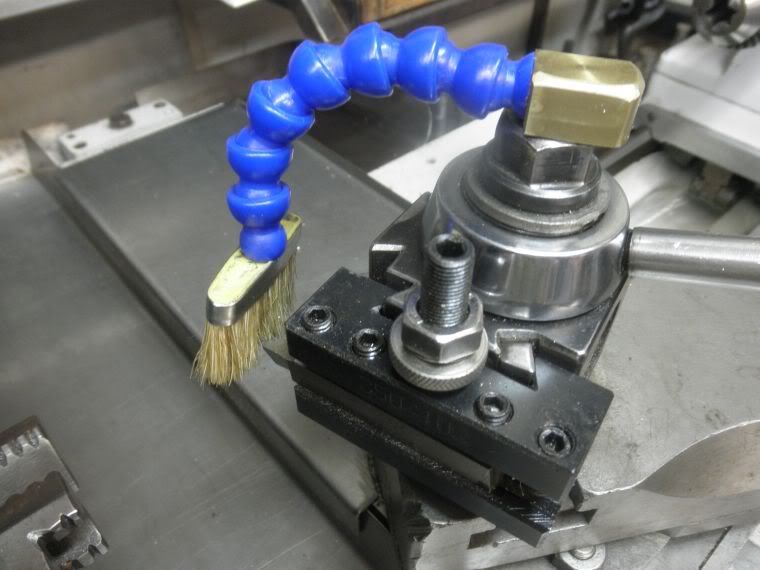

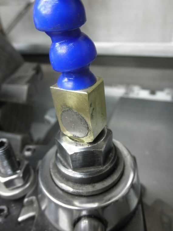

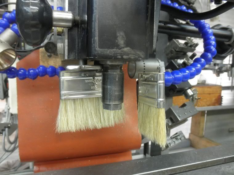

                              • Chip brush on plastic flexible coolant line (like Loc-line) for helping to control flying chips on mini mill.
                                Magnet on one end of "Loc-Line"
                                Works good on lathe toolpost for ease of using and getting out of the way. Works good for turning and parting brass/bronze where the little chips fly afar.
                                Steel wire brush needed for hot chips, cheap hair brush don't stand up to hot chips.
