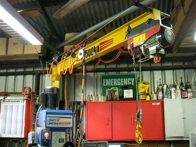

    I am not sure this counts as a tool, but it's for lifting things on and off the mill and lathe.
    Dave
    • Dave how was the 500 kg load limit determined?
      • Between the books I have here and online info it is designed to take 1000kg, but because I only fitted a 500kg hoist I went with 500kg load rating stickers. The heaviest thing I will be lifting would be around 100-150kg.
        I have lifted my 12 x 36 lathe with a block a tackle on the crane instead of the electric winch, it weighs around 450-500kg and there where no strange noises or movement.
        After I did my calculations I compared the beam sizes etc to what is available on commercially made cranes, and there are some bolt together ones getting sold with longer spans ratted at 1000kg with this size beam/hinge spacing etc.
        Here is the full right up with detailed pictures of the hinges etc
        http://www.woodworkforums.com/f65/ho...photos-113771/
