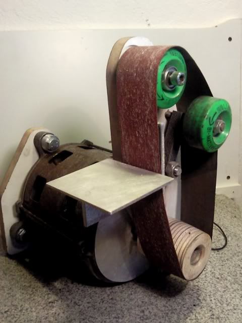

  • I didn't want to overflow the thread but as you requested for more shop made stuff
    A little belt sander made out of roller skate wheels and washing machine motor:
    and another wash machine motor converted in buffing machine:

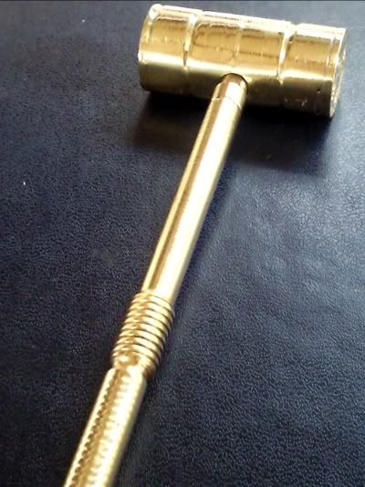

    It looks crude...and it is... but it got the job done.
    Here it is the brass hammer I made the machine for:
    • Love it! I keep hearing people warn against trying to use those motors. Were they old appliances or something?
      Proud machining permanoob since September 2010
      • Thanks, I don't remember which washing machine I removed it from but I assume they should be 10 years old. The only trouble I got was to find how to wire it. I 'm lucky the motors are the same so I hadn't to struggle one more time. These motors are not very powerful but they are silent and do not overheat.

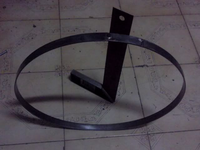

        ring roller MK1: just hit it !
        I made both of the carter with
        ring roller MK2
        Yes... these are roller wheels and yes...it works,one meter of a 2mm flat bar rolled in no time
        Sorry for the blurry pictures

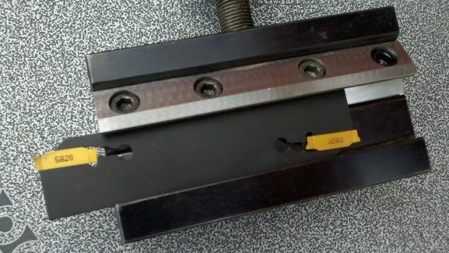

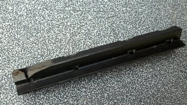

              • Not really my project
                I had bought a Dorian #7-71C parting blade holder off of Ebay and got it for a great price because it had a damaged clamping bar. The lowest price I could find for a replacement was $38.41 plus shipping.
                Since my dad has plenty of time on his hands and needs time in the shop away from Mother, I showed him the problem and told him "I'll make one myself as soon as I have time." That's his queue to get going on making one himself.
                A few hours later, it's all done and assembled:
                The new family photo:
                Nice work, Dad. Thanks!

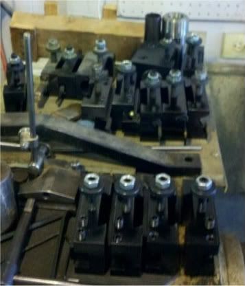

                The project he was working on today (which I helped with a little bit) is to make a wall-mounted rack for above and behind the lathe. Right now, there's at least 15 CA-size QCTP holder blocks sitting on top of the spindle housing of the lathe. Just too crowded now, and I anticipate getting a few more as time goes by. I'll post photos of that finished project soon. Here's the mess as it is now:

                • I'm still using a modified Sandvik adapter block. When the weather cools off, I think I may try to fit one of those into my to-do list. Never would have thought to do that wedge lever type locking bar.
                  Russ
                  Master Floor Sweeper
                  • Originally posted by BadDog
                    Nor would I.
                    It's all right from Dorian. I just can't figure out how the previous owner managed to mash the original part so badly.
                    • nice work on the holder......

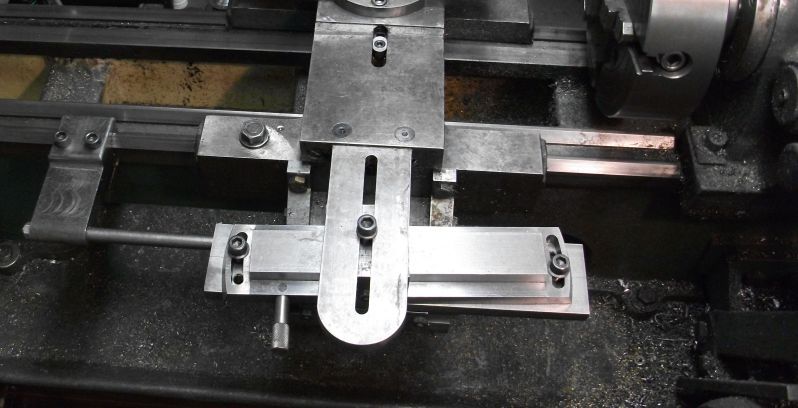

                              • Taper attachment
                                I built this for my Jet 1024. I rarely use it, but it was a good project, and it looks nice. (The spot next to the adjustment knob is an epoxy patch resulting from a mid-build design change.)
