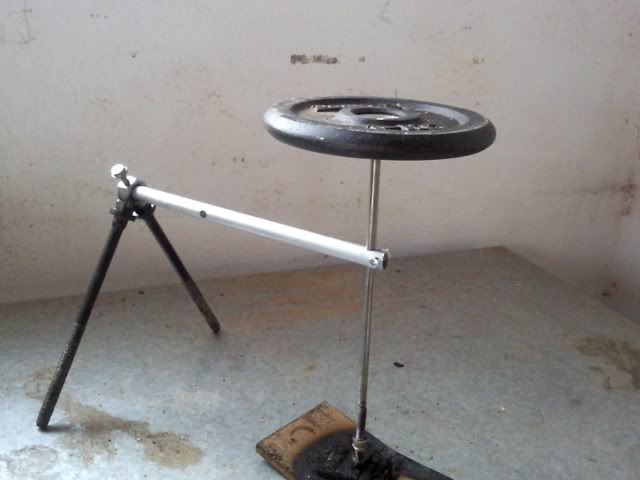

          • I got inspired by this third hand welding:
            http://bbs.homeshopmachinist.net/sho...ght=third+hand
            After using an improvised version I made one with scrap laying around. That's a great helper. Thanks for the tip

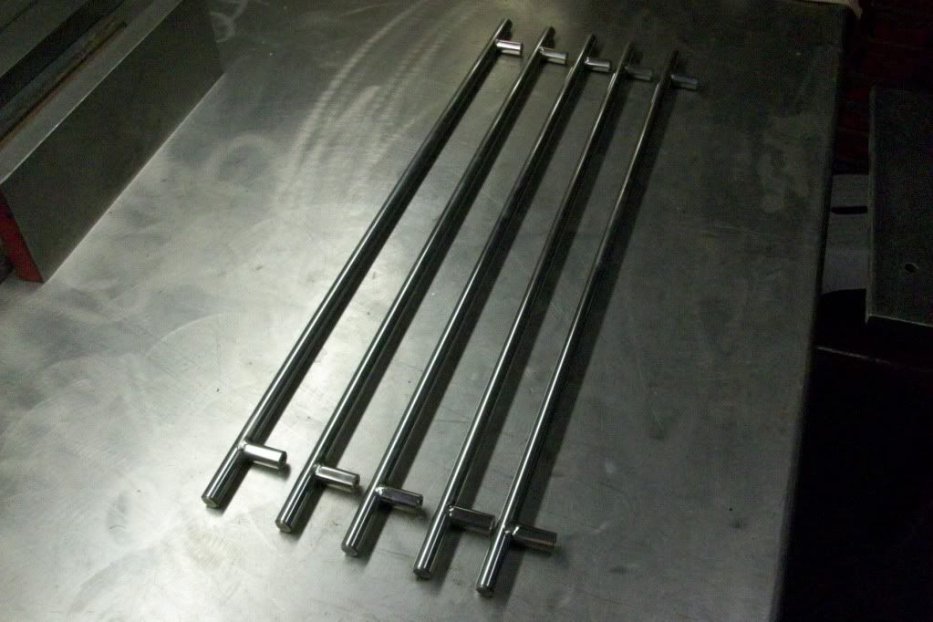

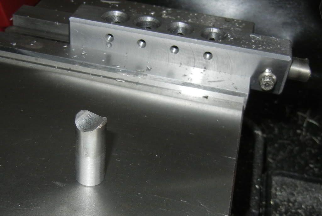

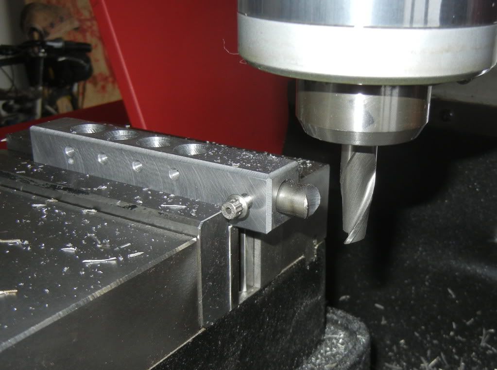

                      • Handles and Jig to Fabricate them
                        Had many of these to make and decided to jig up to do so the photos should be self explanatory.
                        • Comment
                          • Originally posted by hammerfest
                            Excellent job. Did you weld or silver braze them or???

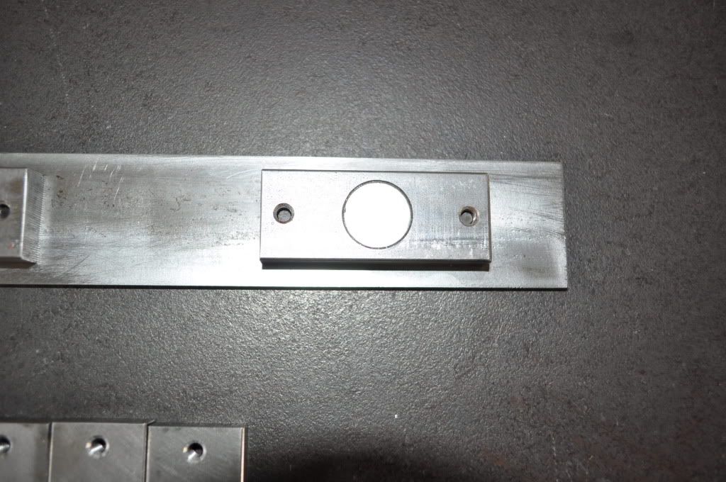

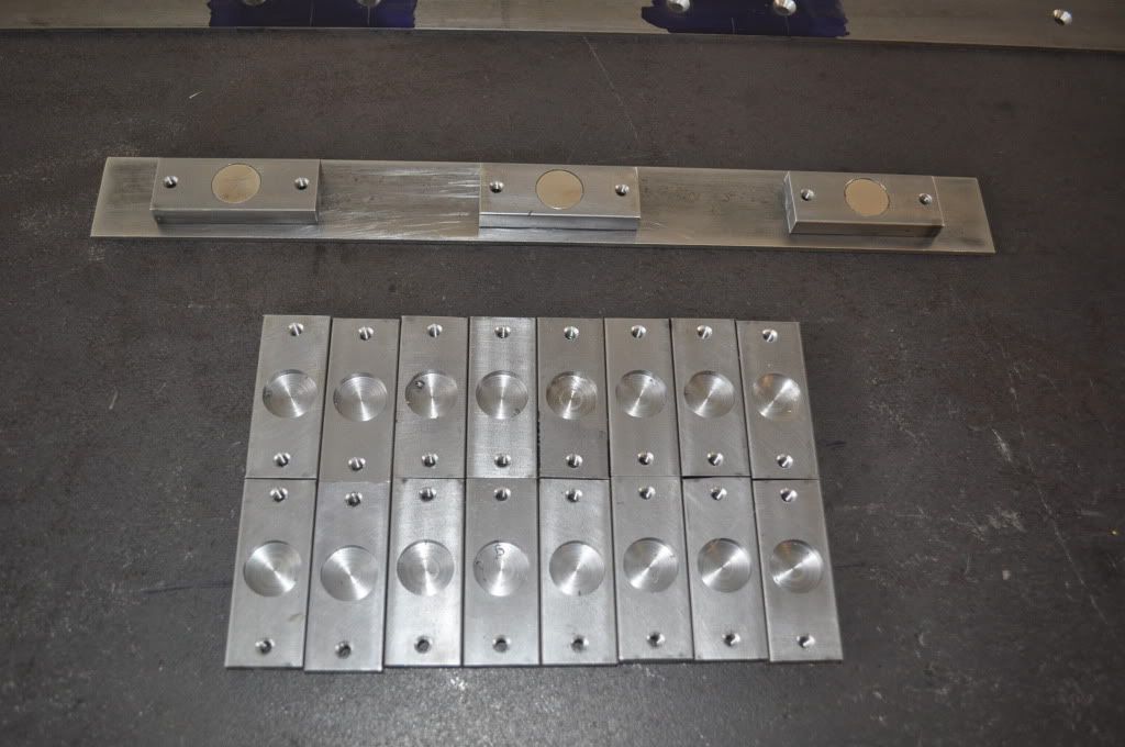

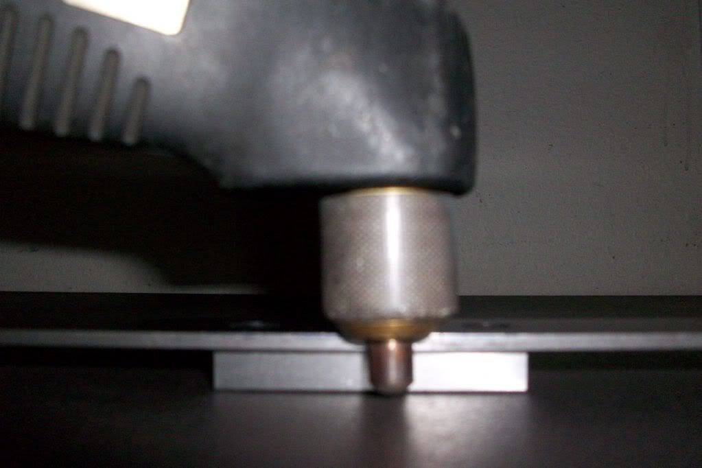

                            • Magnetic Plasma Cutting Guides--No Clamps Req'd
                              Can't say this is my idea but sure put it to good use. You can drop these in the middle of plate or sheet goods and whip down the edge. Made them in different lengths.
                              Rare Earth Magnet 3/4" dia holds these babies down tight but not tight enough that you can't pull them off by hand. They were a slight press fit into the holder.
