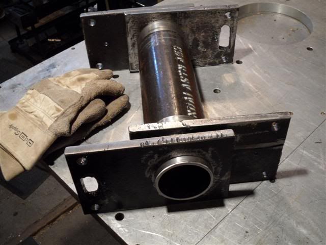

                      While not exactly a tool, more of an enhancement to a tool (my little bulldozer), the following 2 pictures are of a center pivot I am fabricating for the dozer blade. I intend to make angle adjustments of the dozer blade possible while I stay in the seat when I have to plow snow this winter.
                      The material is a 12" length of 3.5" OD schedule 40 pipe and a 14" chunk of 3" outside diameter tubing. I had to take ~.060" off of the 3" tubing and clean up the inside of the 3.5" pipe to get things to fit together. I need to split the plates and weld on the clamp devices so I can secure the pipe and tubing in their respective plates.
                      It is probably a little difficult to picture how this will all work but the left hand plates in the top picture bolt onto the top and bottom of a 12" wide x 30" long piece of channel iron that the bulldozer blade is currently attached to by 1" od pins. The plates on the right side will be attached to the dozer blade itself. I need to attach all of this onto the little bulldozer tractor so I can determine the lengths of the toggle links on each side. A smart man would have modeled this with a 3D software package in virtual reality but I decided I would 3D model it in physical reality
                      I will post more pictures when I get it mounted on the tractor.
                      gordon

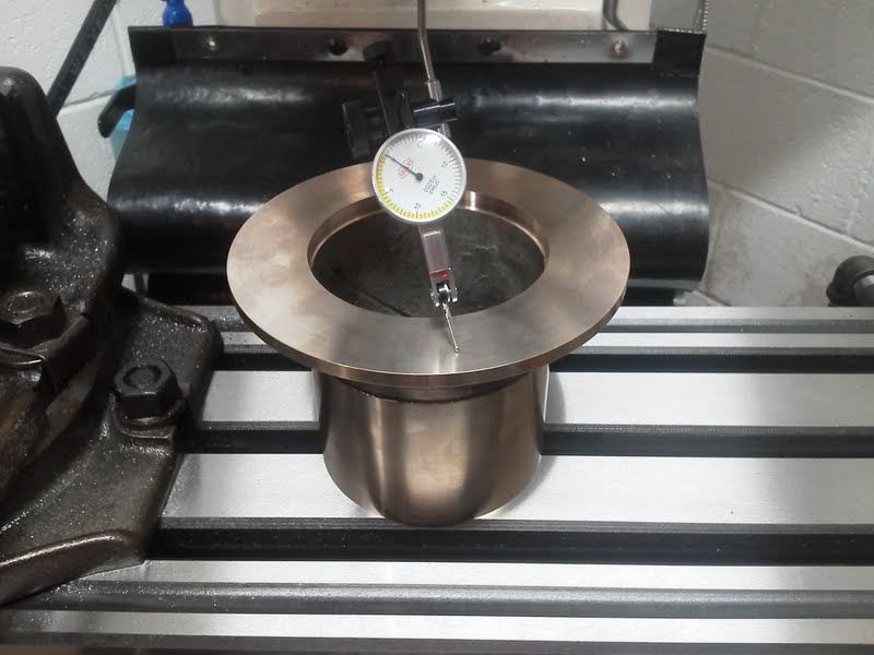

                          • My dad and I recently got a PM 14/40 lathe and 949 mill. The last time I ran a lathe was in high school, 20 years ago, and the only milling since then has been very limited stuff on an Atlas tabletop model over the past couple years. Just getting the machines to do anything is wonderful and fun for us.
                            We were trying to square the head on the mill recently and was pretty sure the dial was getting knocked out of position when it hit the T slots on the table. Then I remembered having this bushing from a Manitowoc crane laying in the scrap pile. A couple hours of turning on the lathe (which was great experience for dad who'd never run one in his life!) and we have this, which I hope will get us going in the right direction.
                            Since getting this far we haven't had time to get back on to squaring the head. I told dad we may shorten it so it's not as high, and also finish boring the center to completely clean it up.
                            Craig
                            • Outer ring from a big ball or roller bearing works pretty well too.
