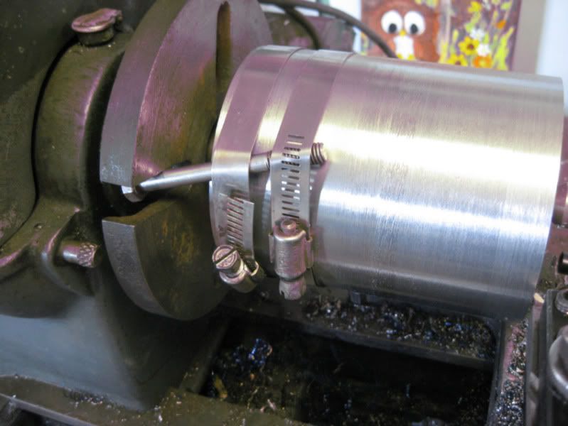

                • K.I.S.S. or Whatever it takes to get it done
                  i needed to true up this 5" diameter hunk between centers on my 13" atlas/craftsman. i have no dogs big enuf to drive it so. . . this is what i ended up using. worked great. . . it slipped a bit until it found its sweet spot, then just did what it was suppose to do.

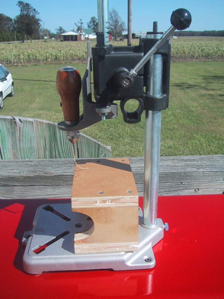

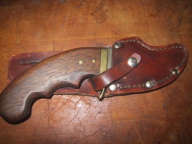

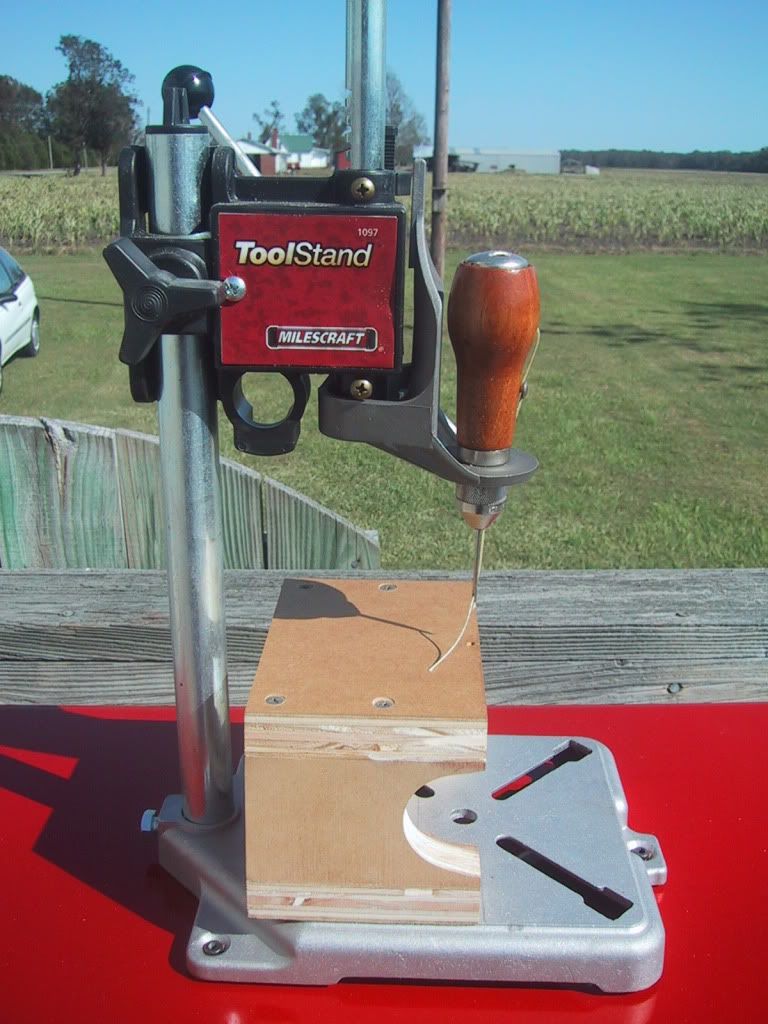

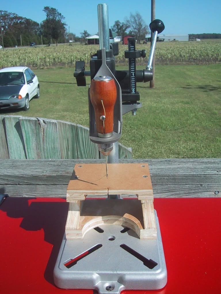

                    • Sewing Awl
                      Anyone ever not cursed a sewing awl? I came up with this to sew heavy leather for knife sheaths. The dremil drill press is about 25 dollarish on amazon and from the way the awl is designed after the first time it is installed and tightened it is set and adjusted. May require less than a minute of file fitting and you are ready to sew.
                      • Originally posted by davidh
                        I gotta admit that my first reaction to this photo was... "What the f**K!"
                        But hey, it's field expedience!
                        Chris
                          On somthing like that Id have drilled and tapped a 3/8nc hole in one of the faces (if a hole was allowable) then stuck a screw in it which fits into one of the slots on the faceplate. I used to do a lot of cylindrical grinding and thats how we were able to do things that needed the ends concentric with the shaft diameter/length such as a cylindrical square.
                          if a hole was not allowed in the end then that is a good idea ill remember it for the next time i am doing somthing like that
                          • It worked that is what counts.
                            I have used a muffler clamp with a bolt sticking out of the face plate a few times.
