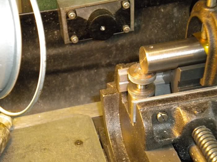

                                This set of screw jacks are from plans in Model Engineer Workshop. I added the locking ring to keep the height set.
                                Here is one fo the screw jacks in use:

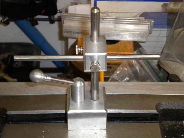

                                This is a workstop that I made. I know that they are cheap to buy, but it was a fun project.

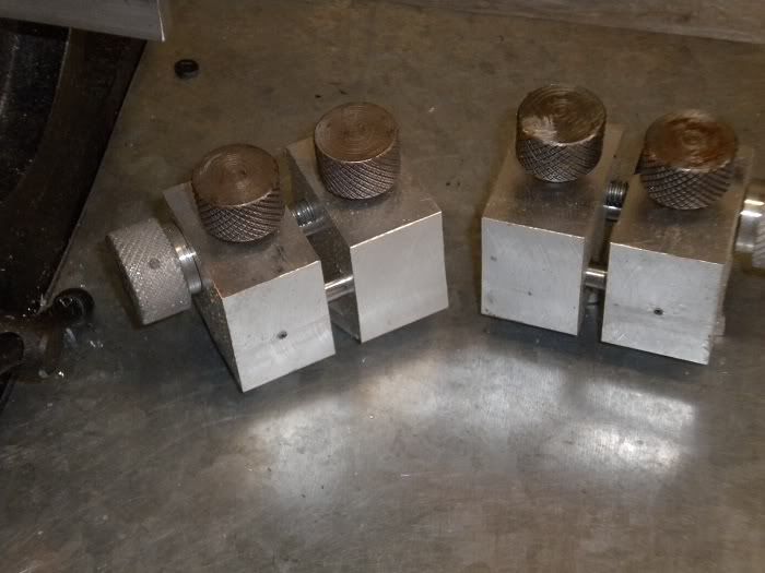

                                Fed up with the lousy table stops that came with my mill and table feed, I made these more substantial and adjustable ones:
