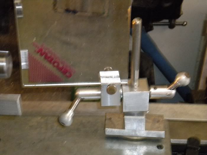

    I built this stand to support a mirror so I could see the backside of projects when I have to cut on the back (blind) side. Love those computer hard drive magnets.

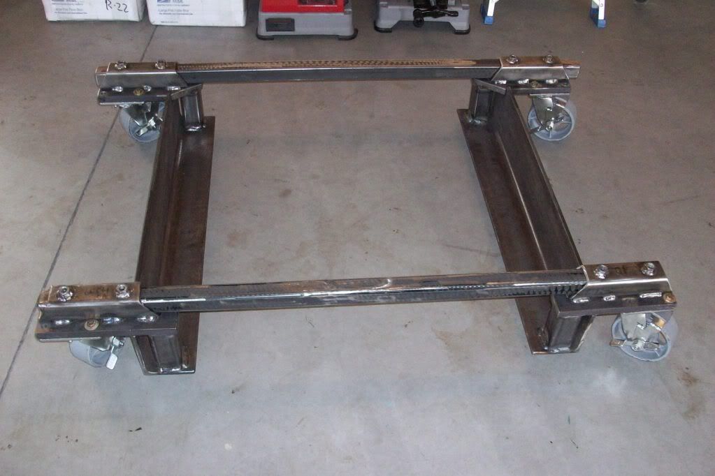

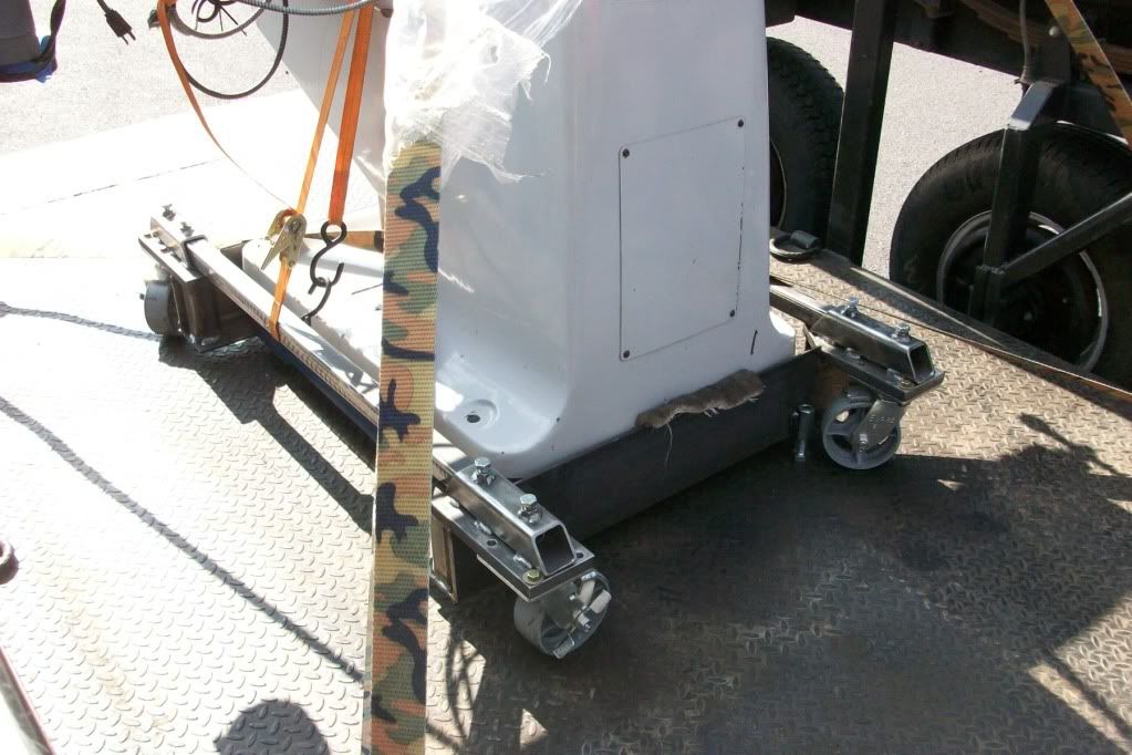

              Gentlemen--I consider this one of the most valuable "tools" i have ever built. It allows me to single handedly move over a ton of equipment (lathe and mill) that otherwise I may not have acquired or may have been more complicated and expensive to move. This has a fixed width of 24" and the length is adjustable for machine bases. The casters are rated at 1100 lbs each. Hope this provides some ideas if you have access to a welder. Cheers!

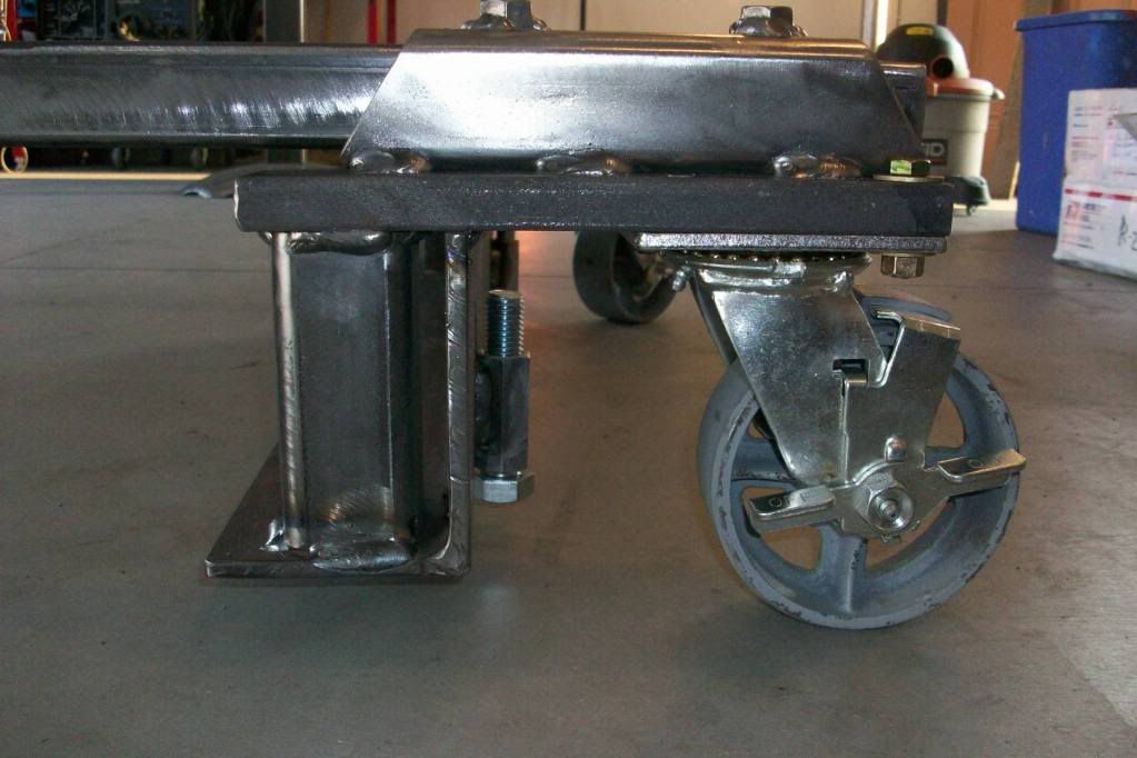

                What is the purpose of the bolts on the vertical leg of the angle iron?
                Are they to stabilize the load during transport?

                  I would guess the bolts are to stabilize and eliminate rolling while loading and unloading.

                          • Gents thanks for the comments. The purpose of the leveling screws is two fold:
                            1) as was pointed out, it makes the load secure and doesn't allow it to roll around. The brakes on most casters are useless when its over a ton weight.
                            2) the prime purpose of the screws is to allow you to slip the carriage under the piece of equipment to move it, then to remove it when it's in place. The way this works is fairly straight forward. To get it under, use a crow bar to jack it up enough to slip a shim under the base of the machine thick enough to allow the carriage to go under it. The jack down the screws allowing the machine to rise in order to remove the shim. Then lower to allow the wheels to carry the load. The removal of the carriage is the reverse of above.
                            This allows me to be a one-man moving show. It's a lot simpler than it sounds and only takes moments. Hope this helps. Le the know if there are questions. Cheers.
