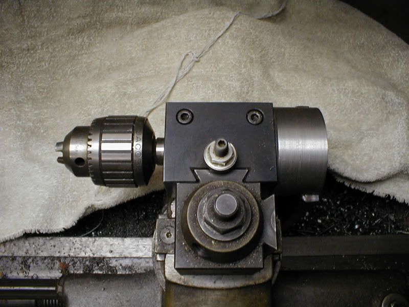

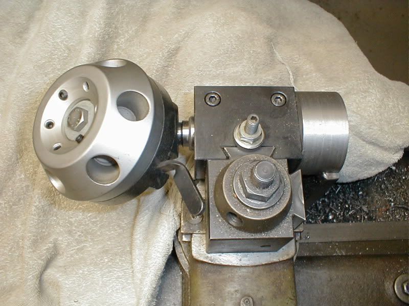

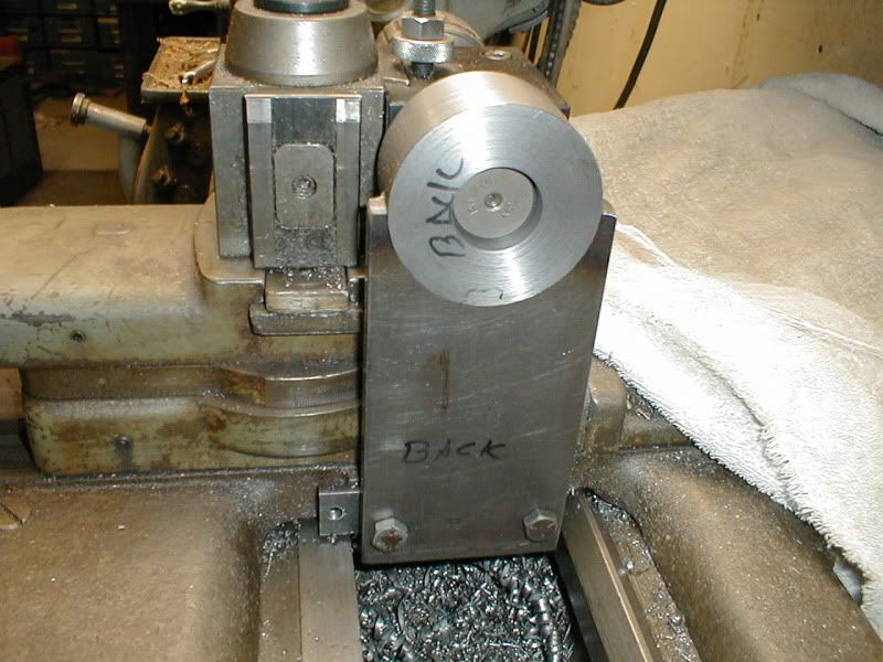

    • QCTP Drill Backup
      I was reading in another thread how the poster had trouble with a QCTP rotating when using it to hold a drill. I had the same problem as well as the cross slide moving back and forth from screw backlash, and came up the a backstop that will stop this. The photos should be self explanatory. The boring bar holder has an 1 1/4" ID hole so I used a 1 1/4" X 3 MT sleeve which happens to be just long enough to go through the hole bored in the backstop to hold it all together. The backstop is bolted to the holes where a follower rest would be. When it's all tightened up it is very rigid. As you can see, it can also be used as a turret holder.
      TS
      • Nice Solution !

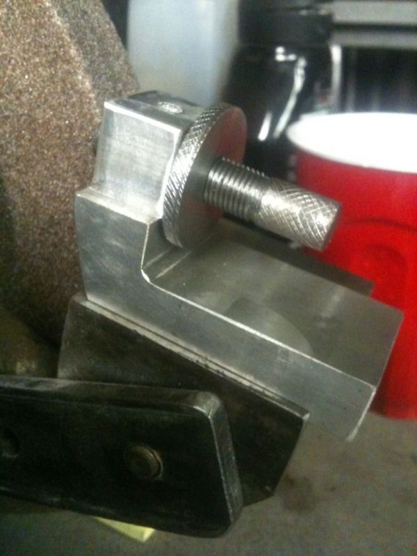

            • Wheel dresser for bench grinder
              Whipped this up. Cheap diamond point from enco...threaded it for 3/8-24, made a knurled jamb nut. I squared up the tool rest on the mill...it references off of the back of the tool rest...just guide with one hand and feed with the other...works much better than the serrated wheel things..
              • lbhsbz nice job on the dresser but a diamond should always trail the wheel, in other words your diamond should tip down about 5° to 15° from the center line of the wheel.

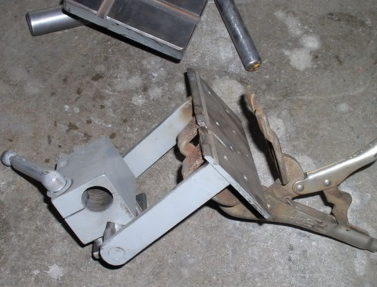

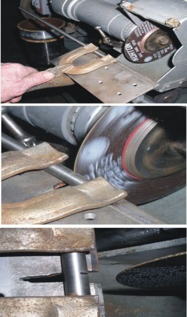

                • I often need to round the edges of parts like the one pictured to fit into a milled pocket.
                  I replaced the stock tool rest with this replaceable/adjustable rest and installed this rig. The aluminum block can slide fore and aft as the grinding progresses or to accomodate different dimensions of workpiece and can be locked in place.
                  The pivot pins can be changed depending on the hole size in the workpiece and are locked in place via a thumbscrew.
                  John
                  • Originally posted by ZINOM
                    John
                    Well, now I know what my next project is!
                    Sure beats my method of marking a circle around the hole, milling a dozen little flats, then blending them with a grinder.
                    • Originally posted by duckman
                      Good to know...I'll have to rework it a bit.
                      • ZINOM: Can you post a picture to show how your grinding rest is made and attached? Thanks.

                          • This is a shot of the mount...it's a bar mounted to the bench with the set-up mounted on a section of angle iron.
                            There is some wiggle room in the top holes (where the angle connects to the bar) so the angle can slide up or down a bit and the bar has other mounting holes.
                            John

                              • ZINOM; That looks like a substantial rest. I think I can make it so it will tilt and swivel. The sliding block might be good for some other applications, maybe a pusher screw in back of it would allow controlled advance to the wheel.
                                Mine will have to wait till the woodworking is done, doing Santa projects now, then need to build an extension for my computer desk. I'll post if I get anything done with the grinder.
