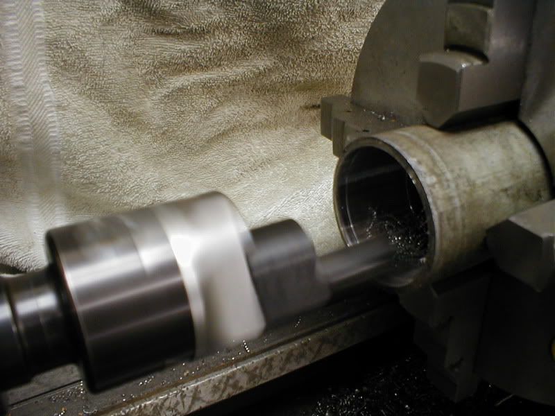

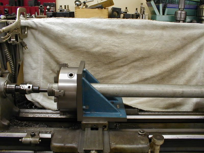

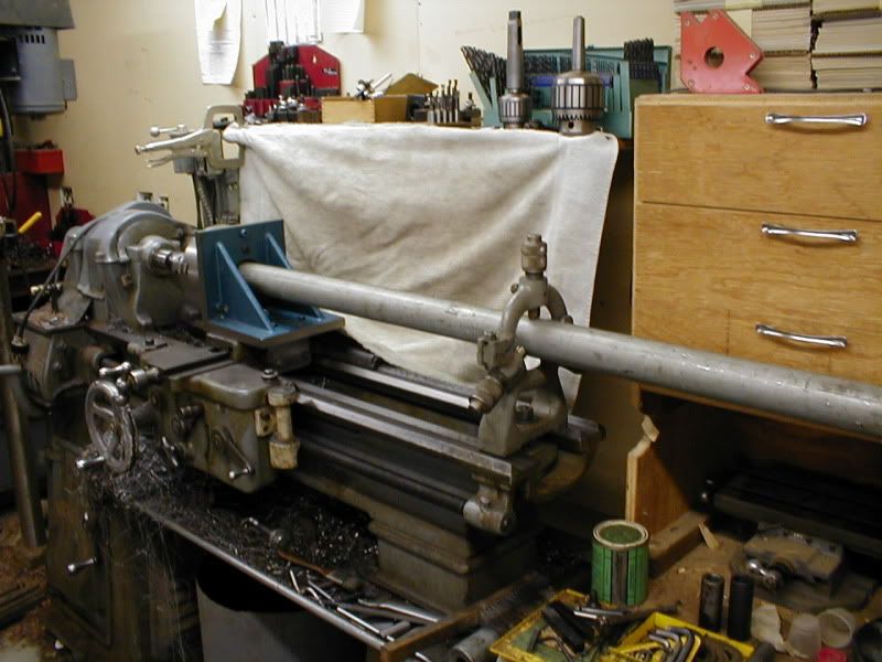

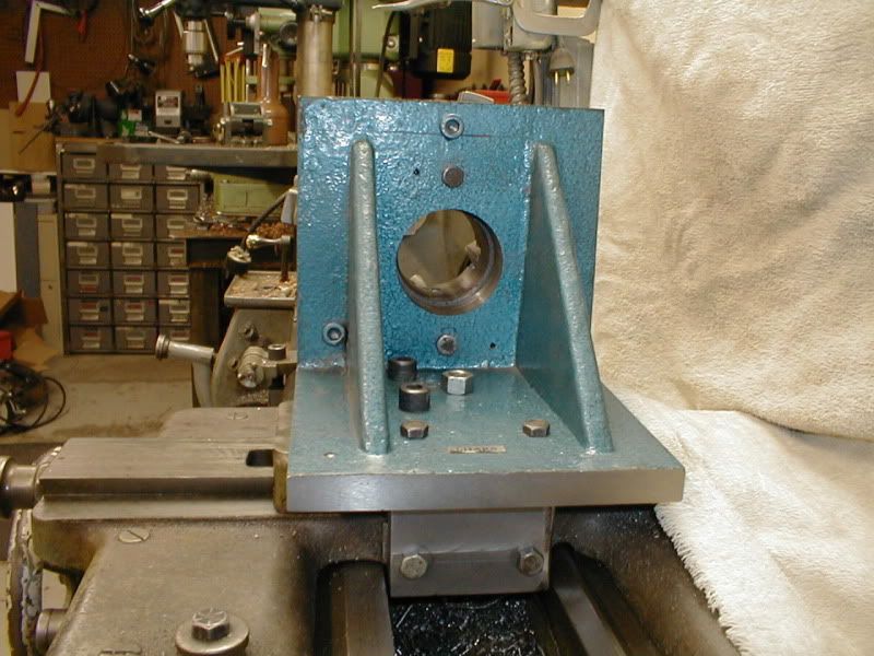

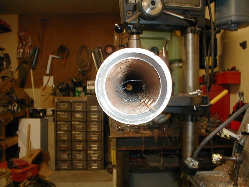

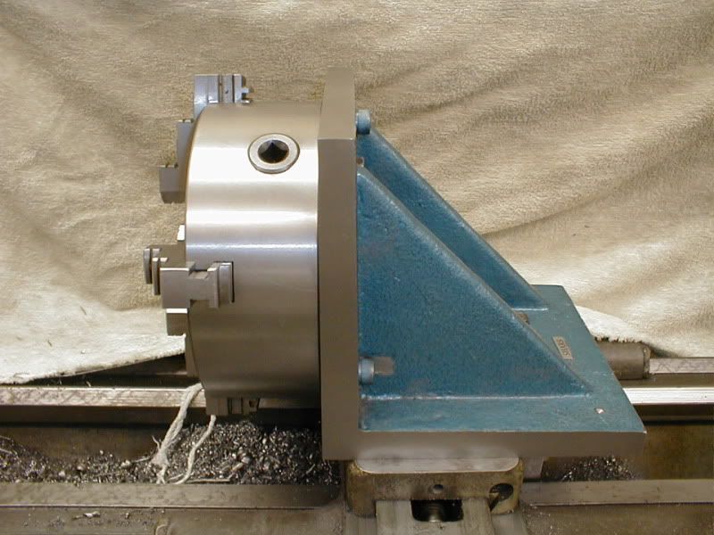

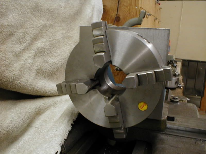

                      • Large Bore Lathe Pt. 2
                        Carrying on in the large bore theme I started last year with my chuck extension. This one came about because of a job at work. We have machines that have bars made of 1 1/2" SCH 40 stainless steel pipe with hubs welded in the ends. These bars are about 6' long and the ends are bored for a 5/8" bronze bushing. The holes are blind so there is no way to get a worn bushing out except to chisel it out. Don't even think about using a hand held drill to try and drill it out. Talk about a wrist buster and damaged bore.
                        Our lathe only has a 1 5/8" bore. I contemplated figuring out how I could mount these bars on the carriage to bore the worn bushings out but with 9 of these bars to do and the setup time each end would require I didn't have the time so we send them out to the OEM for repair.
                        This did plant the seed in my mind however and after running several scenarios over I came up with what you see. I used the 8" self centering 4 jaw chuck I used on last years project. It has a 2 1/2" bore. I then bought an 8" angle plate and mounted it to the lathe carriage in such a manner that it is locked down solid. The steady rest was already modified for roller bearings so it was a simple matter of machining a new anti rotation groove at 90 degrees to the existing ones so the bearings would run laterally.
                        Considering that I used off the shelf Chinese parts it turned out very well. I only have about .002 " runout and an equal amount of off center laterally over an appox 2" depth.
                        The test piece is 2" SCH 40 pipe about 6' long. I know the pic looking down the bore looks quite a bit off center but it really isn't. The camera flash makes it look that way.

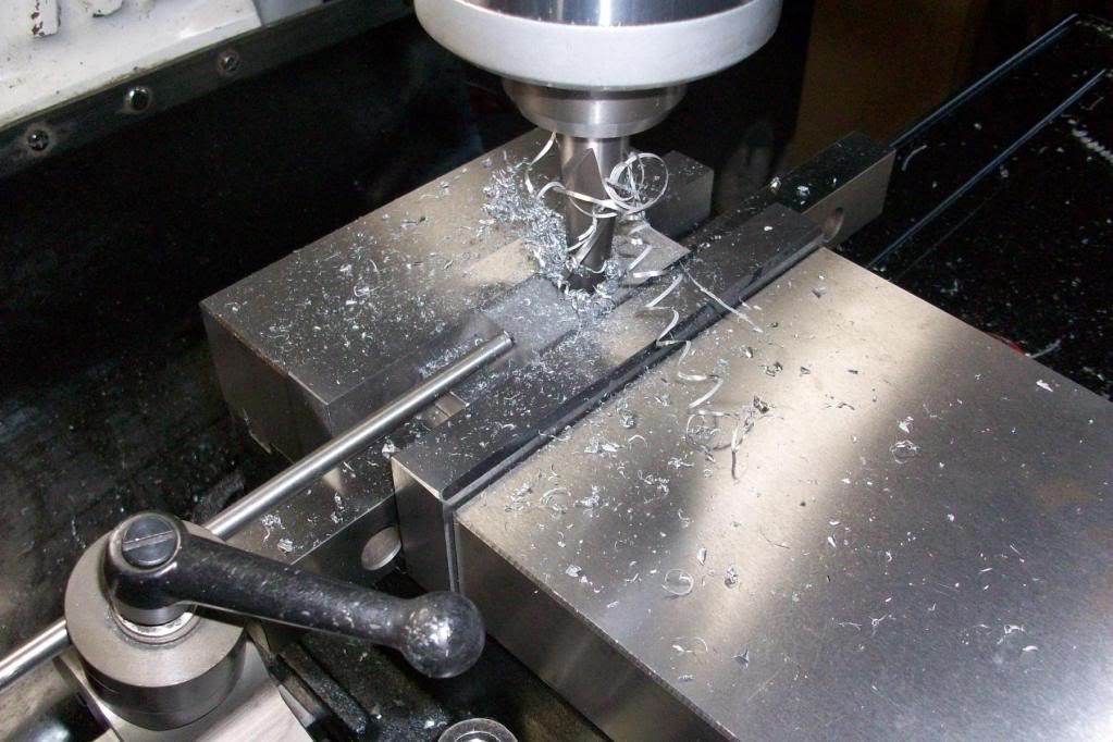

                          • Quick and dirty drill center/punch
                            I made this from a broken end mill. I ground a VERY sharp point on it. So it is capable of punching mild steel. I just chuck it up, put it where it needs to go and stab it into the part. Chuck your drill up and your centered and the bit will not wonder off.....
                            This is a set of soft jaws I made, not much has to be exact.
                            This isnt as elaborate as most of your tools, but handy!
