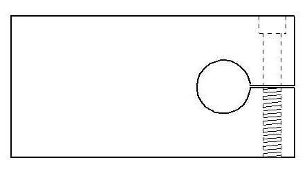

                I just thought of this and it seems like it should work too. If you don't have a boring head [or yours is threaded], but you do have a four jaw chuck and some boring bars, this may be a viable option for outside turning. [it would probably work for inside turning too]
                It's a simple bar or block with an offset hole that is slotted, cross drilled and tapped for a clamping screw. This mounts in your four jaw and is adjusted by loosening one jaw slightly and tightening the opposite jaw. A dial indicator will help to adjust in precise increments. Measurements are whatever your needs may be. But since the boring bar will act as a lever, thicker is better.
                Note: my brain says that as long as all the jaws are tight and the block is at least one inch thick, it should hold pretty solid. But my brain has been wrong before. Your mileage may vary.

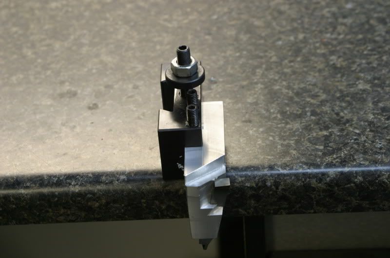

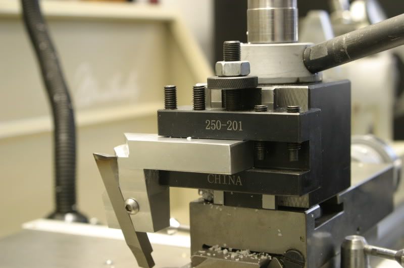

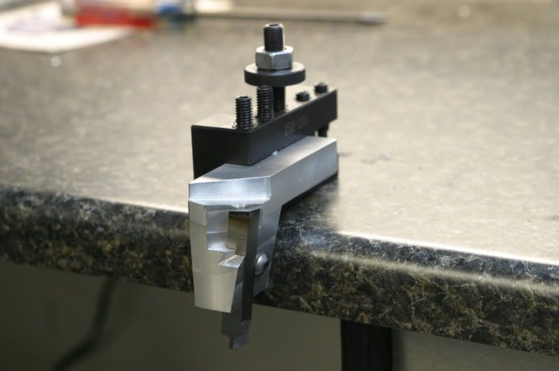

                        • Not anywhere as elegant as most on here, but I could not have done this without your help. So, here is my version of the tangential tool holder. It does work well for deep cuts
                          • Originally posted by Theiskell
                            that sure is a pretty thing ! but like the octopus and the bagpipes ....... i have no clue as to what to do with it . lol please explain . thanks jack
                            • Originally posted by jack3140
                              Sorry, I guess I should tell what it is. It’s a tangential tool holder. It allows you to take much deeper cuts and seems to give better finishes. Also the tool grinding is simple. One 30 degree angle on the end of the hss tool. I am no expert on this but had seen several different discussions and versions of it on the web and thought I would give it a try.
                              Originally I was going to incorporate it into a tool holder. Well I did that, cut the dovetail and all, then found out that it was not going to be low enough to center on the stock. I know, I know, newb mistake. I was able to make it work just not how I originally envisioned.

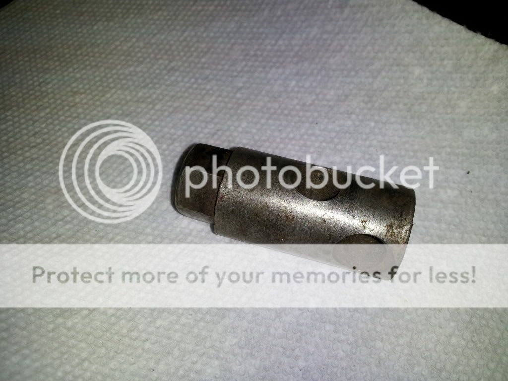

                              • I ran across this the other day. I think it was my first government job after I became an apprentice. I was telling one of the journeymen that I had a metric plug that I needed to get out of a VW transaxle. He told me that it sounded like a good project for me. He had me design it. Probably would do it different now, but it worked. He even had me heat treat it in the weld shop. I think it was water hardening drill rod.
