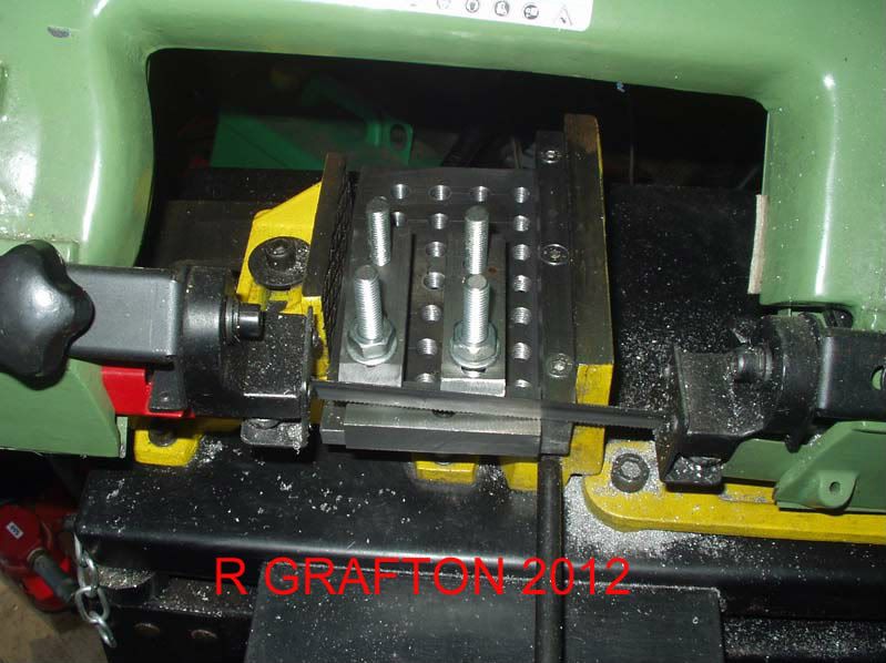

        • Sub base for a bandsaw
          Hi
          I posted a pic of this in another thread on here and someone suggested I put it in here so here it is.
          The idea originally came from Model Engineers Workshop, I just bent it to fit, so to speak.
          heres the plate with some clamps,
          It measures 6" x 4" x 3/8" and has 28 m10 holes. ( tapping them was fun)
          here it's in position, my saw's maximum cut is 4" and after trimming the long edges parallel I put it in the saw vise and cut the end square with the blade.
          And here it's set up to cut a block of steel lengthways, as you can see, I can get very close to the blade.
          That's it really, very simple and very very useful.

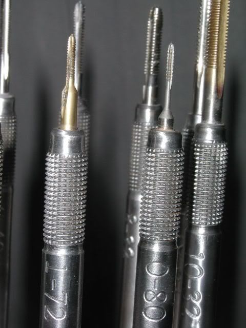

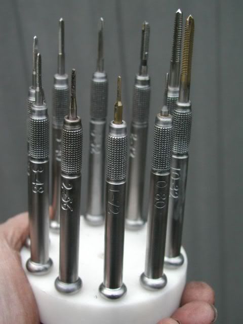

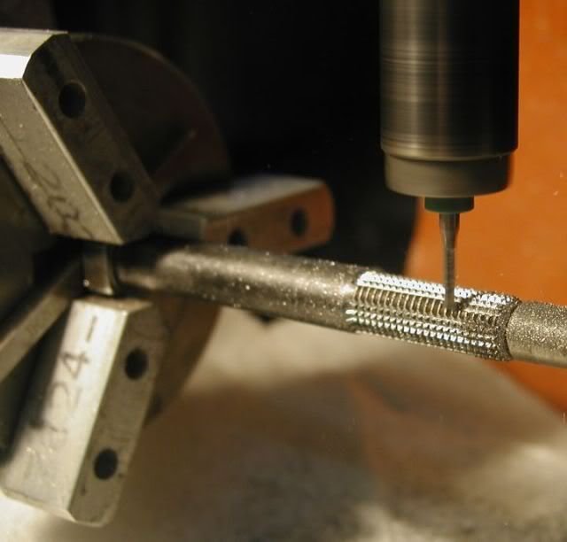

          • Originally posted by gary hart
            Small tap wrenches made from 7/16 - 20 bolts. Hex head end is drilled for slip fit on 1/4" shaft and the hex rounded off.
            Indexing around and using corner of end mill cut some "knurls" across the threads on the bolt.
            How do you stamp numbers around a shaft like that?!?!
            • Originally posted by bent metal
              I believe that he stated a few posts later that the numbers were not stamped but cut on a 4th axis CNC mill.
              If you want to do something similar but only have access to stamps, mill a small flat area on the handle. If you have an indexer, you could even mill flats all the way around to add some uniformity to the look. Flat every 120 degrees will give a triangular pattern. Every 60 degrees will result in a hex pattern.
              • It's called a CNC stamper.
                • Couldn't a stamp be rolled onto a round somehow? Especially if it was aluminum. In the lathe maybe?
                  • That is a slick idea! How are the taps held in?
                    • Held in with Loctite.
                      Too remove the tap, heat holder with propane torch to break the Loctite bond.

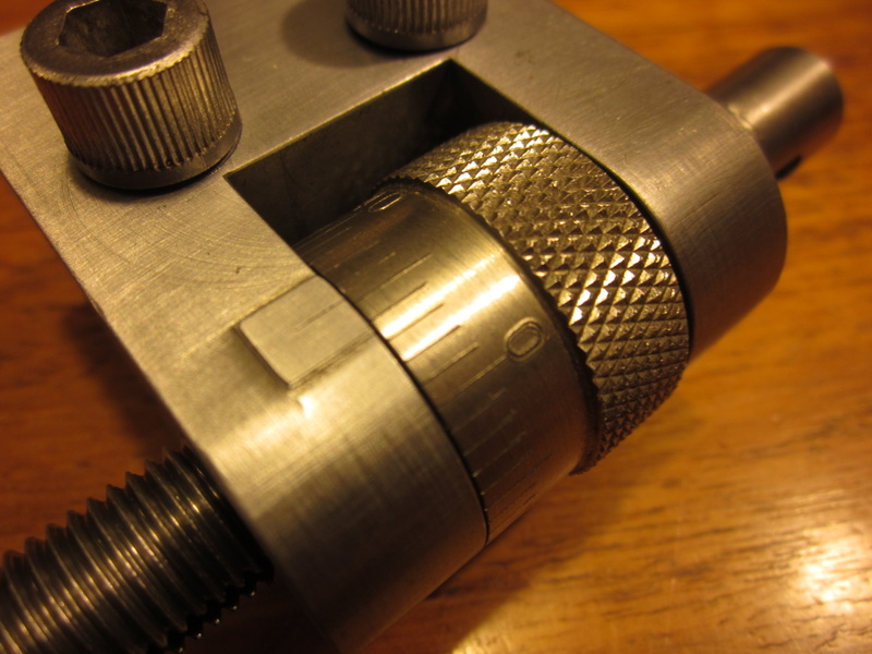

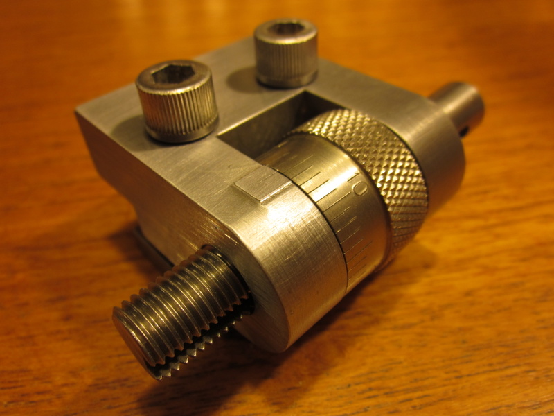

                              Here's a graduated carriage stop that I made for my dad's Atlas lathe. I've since redesigned it, switching the graduations to the right side to make them easier to read and moving the guide pin for the spindle to the bottom where it and the slot in the spindle are out of site. I also made a set of drawings for it. The graduations were cut using a vertical mill as a slotter with the tool held in a chuck and fed with the quill, the graduations were hand stamped (with a makeshift guide).

                              • Beautiful piece of work TGriffen. I like that elevated pad with the scribe mark. I'd be too lazy to do what it probably took to make it that way ... I would have probably SuperGlued it on *LOL* Nice job!!!
