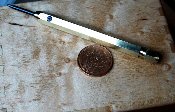

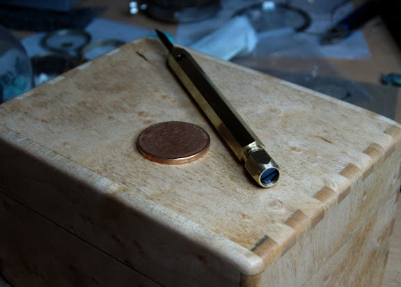

  • Just thought I'd quickly share a watchmaker's screwdriver I finished making last night. I plan on making 2 (for now, at least) to replace the 2 largest sizes from my set, that suffered from stripped out set screws.
    The body, and whatever you call the little spinning finger rest on the end, were just made from 1/4" brass hex stock. The screws were made from O1 drill rod, and I'm just reusing the blade inserts from the existing screwdrivers. This was my first time using a screwhead slotting saw blade (as opposed to a screwhead slotting file), and the larger screw shows my inexperience - the slot is off center. I think I got the set screw dead on though.

    • Nice work on the screwdriver and great attention to detail. You know you'll end up remaking that screw though, or it will haunt you forever.
      I was checking out your web page and it looks like you do very nice work in general. I have an old Elgin railroad watch that belonged to my grandfather that needs a new staff and I've always been tempted to try making one. I don't have a watchmakers lathe, but I do have a Hardinge and a stereo microscope. Maybe one of these days...

        Thanks Tom, I really appreciate that! I won't say you can't turn a staff on your Hardinge (they are excellent collet lathes, from what I understand) but the challenge will be the pivots. Turning such a small diameter is a lot easier with a t-rest and a graver (there is an excellent old text called A Treatise on Staff Making and Pivoting, that describes a graver technique for this and it works extremely well). I seem to recall some of the older precision bench lathes having t-rests available as options and I see no reason why it shouldn't work fine on a larger collet lathe... it probably wouldn't be too hard to make a t-rest to fit on top of your cross slide for turning the pivots after you have the other dimensions turned. If you decide to try it, let us know how it goes!
