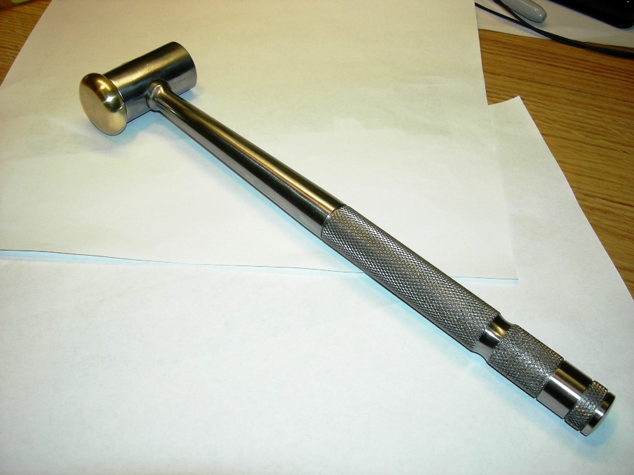

    Thanks. I decided it was time to learn machine work. So I am taking classes at the local VoTech. The hammer was the last project in the basic lathe class.

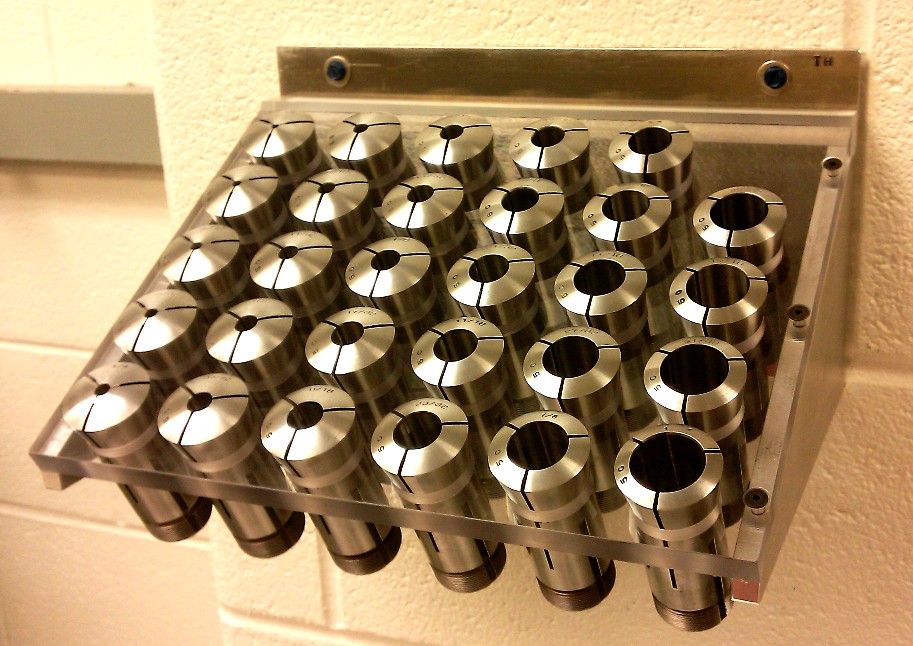

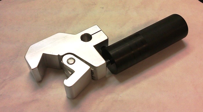

              • I'll add some of my little projects over the last year:
                Drawbar wrench:

                Collet rack with acrylic:

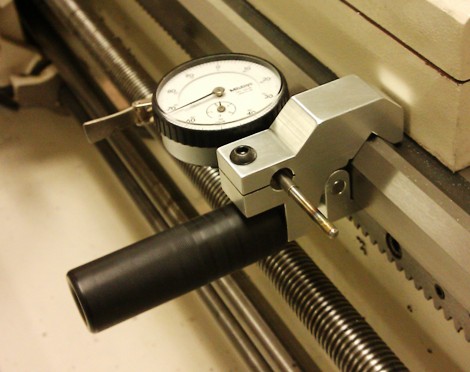

                • whoops, one more.
                  Lathe indicator clamp with easy adjust handle:

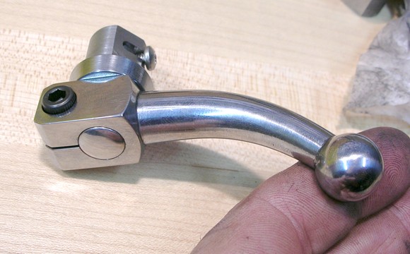

                    • yes! i registered to the forum a while ago and finally got in. I have no real training with a lathe or mill except for being taught how to mitre on a bridgeport at bike school. i recently bought a little atlas 9 inch lathe and have been learning what it can do. i made a little aluminum stand off to hold tubing for tacking and an attatchment to mitre 7/8 so far. this thread has been a major source of inspiration for me so thanks!
                      http://thatcherworks.blogspot.com

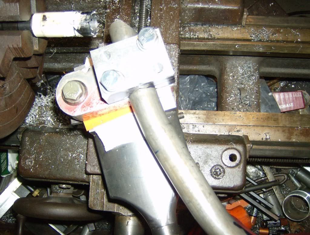

                          • Tried coping some tube on the lathe today.It was great..Very easy to set up with the compound angles ,plus you can dial in the holesaw in the 4 jaw, so it actually ran true..
                            • How did you turn up the duracell batteries?
                              • My guess is that when he went to take the photos he had to change the batteries in his camera. I hope they are dead, I can imagine what a good live battery could do in pile of metal shavings.
