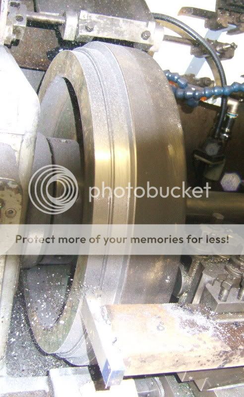

    I posted a while ago pics of the big flywheel which just fitted in my lathe, I showed it with a boring bar set up for machining for a ring gear. The boring bar worked, but it was a bit slow as a heavy cut induced chatter, and the HSS tip had to be reground every couple of passes on the dirty cast iron.
    I just got a LH brazed carbide tool, welded it to the end of a bit of rusty old 4" x 1.5" bar, and milled just enough off the side of the bar to get it into a QC holder. I could take serious cuts with that, & no need for regrinding.
