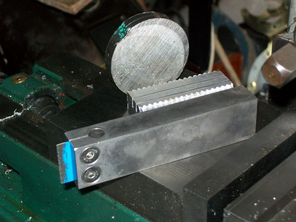

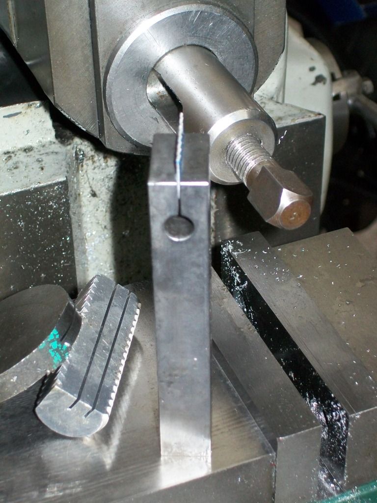

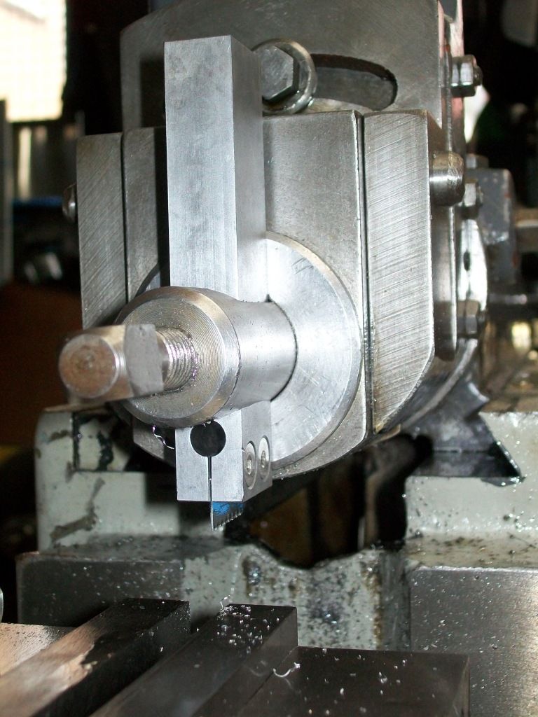

                        • There is some lovely work in this wonderful thread I thought I might add a simple but very effective tool I have made.
                          It's a Shaper Slitting saw based on an idea from Ian Bradley's book The Shaping Machine.
                          Cheers
                          Paul
                          • That sure looks to be a handy tool (and well made).
                            Is that just a section of hacksaw being used as a cutter/saw blade?

                              • Originally posted by + or - Zero
                                Thanks for the compliment and yes it uses standard hacksaw blades, I normally use the unworn ends of old blades unless I snap a new one then I use that.
                                It was quite a bit shinier but the casehardening stuff I use tends to leave a bit of a dull finish/pattern.
                                Cheers
                                Paul
