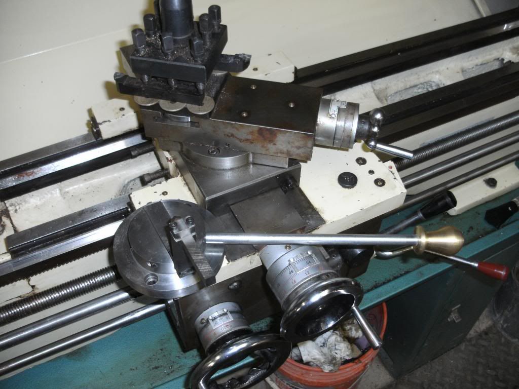

    • I looking to build one and I can understand most of how this will work but... Looking at the bar (pic left). Is that left on, when not in use, tight loose, removed... I know it is needed when using the taper...
      But what happens once the slide is bolted back to the the cross screw?
      Originally posted by Randy View Post
      I built this for my Jet 1024. I rarely use it, but it was a good project, and it looks nice. (The spot next to the adjustment knob is an epoxy patch resulting from a mid-build design change.)
      • When the taper attachment is not in use, the clamp bolts on that anchor are simply left loose, so that it can slide freely on the V-way.
