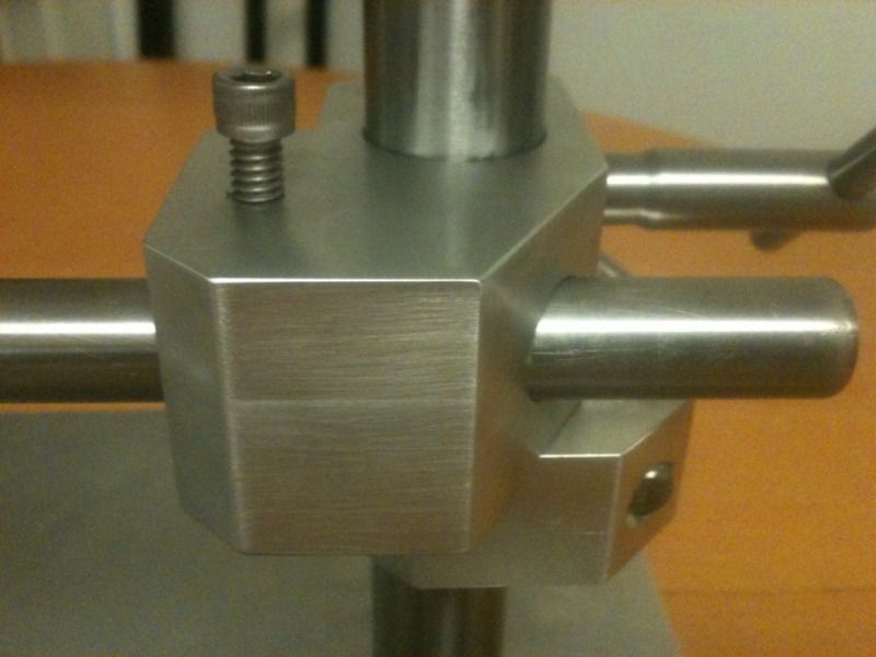

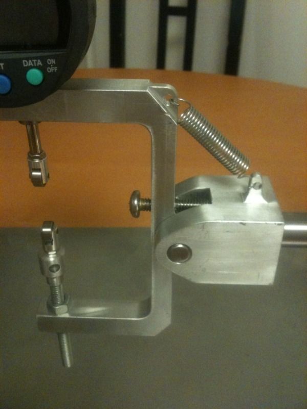

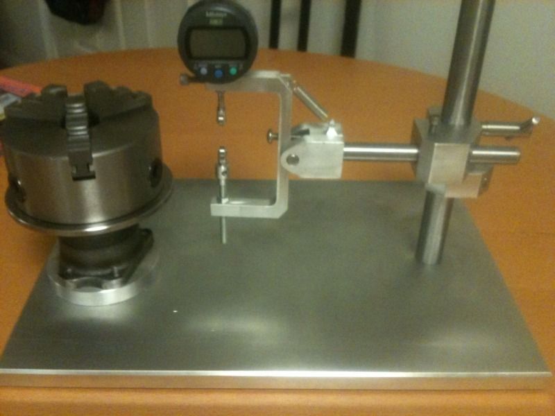

                • This is a fixture to measure brake rotor thickness variation. Some of the nicest work to come out of my garage....usually I just slap stuff together so it works on my own stuff...but this is for a paying customer.
                  • I would have though watching a needle swing would be easier to see. I guess if you have a min/max setting, that would work too.
                    • Yes, it is a nice bit of kit. I think he made that for a customer, I assume it was to the customers spec. I suspect the customer is planning to use it to show his customers why a rotor needs replaced --hence a digital readout (easier to get the point across to non machinist types, big numbers worse sort of thing --needle swinging is just a needle swinging).
                      • Originally posted by + or - Zero View Post
                        This was a bit of a rush....built it on the side, but for work. The boss gave me the project on Thursday of last week, and as usual, he wanted 2 of them yesterday. We didn't have much time for research or planning, so I just kinda did it. I had a feeling the electronic indicators would be a problem...and they were. I picked up a couple of dial comparator gauges today...and aside from being a bitch to set up, they work much better. We're gonna have a team using these 2 fixtures to check over 1000 brake rotors...don't ask why. The real bitch is the c-frame thing and the pivot...I musta recut the damn c-frame 20 times creeping up on the dimension....then polished the tool marks away just a bit to get a perfect fit. Made a fixture clamp them together so I could drill and ream in place to assure hole alignment....then polished 2/3 of the pin down to as near I can tell, about .0003 under size, while leaving 1/3 of it about .001 over size so it would stay in place, but the c-frame pivots freely and with zero play. Jus. Finished that up....need to make some thumbscrew handles, add a few stop screws, and we're done. Should be a chunk of change coming my way tomorrow. I'm about 40 hours into it I think....never thought it would take this long.
