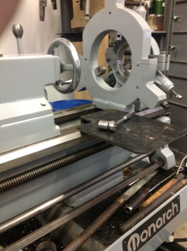

                  • made this to have a place handy to set small tools while running lathe. jim

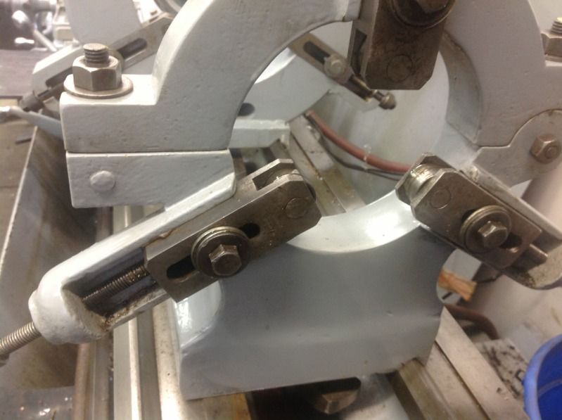

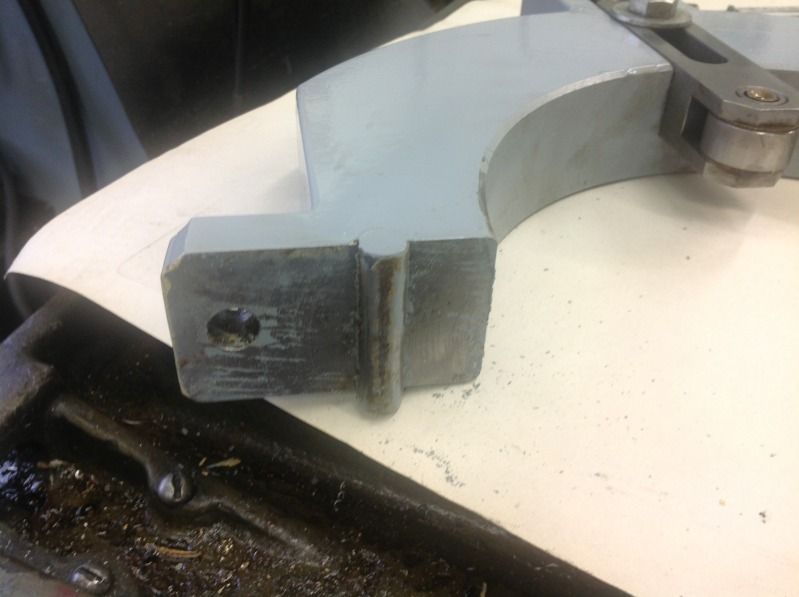

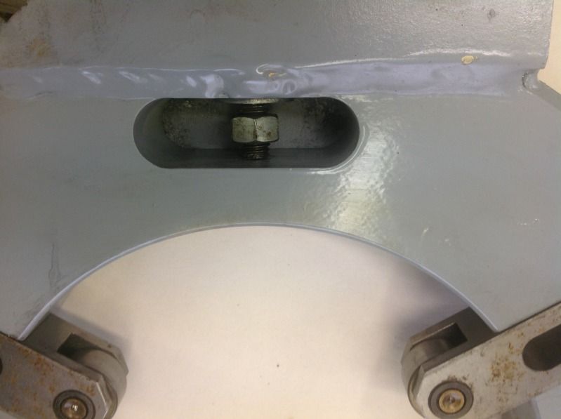

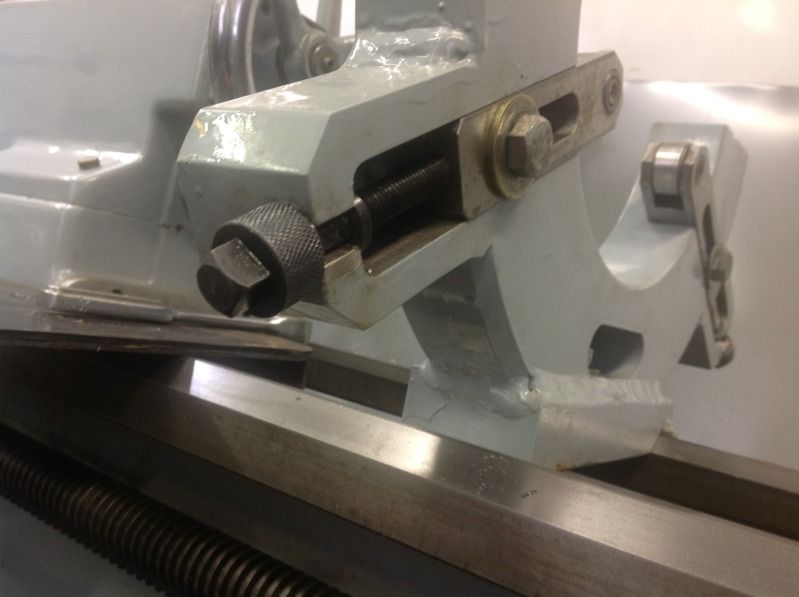

                      • Here are a few pics.

                        • Very nice steady. What size & brand of lathe is it for?
                          • J King, thanks for taking the time to post the detail pics of your steady, I'm sure that I won't be the only one to benefit from them.

                            • Your welcome.trying to get one more pic loaded.
                              I found the bearings on eBay.i had used standard bearings on the smaller steadying fingers but found the correct bearings.supper lucky with timing on those.made the adjusting screws and heated them up and threw into used motor oil.a cheap way to darken metal parts.
                              The split line has dowels.i lock tighted the dowels to one half but ended up removing the second dowel as it wasnt needed.

                              • Here is the roller fingers I made for the smaller steady.i made them to interchange with the solid fingers that are also needed at times.these worked out ok but a solid bearing that I found would have been better and heavier.cost 10 bucks for bearings so a cheap mod.dont have a clue as to what the steady was off of.i cut bottom off and welded a new base and remachined it to fit height and ways.where do all the steadys go?..Jeeesh. My 10 ee was missing its steady also.made a live steady for it..will find pic. Jim
