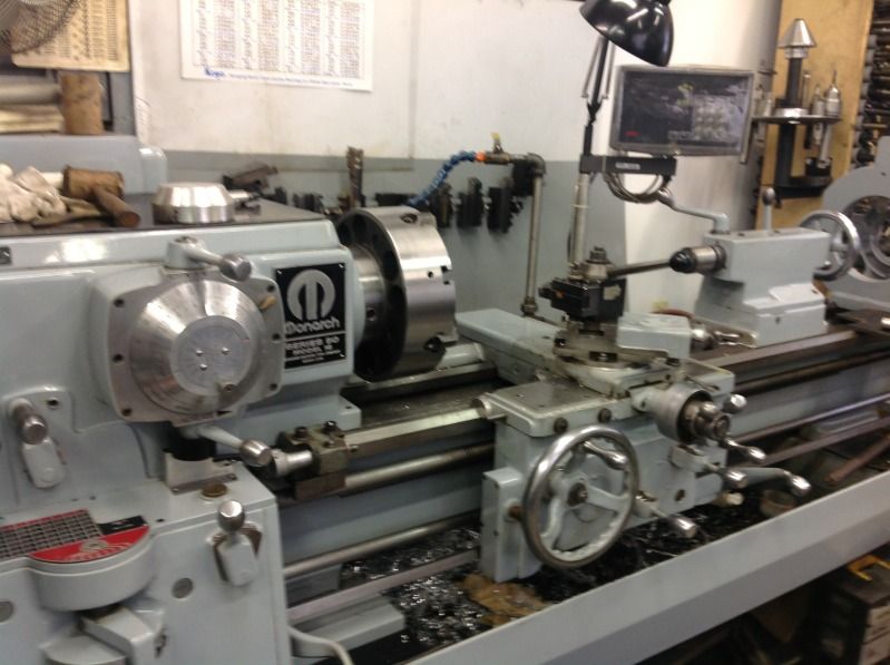

  • Dr Stan,
    The lathe is a Monarch series 50. 16x54

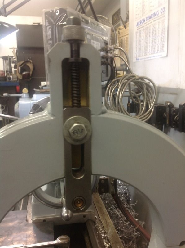

    • Jeeesh I'm getting carried away.lol. Sorry if offends anyone.having fun with my Xmas present.weeee..pic of a live bearing steady.

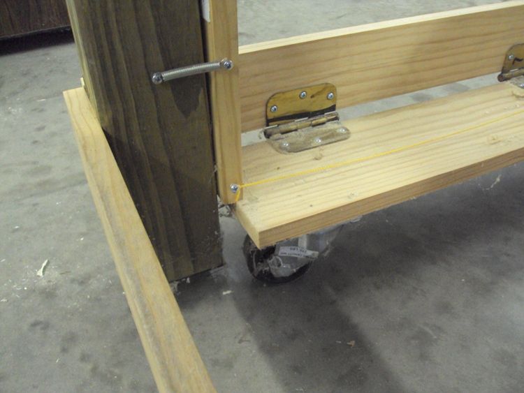

        • Not actually a tool, but a item I use a lot, is my moveable work table:
          The top is 3/4" ply with plain white formica. The hole in the top holds a router table made of cast aluminum (al-you-mini-um to our friends across the pond ) tooling plate, but holds other fixtures I've made.
          The table is made moveable by a hinged caster arrangement that I wish I could claim as my own design, but saw it on the net and stole...er...copied it. When you lift the table, the board with the casters hinges down and the latch boards hold the casters down:
          Each corner has a string that pulls the latch boards out of the way to allow the casters to swing up and the table to rest on it's 4X4 legs:

          • Originally posted by j king View Post
            A die grinder with a cut off wheel can cut conduit very easy you know.

              • Originally posted by vpt View Post
                You lost me on that one.
                  He was referring to your bundle of wires in the pic. Look like DRO leads, so shortening would be a bit more involved.

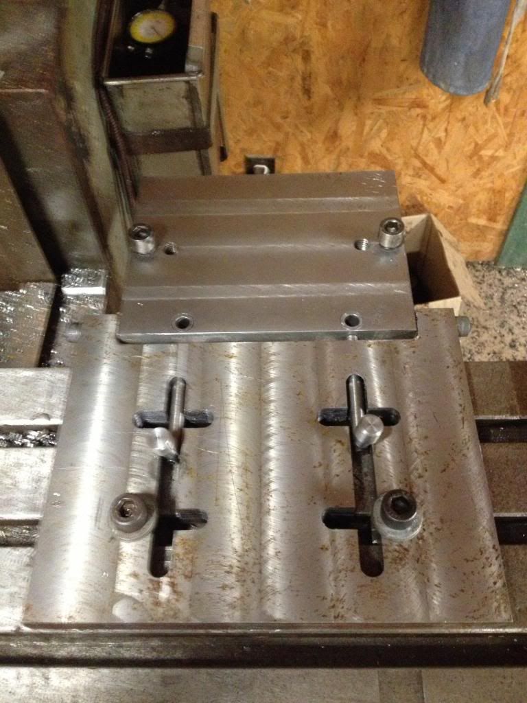

                              • horizontal to vertical adapter plate
                                So....This has been on my mind for a while....I have needed a good vertical rotary table for some time,but every time I look at the prices I cringe....I have a small 4" but it's really not satisfactory for heavier milling,not to mention the dividing capabilities are sparce,as with most affordable tables....
                                Last summer I acquired a used but solid Van Norman horizontal dividing head,so I said HEY!!!! Why not come up with a good way to support this vertically,so here's what I came up with....
                                This is the plate bolted to mill table before putting on dividing head

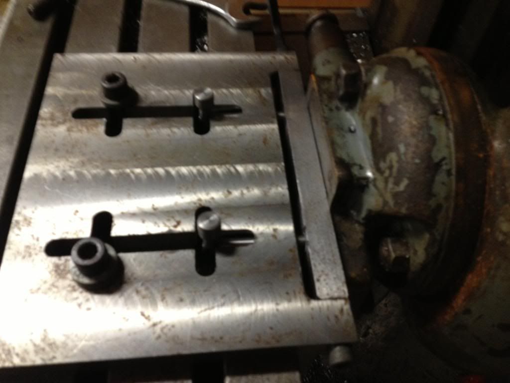

                                Dividing head bolted to plate before swiveling into place
                                Rotate head into place,slide in the 2 pins and you're ready to tram
