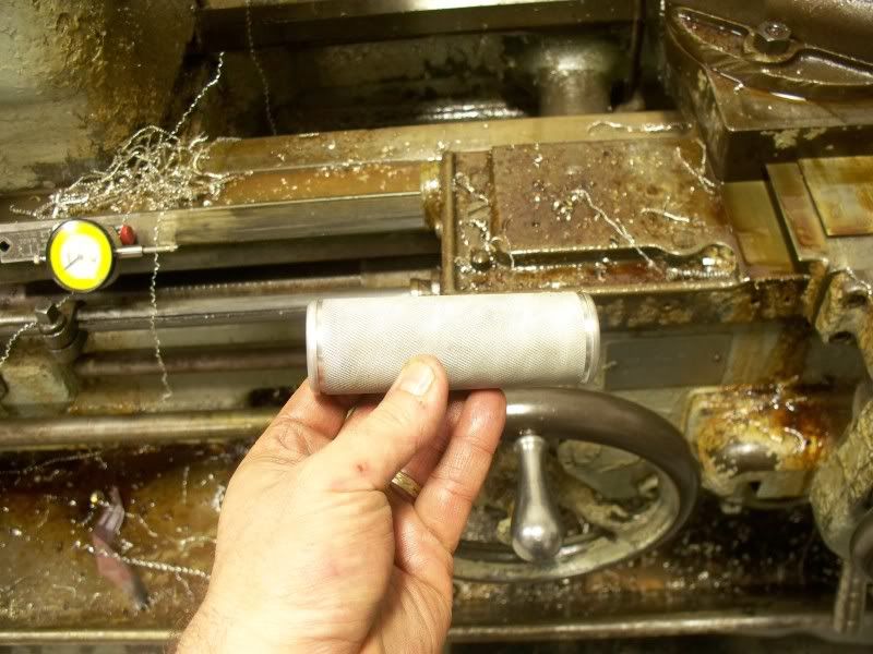

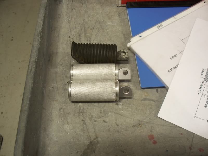

    My brother is rebuilding his Harley for the "4th" time
    so I was asked to make a few parts again...
    this weeks project was footpegs, a set of mid-pegs and a set of highway pegs

    Nice work. Got any pictures of them installed on the bike?

        Nice, but are they slippery? Do your feet slip off when they get wet?

          I ride (not Harley) and would strongly suggest you throw those things onto a mill, get a small ball mill and start making some coarse pattens in them. Such a fine knurl will have no grip for boots when they're wet. Not that a guy on a Harley ever rides in the rain....
          Now that I think about it, it might be nice to make a pattern of full-radius grooves using the lathe, then cross them with a similar-size ball mill to effectively make a very coarse, high-grip surface. Then be sure to mill off the big chamfer, just in case the bike sees any lean angle. It could startle the rider if those were to touch down prematurely while taking a corner.
              Like this???? Those points are sharp enough to rip ya open. Boots do NOT slide off in the wet. Used 1/4" ball mill

                1)Yeah that's an old Pratt&Whitney at my job, been around a while but it a so;id old lathe...
                2) they are not installed yet but when I get pics they will be up...
                3) I told him to go with a big knurl, but this is the look he wanted...if it becomes a problem I will change it...
                4) yeah...lol... this bike hardly gets ridden so wet is not an issue
                I think that answers them all
