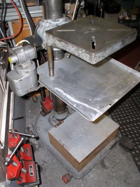

                      I find another table that has worked out good, mostly in helping clean up as it catches lots of the mess from drilling. The table has a collar on the column and two posts attached to bottom of the drill press table. This swivels and goes up and down with the drill press table.
                      Anothe nice addition is a foot switch. Hard to see in the picture but is attached to base on the lower right side. Drill press in mounted on skate board wheels so can get behind for cleaning.
