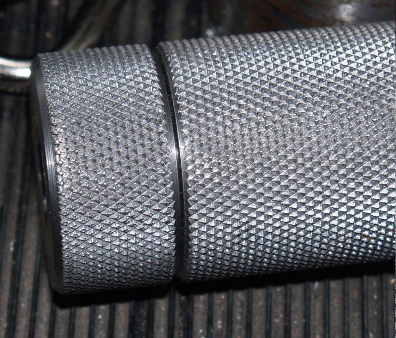

                          • MuellerNick
                            #14
                            These are my self-made knurling-heads:
                            And this is one of the results:
                            Admittedly, the left part is not perfect.
                            I never calculate the diameter, because you always get it working. Do not use oil, you will end up with some kind of metal mill. Use flood coolant to wash away all the fine chips.
                            Simply start with about half the wheel's width in contact and feed in until the pattern "catches up" (no doubles) then move left/right and feed in until the pyramid's tips are closed.
                            Nick
