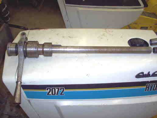

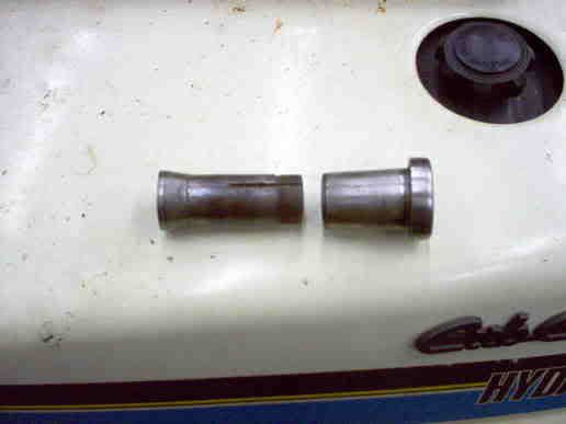

    I need some help.I bought this lathe but appears I am missing the parts to connect the draw bar pivot so it will close the collets.I also do not know what collets it uses so I can find some more.
    Any help is really appreciated.
    You may get lucky but I think you are very unlikely to find the part(s) you need. There are not a lot of Fourteens around and very few being parted out. If anyone has one with the collet attachment, they would probably not sell a part of the attachment as that would make the rest be worth a lot less. I think the part is pretty simple and you may be able to get a decent photo or drawing to make what you need. Collets should be available once you find out the type. There are some web sites with collet dimensions but I do not recall just where. A Google search for "collet dimensions" or "collet specifications" should find that info.

      That looks like a Royal 5C collet closer. See if you can locate the brand name on it. If it is a Royal simply go here: http://www.royalprod.com/product.cfm?catID=3&id=19
        Try this
        http://www.wswells.com/data/catalog/...tin-7001-D.pdf
