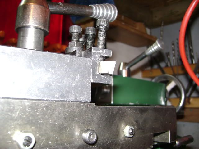

    i thought id share how i grind my hss cutters for most basic cutting and a form tool i also made for my wife for one of her ring styles also the max over hang i allow on average tools in the holder, the lesser the tool can flex while cutting the better,
    now iam not into making fancy looking cutters and i find no need for it either at least not in HSS cutters that you have to grind your self and these do a very nice job and the fiinsh they leave is also very well done,,

        I like the shot showing the amount of overhang. I always try to get the bit as close to the toolholder as I can as well!

            the less over hang you can get the more rigid it is and less chance on any kind of chatter as well, also the less chance if turrning a taper but thats not just the tool over hang to prevent taper turrning thats a whole other topic,
