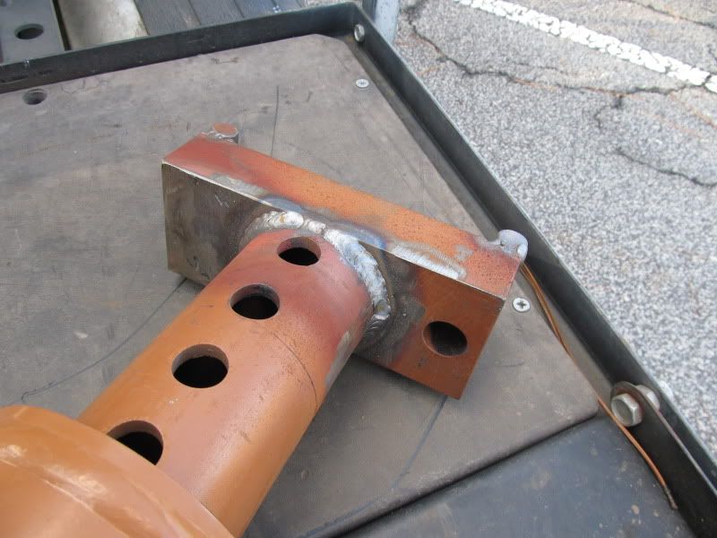

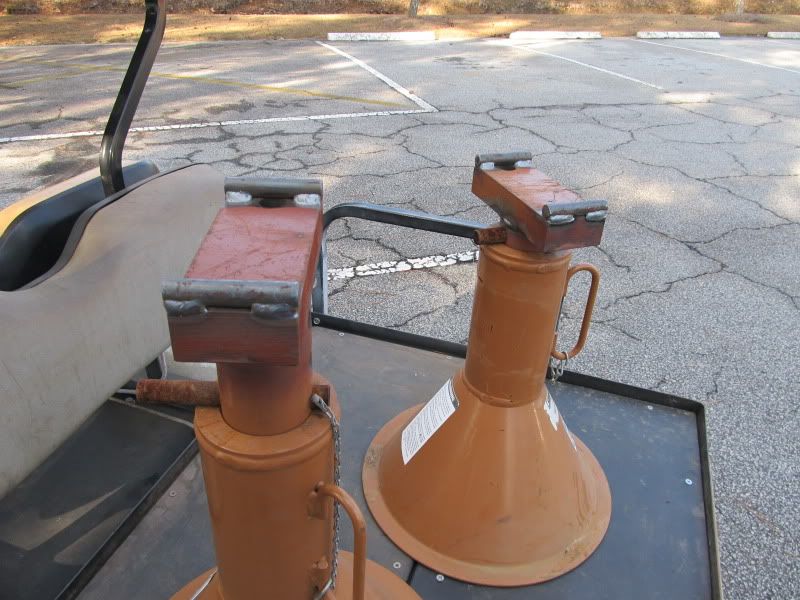

    • I modified two obsolete 12-ton special purpose jackstands to make them useful again. The tube was originally welded to the end of the block. I moved it to the center, and added the round bars on each end.
      That paint is surprisingly tough. I preheated the blocks for several minutes with the OA torch before welding the tubes in place, but the paint took it in stride.

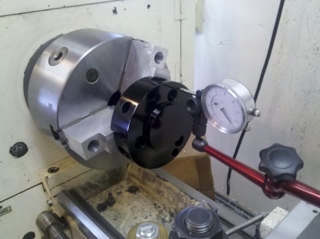

          • I worked on getting a high gloss black anodized finish...getting close I think.
