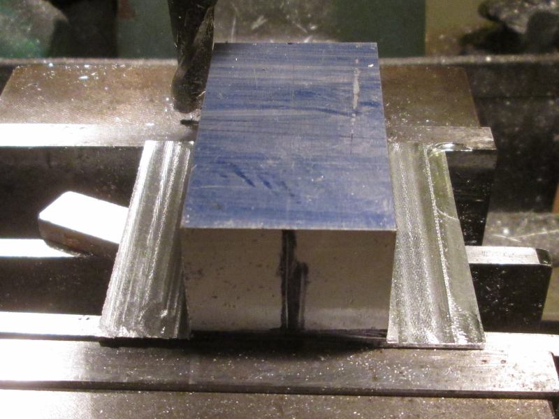

      • Cut a taper on the mill.....with the stock flat on the table and the head not tilted. No, I'm it sure how I did it either!
        Also, touched off, wound it down 2.5mm.....and took a 4.5mm depth of cut!
        I can only guess that the cutter wasn't quite held firm in the collet...but I'd have expected it to slide up and give a lower DoC not higher and getting worse as I cranked the table right to left. Glad it was aluminium, a 4.5mm DoC in steel would probably have been disastrous on my mill!

            Endmills tend to work down if a bit loose in the collet/holder. It's because the endmill's helix generates a downwards force on the tool as it cuts. Pity really, although a few spoiled pieces or broken endmills help one to remember to tighten everything up before making a cut.
            • Oh I don't doubt it was my fault :-D Was just trying to make sense of it. If downwards isn't as unexpected as it was in my head, that helps, cheers.
                I've had it go both ways. In the image below it walked down as the cutter approached the rear jaw of the vise on the right side:
                On a different project while counter boring some holes, the counter bores became shallower and shallower as the cutter walked upwards.

                • End mills like to pull out, as the forces are pulling. Unless they are pretty dull (or you forget and do not use a centercutting type), you do not have to feed them down with much force.
                  Counterbores have to be fed into the work with some force, so it would be fairly natural for them to be forced up
