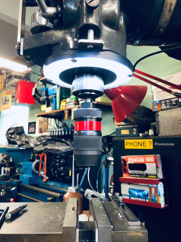

  • I took some 1/4 Lexan and cut 2 big washers. Then I treppaned a groove equally in each that fit one of those headlight halo rings, with a groove for the wire cut in one. I painted the top one black and put aluminum tape on the joining face. Assembled it with 4 self tapping screws and then fixed a bracket to mount in the indicator boss. Right now it’s wrapped in black electrical tape as I decide on a final finish. It’s powered by an old Epson 12 volt printer power supply.

        Outstanding job!

          nice work Tim! If you make the bit surrounding the light (covered with black tape) reflective on the inside, you'll get a bit more light out too.
          Quick Q - I'm very interested in your vise stop, I've never seen one that uses a sliding element captured on the top of the fixed jaw. I like the look of that. Any chance you have a pic of the other side, particularly how the 2nd sliding element is captured by the one on the fixed jaw?
            That is intriguing. If you don't want to drill/tap holes in the stationary jaw, you could probably use one or more neodymium bar magnets to affix the adjustable bar to the vise. That should easily give you 5-10lbs of hold or more which I expect would be enough for a non-heavy duty stop.
            Edit: Brain fart... That would also be a horrible swarf collector being so close to the action.

            • Thanks for the comments...
              The vice stop slide and pivot use flange nuts to hold things in place. The bolt on the pivot is threaded in tight so I can just loosen the 3 flange nuts to move things. The pin is harder than the shcs so I don’t get divits from that if I have to move it.
              Light from the new quill ring helped in these pics.

              • Nice looking light but unless there's oil dripping off of it, your spindle bearings are dry. I keep a coffee can lid under my spindle to catch the drips.
                • very neat, thanks Tim. Beautifully illuminated too

                    Do you keep anything else under the head to prevent it from crashing into the table again? I think those are tears dripping from your spindle, not oil
