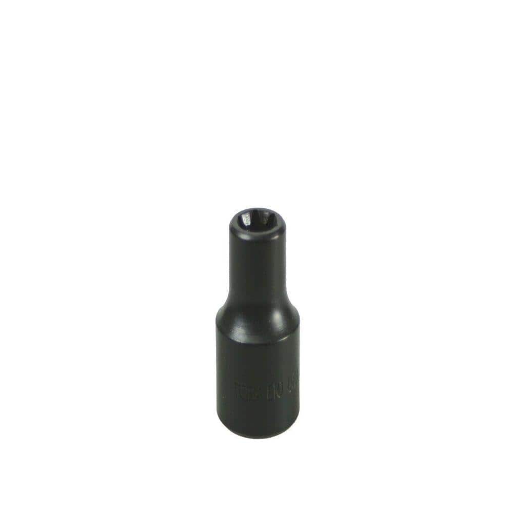

    So I guess I'll just have to get some seats from a junk yard or find some on CL or FB Marketplace. Unless I can find the proper tool to remove that bolt. Apparently a Torx E10 socket:
    Not in stock at Home Depot:
    E10 external bit socket with a 3/8 in. drive. Female torx bit socket. The black oxide finish resists against rust and corrosion.
    But this set is in stock, for $25:
    Husky External Torx Sockets are specially designed to be used with Torx style fasteners commonly found on motorcycles, import vehicles, disc breaks, and electronics. This set contains 13 different sizes
    I might buy it and see if it will loosen that pesky bolt. If not, I can return it. Or even if it does. It might be a handy set to have, although I wonder if I'd ever need it for anything else.

    • Ford is using those fasteners a lot these days.
      • An angle grinder works great for those.
        Keep a bucket of water nearby.
        Edited to add: An E Torx or external Torx socket set is handy to have though, all kidding aside. Since buying a set 3 or 4 years ago I have been seeing a lot of them.

        • I typically use the normal 8 point sockets for those.

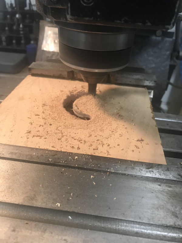

          • Trial cut on wood then cut the hole for bearing holder on bread slicer
            • I bought the Torx external socket set, and it worked. I had tried a six point socket on the first bolt but it started to slip. The guy who was going to buy the car texted me that he could not come today, so hopefully tomorrow I'll get this white albatross out of my life. Otherwise I'll just call one of the junkyards that I had contacted before.

                • Fit eccentric holder then weld, pressed in crank and bearings, clamp in frame and weld.
                  A bit more finish work and some reinforcement and it should be set to slice for another 30 yrs.

                      • Hey, Plaz, That's a good looking repair!

                          • thx tim, I just dabble, not like some of the pros here but appreciate the kudos
