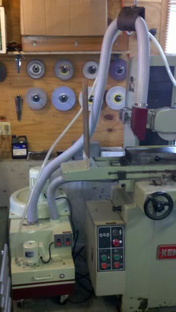

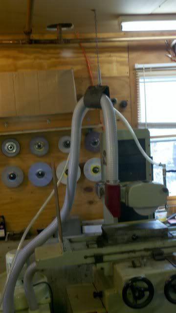

  • Installed the hose hanger that my dad made for the new surface grinder coolant/dust collector unit I bought for him. Every one of these units I've seen being sold with used machines on Ebay or by machinery dealer sites has cracked hoses from people just letting everything hang. This solution that I thought of, dad fabricated and I installed takes all the weight off the hoses, without exerting any forces on anything else. It's a neoprene rubber sling suspended on a coil spring-loaded mechanism that was a door-closer, and fastened to a joist in the ceiling above the machine.
    Also laid out and installed new "pegs" to organize the growing collections of grinder wheels & adapters. I used the long screws and plastic spacers sold for installing rain gutters on homes. They're long enough that I can start stacking wheels 2 or 3 deep if I need to. I still have room for a few more before that happens though.

    • Pixman: curious, is there any ever issue with the use of flex hose in such an "industrial" setting?
      Build up of crud after awhile, I mean...
      • I've not seen it used much in similar applications, only the photos of the stuff. I think coolant mist has more effect than crud alone.
        When I worked in CNC screw machine shops that had high-pressure coolant systems and the accompanying mist collectors, the oil mist really attacked the 6" flex hose used on the mist collectors. It would swell up and split. A more-common issue was the oil collecting inside the hose, impossible to get it all out. That weight alone would make the flex hoses sag. I don't want that here, that's why you see the smooth curves, no sags. Then on the CNC machines, the mist collectors started to be installed directly onto the machine enclosures, problem solved.
        I do see some flex hose being used in shops that have central dust/mist collector systems. There will be galvanized pipe run along a line of machines above head height, then flex hose down to the interface of each machine. It all seems to be intact, but a bugger to keep perfectly clean. Most don't bother, and I think that's when you get a lot of leaks and system failure.
        For right now, being brandy new, this thing really sucks. I think I'd be careful about having a loose grip on a flexible 6" scale near the port, it sucks so bad.
