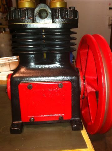

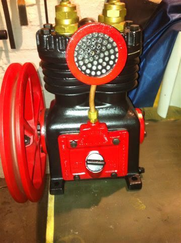

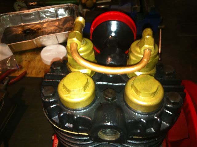

      After 4 months of on and off work on my dads Devilbiss compressor finally completed the pump on Sunday.
      I don't have pics of what the whole thing used to look like but the head used to look like this.
      Now after stripping sandblasting the entire thing at times that I would not urk my neighbours the pumps looks like this.
      The interesting thing is only one valve plate was broken but I replaced the bearings, bearing seals and gaskets while it was open anyway.
      Also honed the cylinders and sprayed the entire pump.
      All in all I'm one happy camper.
      Now I have to do the motor and tank .......not that much fun

              Wow, Awsome hotrod compressor paint job Hope it proforms as fast as it looks.

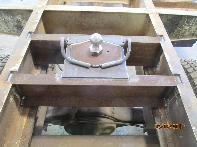

                    • I'm in the process of replacing the wood deck on a stake body truck with a steel tread plate deck. At the end of last quarter, I stripped off all the angle around the edge of the bed, and removed the bulkhead that supported the blade for the bulldozer that the truck had been used to haul.
                      Then I installed two channels and the plate for the hitch ball.

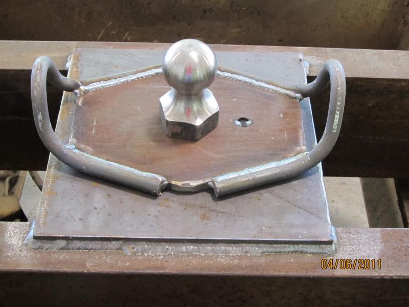

                      This morning I fabricated this removable mount for the safety chains.

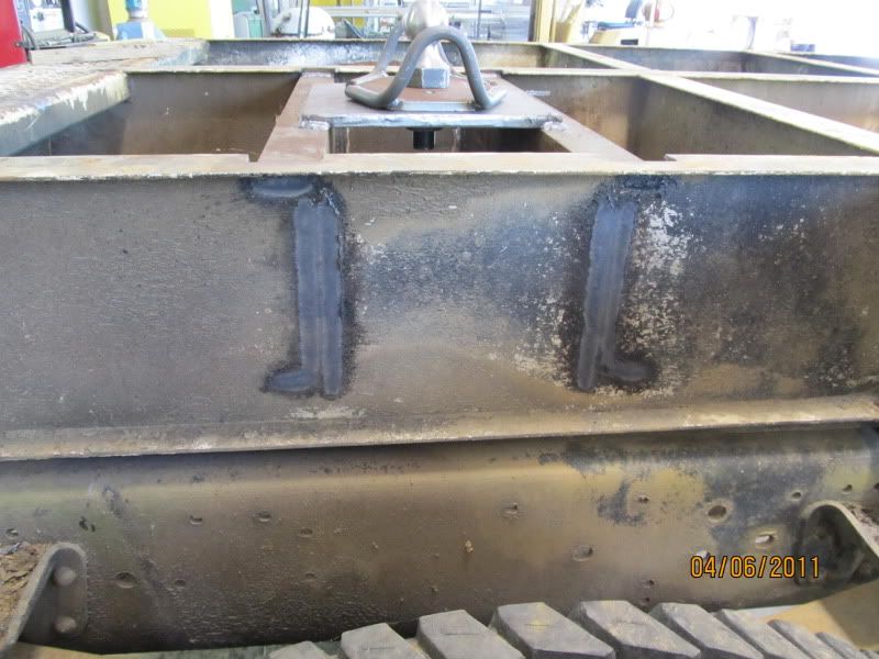

                      Here's a shot showing the paint burned off the outside of the frame where I welded the channels. I was pleased to see the pattern is so consistent. It wasn't an easy place to work with the mig gun.
