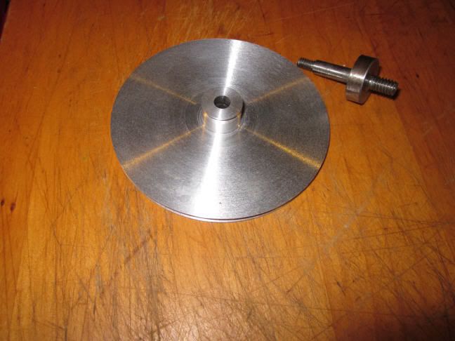

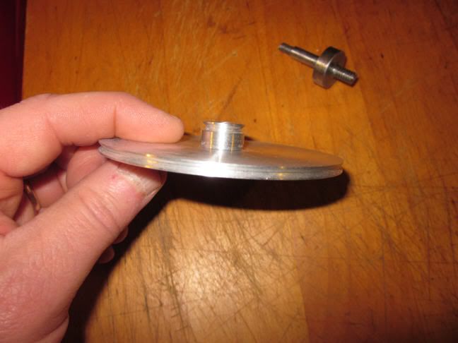

    • Made 2 of these pulleys for a test fixture at work , finished very early today, so they count as what I did "today". also made the idler stud, went to work, put them together on the fixture, and found out that the programmer wasn't ready to use this "rush-rush" fixture that we needed right away because the client wants this feature in the code super ASAP.....
      In case you ask, no I could NOT find them in sizes wanted at Berg, Stock drive, or Small parts...., nor at Boston Gear. For 2mm round urethane belting, and a special new ratio that we needed to emulate on the fixture.

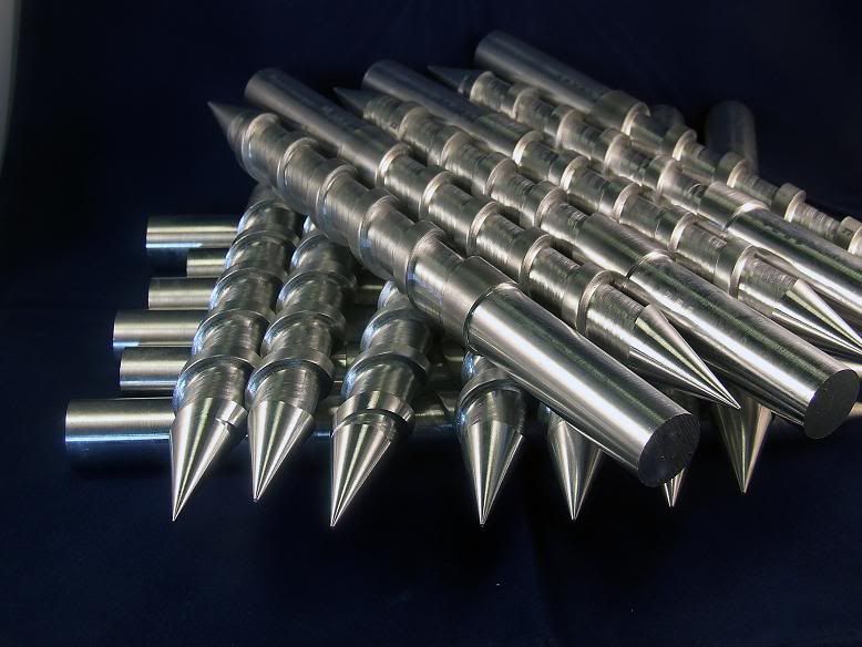

                        • Well today, I finally managed to remember to bring the camera to work,
                          just finished these spikes up, they fit into the end of some aluminium tube,
                          which is then screwed into the ground over which a flag pole sits.
                          25 of them in total (not all pictured).
                          Bit of a rush as they are being taken up to london by the customer for flags
                          at a certain wedding thats coming up.
                          They are 1 inch aluminium bar, the "thread" is 20mm (approx) wide, and on a 28mm
                          pitch takes 7 minutes to make each one, not too bad for a 20 odd year old cnc.
