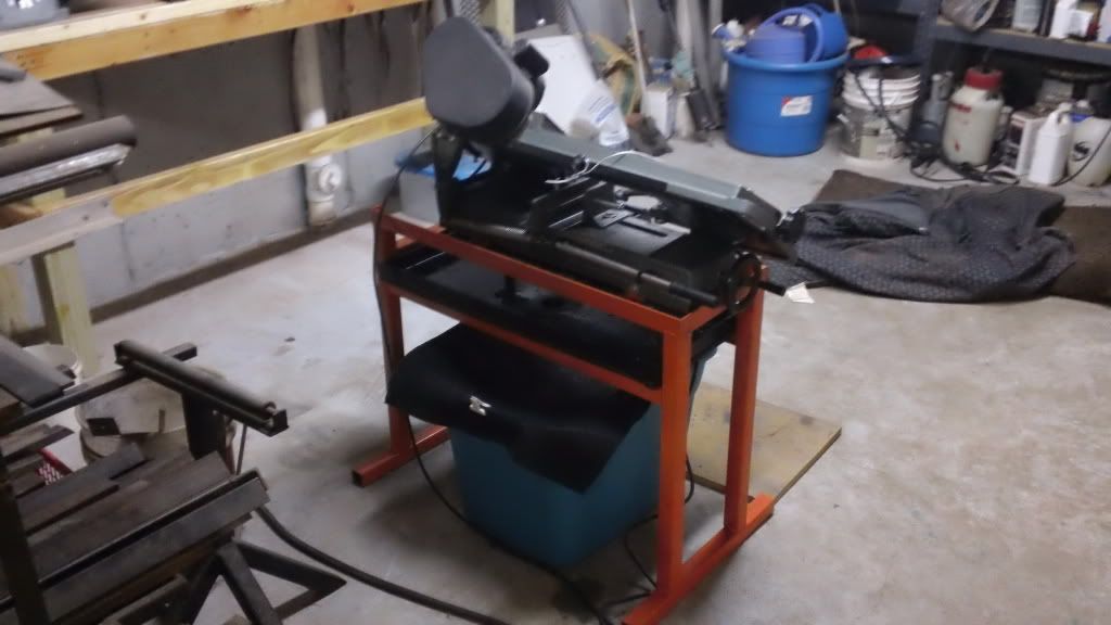

      • 4x6 bandsaw stand
        I made this two weeks ago before my real job called on me. Been meaning to replace the flimsy stand for years. Added flood coolant, since I fabricate plastics for a living, I went ahead and welded up a HDPE catch tray. Only thing left is a matching tank, but I hate doing work related stuff at home.[IMG][/IMG]

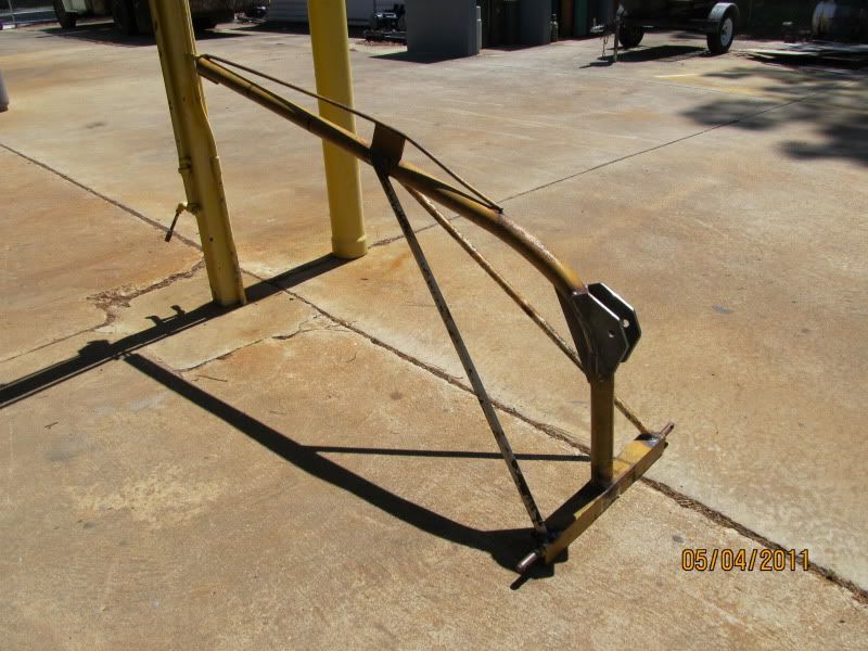

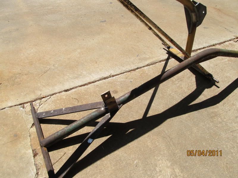

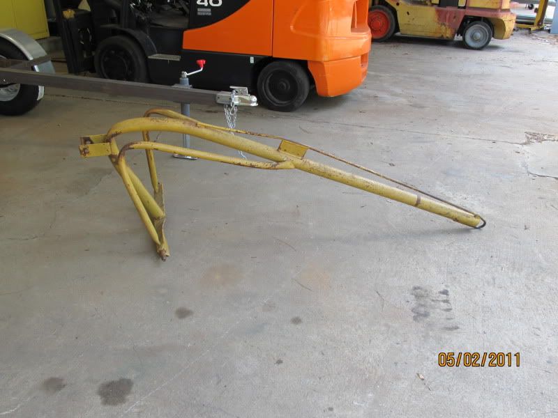

        • This mangled boom pole came in Monday afternoon.
          And it was ready to leave this afternoon.
          We even reused the upper link attach plates to fix the fellows other boom pole.

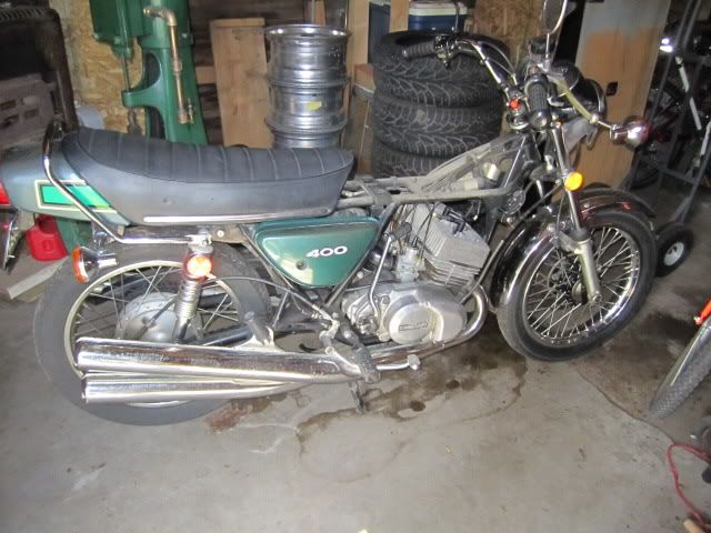

                  • Got the carbs off this bike, taken apart, and in the cleaning tank.

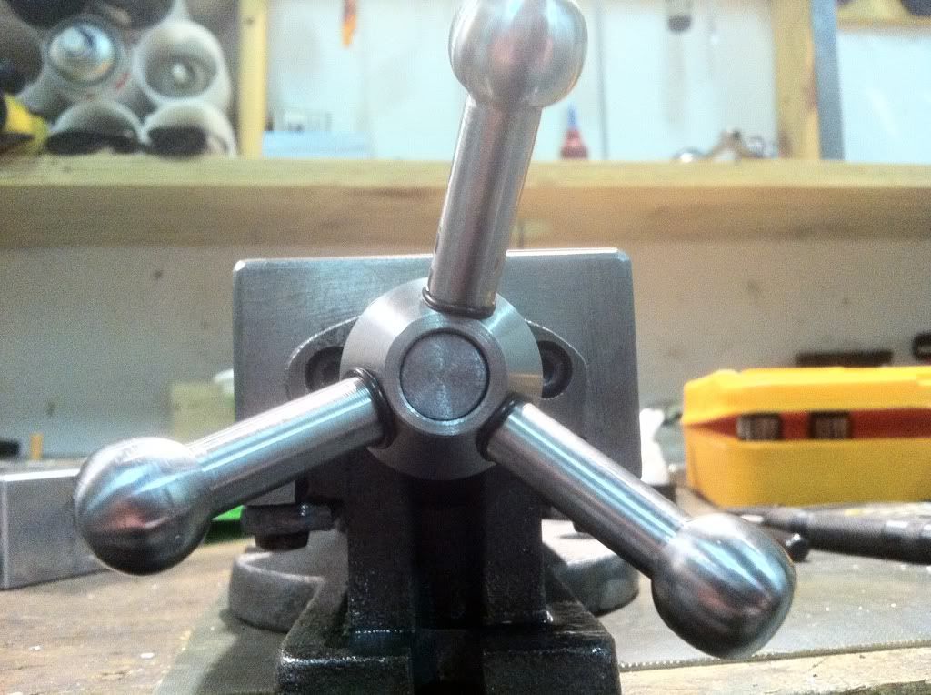

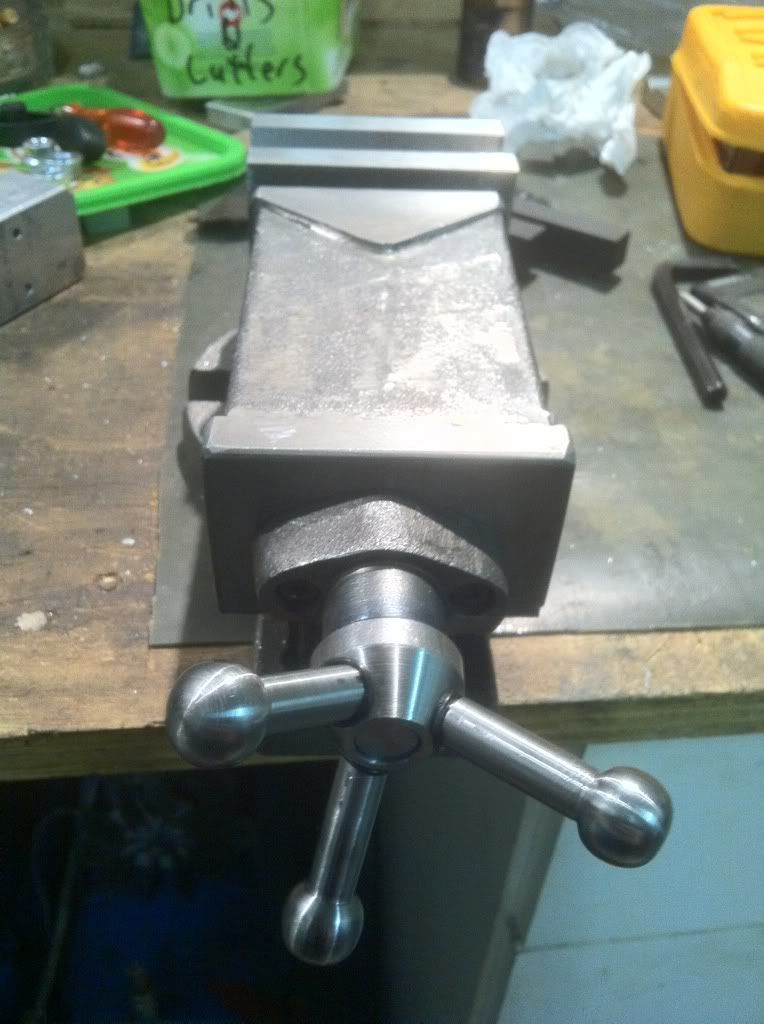

                    • Finally made a speed handle for my little milling vise.
                      This has been bugging me for 2 years.
                      The o rings are to cover the slit I cut for thread clearance on the tips, did not want to end up with a loose fit on the shaft.
                      It's not perfect but it will do and is way better than it was when I got it.
                      The balls were made by file so they are not exactly the same but you have to really take hard look to see the differance.
                      You can always just EDM it...

                        How about some information on the steam engine in the back of the photo.

                          I've posted a picture of that before here. It's an O&S. Came out of one the silver mines in northern Idaho most likely. It stands about 4ft tall. It was on display at the local fair grounds for years until they moved the display to a new location. I've had it running on compressed air. It belongs to the same person that owns the bike. He likes to collect stuff like this and he brings it to me to get work done on it.

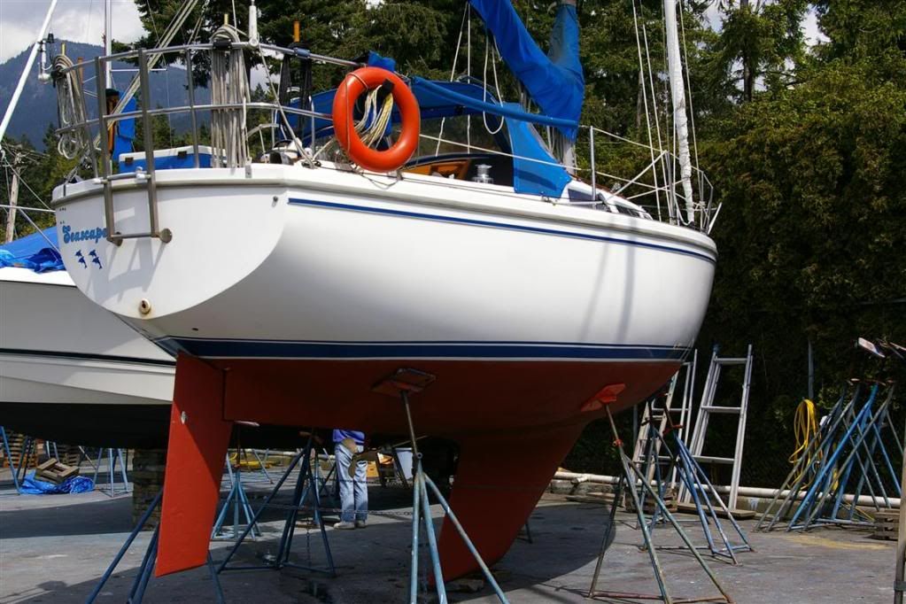

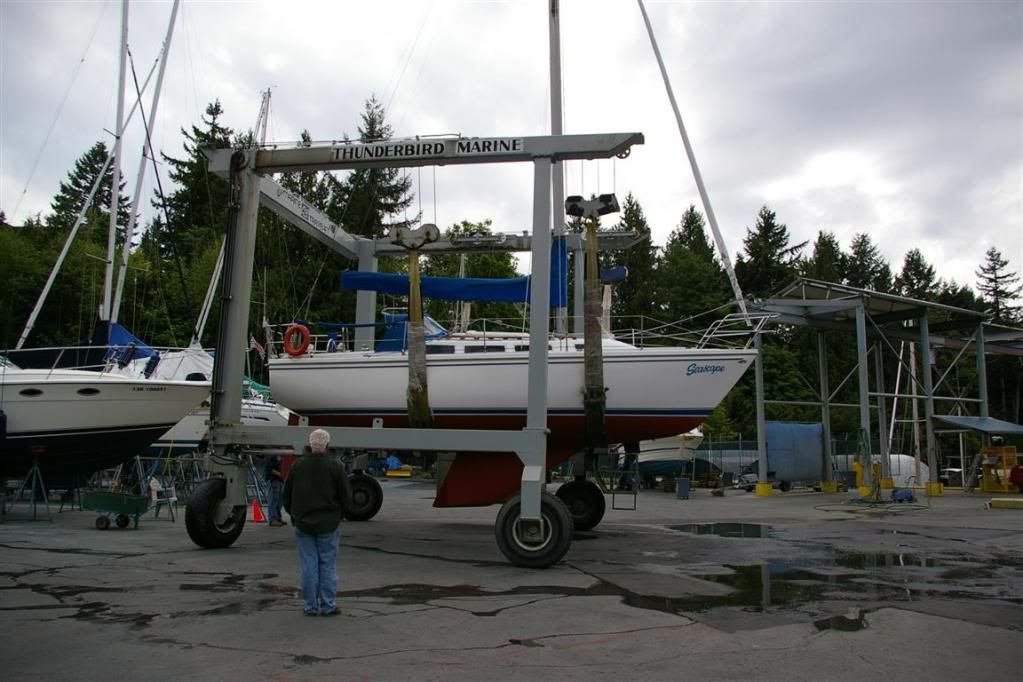

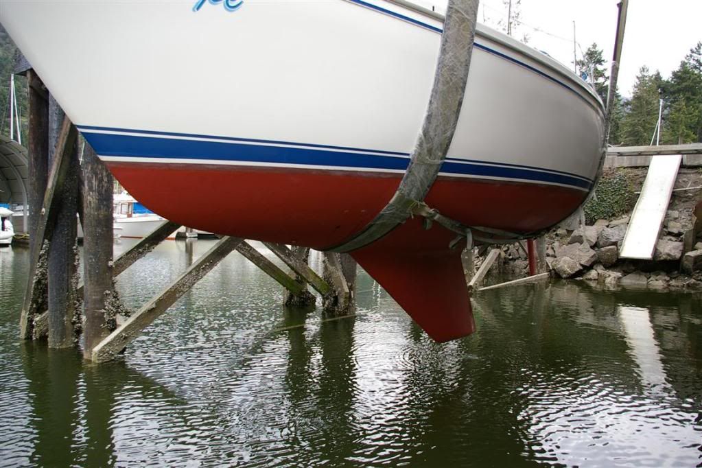

                            • Hauled the boat out for bottom painting and hull waxing. For 26 years I have hauled in the second week of May and never been rained out. Sure came close to it this time though.

                              • Wow Nice Boat
                                Wheres the Motor? What if theres no wind?. I just wondered ? I think they (called sailors ,,,,I dont know any..!!!) call it being Becalmed? Funny thing on my Boat certificate test I had the sailboat test yet ?? never ever captained one or was in one. We (IN Canada) all need a Boaters exam to operate Water Craft. More Government holding our c.... for us .Later Mike
