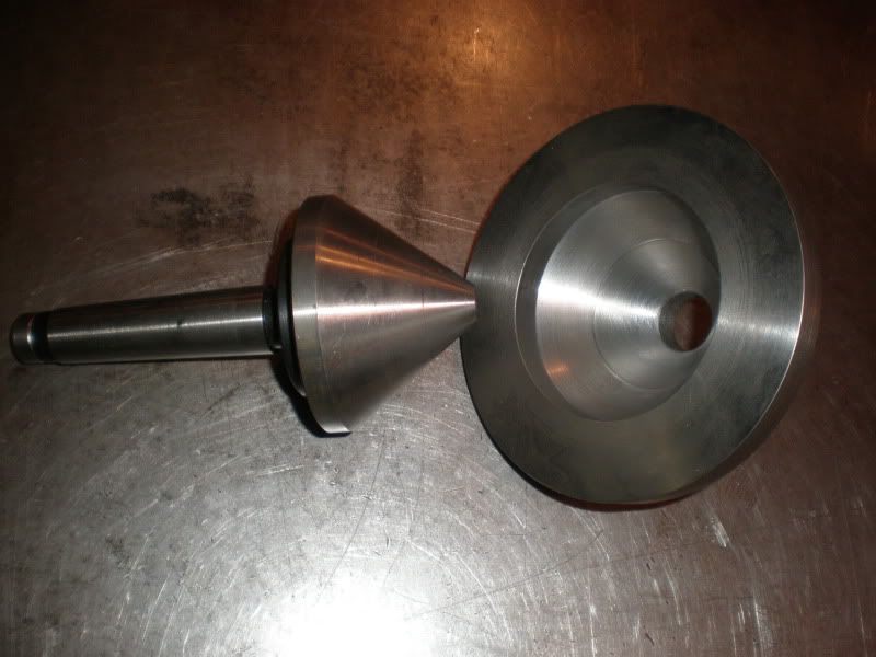

        • Bullnose adapter
          Yesterday I had to have a larger bullnose live center so I had to do what I have put off for years. I used a chunk of 1045 and machined all surfaces in one chucking. That was the only way I had to get all surfaces concentric. It was time consuming and a bit of a bugger and it took about 6 hours.
          The inner taper has a relieved area half the length of the taper so only the front end of the taper aligns with the bullnose center. That makes the press fit ID align with the OD of the bullnose and the end of the bullnose align with the outer end of the adapter to eliminate any possible mismatch.

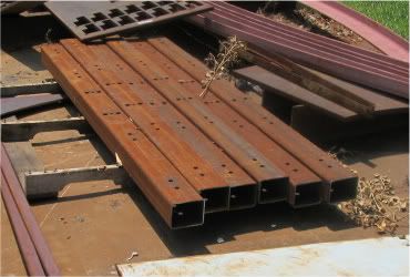

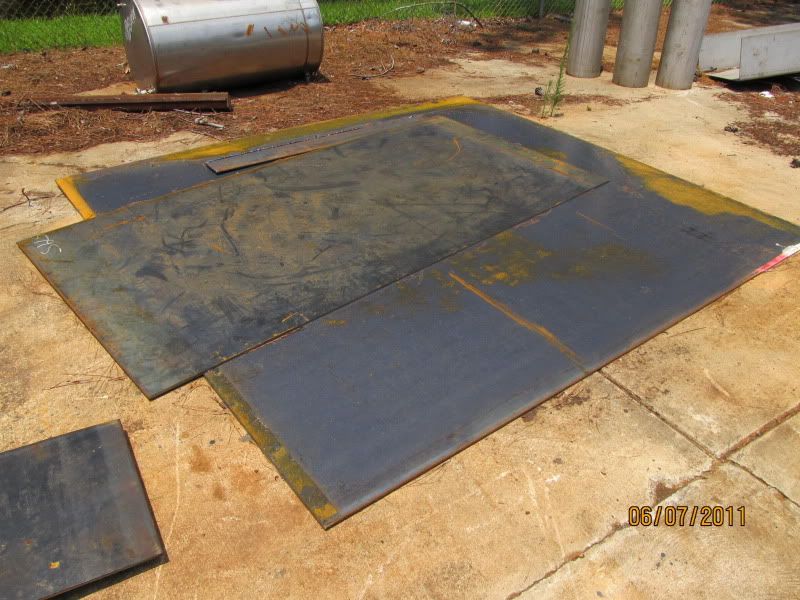

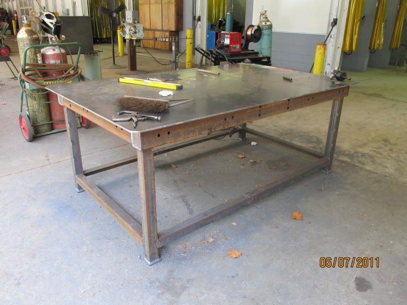

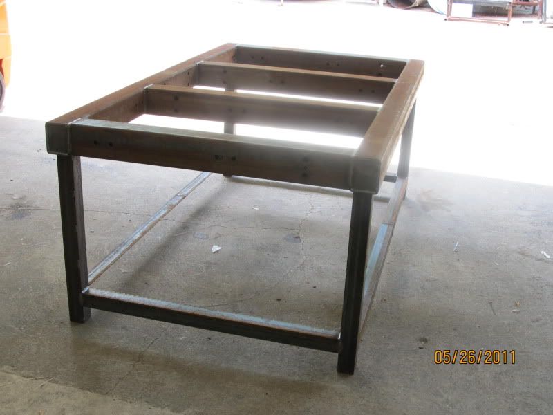

              • Adding up scrap:
                Some of this
                and this
                equals this
                and adding some of this
                • gives you this
                  Everything came as scrap from a local shop. The holes had been incorrectly placed in the 4"x5"x3/16" tubing. The 2 1/2"x3/16" angles had been cut to the wrong length. The 3/8" super-flat plate leftovers weren't large enough for the jobs they had planned in the near future.
                  Now we have a 80"x56" fabrication table that's really flat and sturdy.

                        • Originally posted by winchman
                          gives you this
                          Winchman,
                          Nice job on the fab table. What is all of that flat stuff arount the legs? Is that what is known as floor space. Gotta get some more of that.

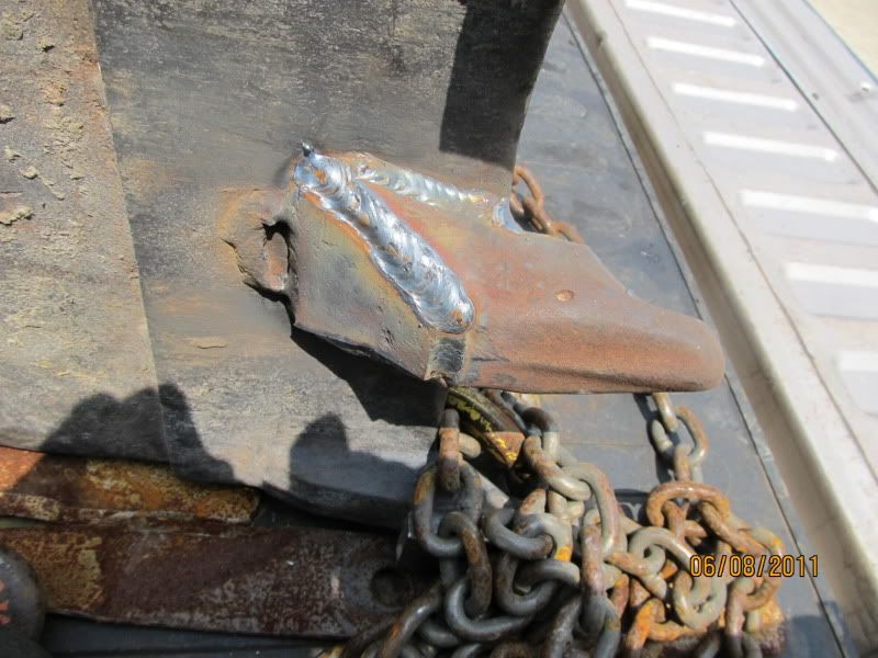

                          • A fellow brought in this old backhoe bucket the other day.
                            One tooth was completely missing, one bushing was gone, and he needed a new pin to mount in on the hoe arm.
                            We had some old teeth foff a trackhoe, and I cut one of them down to sorta fit as a replacement. Two pieces of scrap plate filled in the voids.
                            I machined a new bushing from a large brass nut which I had lengthened by adding brazing filler rod to one end. The pin itself was amde from scrap tooling shafts. The washer on the end that's bolted in place has a dowel to keep it from turning and loosening the nut.
