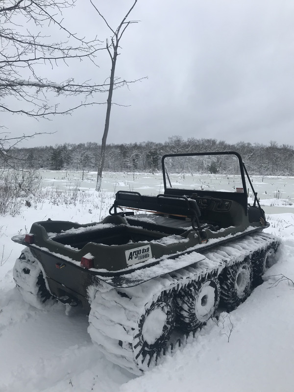

                          • Got a bit more snow. Bit much for the 3 wheelers but fun for the Argo. The new (utv) Jeep also had a workout. (Yes I know it is March and the Xmas lights are still up!)
                            • "You see Dear? I TOLD you we needed to buy an Argo!" Am I right?
                              Substitute "Argo" with Lathe/Mill/Mitre Saw/Surface Grinder/Shaper as appropriate
                              • Argo's are a lot of fun. My Uncle had a 6x6 when we were growing up. You wont get there fast, but you'll get there for sure. Almost bought it off him a couple years ago when we bought our place, and kind of wish I did. It needed a bit of work to get going again, and I didn't want another project at the time. Plus I'd rather have an 8x8 anyway. Great for ice fishing.
