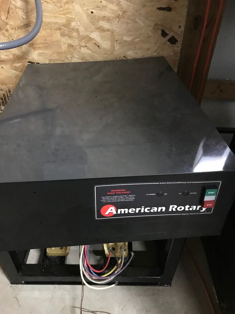

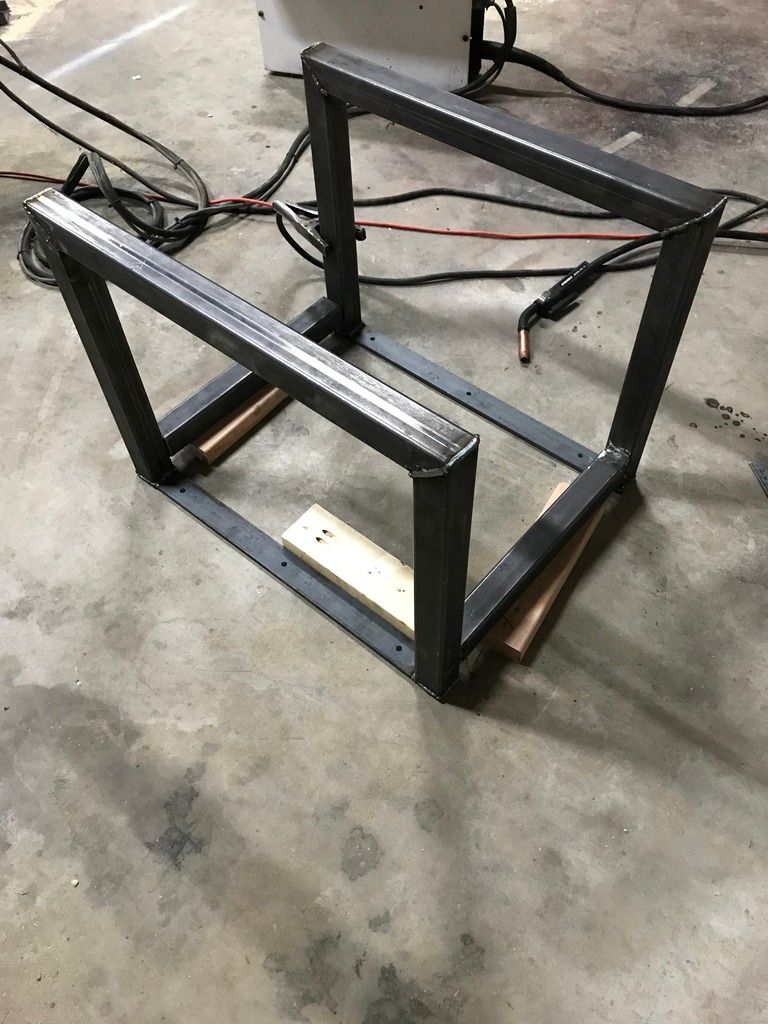

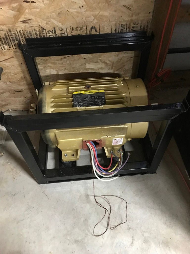

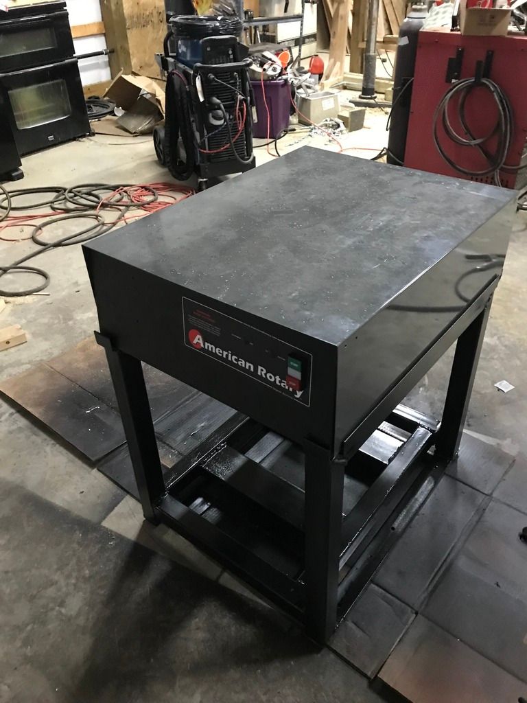

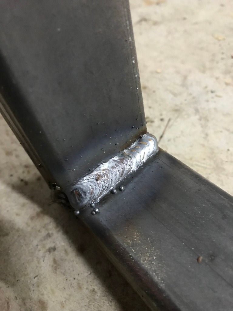

                              • I was gathering parts for some time and trying to get the shop ready for some heavy fabrication. After running 400amp service to the shop the next stage was to adapt to three-phase. I found a brand new Baldor 40hp motor in Alabama from an EBay auction for cheap because of a missing fan shroud and a cracked cooling fin, probably damaged in shipping. It spins nice and easy and i see trashed three-phase motors littered all over around the quarries I haul in and out of so it's just a matter of time before I find a fan shroud. Another piece was when an extremely donation was made to the cause in the form of an old American Rotary 40hp control panel was given to me by an extremely generous individual. So the next step was to weld together a cradle to marry the control panel to the Baldor motor.
                                I really hate this Snap-On/CK MIG-welder. I can't get the settings right so it burns in right without popping. I really miss my old Millermatic 252.

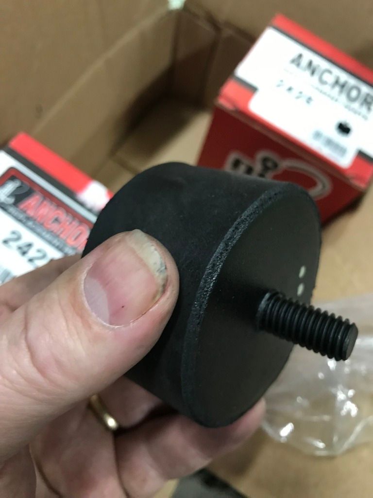

                                Next was a trip to the local auto parts store to find rubber isolators in the form of motor mounts. It pays to know where the old-timer auto parts store is where they have patient old dudes with books instead of a kid that's lost when you can't give him a year and model of car to type into his computer.

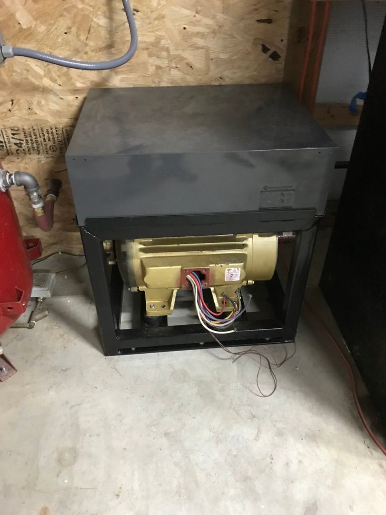

                                With the isolators bolted into the cradle, the cradle bolted to the floor and the motor bolted to the isolators, what's left now is to wire this all up.
